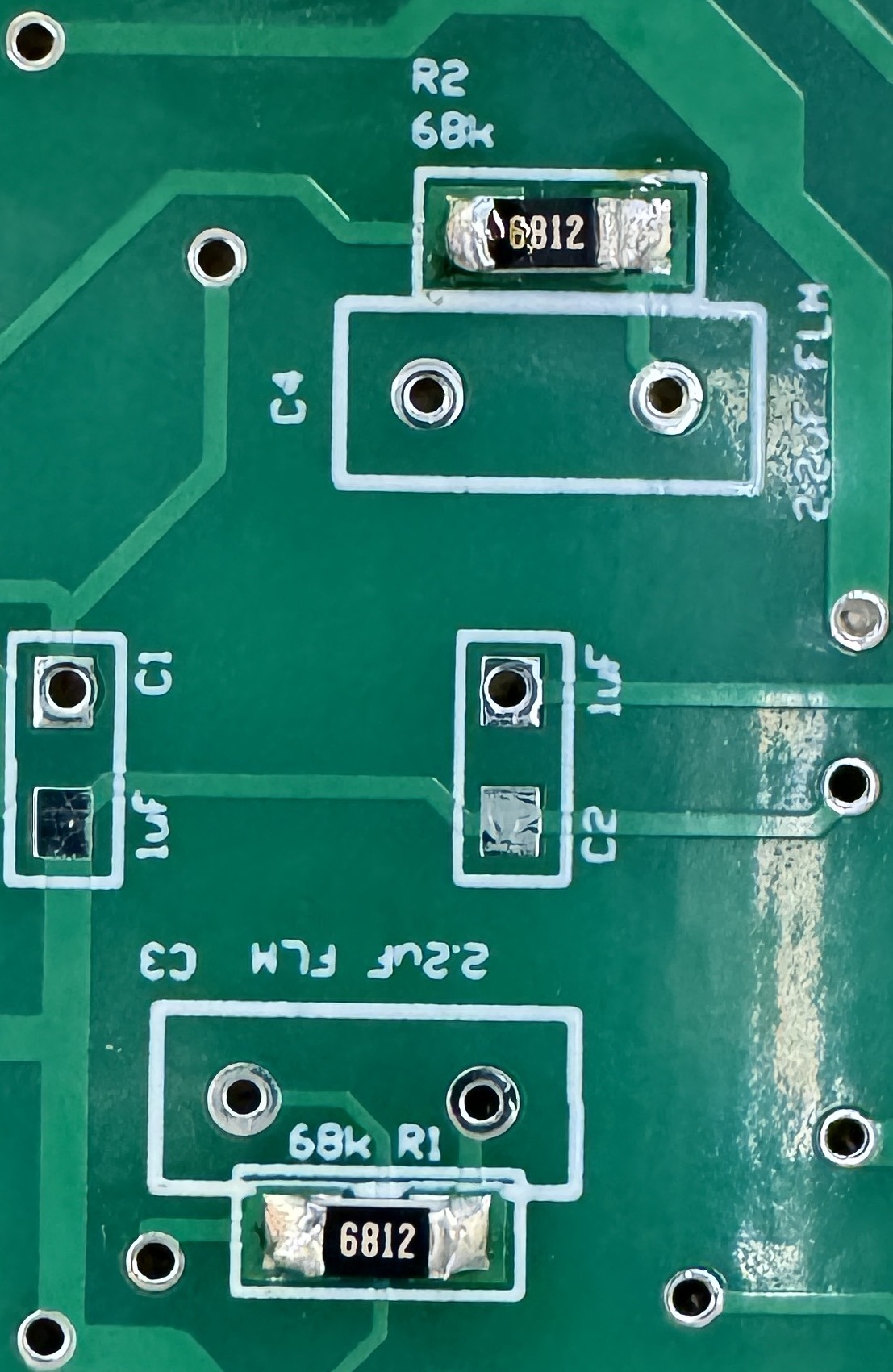

I started construction today and immediately encountered a discrepancy between the bill of materials and reality. I followed the description and values of the components on the motherboard.
1. Part numbers do not match the description. The 68K resistor is listed as R3, R4 in the BOM... but it's actually R1, R2, R3, R4... There are a lot of mistakes and I recommend sticking to the description on the motherboard.
2. The parts list is missing parts. For example, resistors 120R, 110K, 150K...
There will probably be more, but I'm done with the job right now and I need to do a component check...

Here I give an example. This is BOM 2023.
The first resistors and immediately the error...
Why is this a huge problem? I specified 68k but called up 68.1k in the BOM because at the time Mouser had very large stocks and it was cheaper than a standard 1% 68k resistor. 68.1k vs 68k is a 0.147% shift in value and well within the 1% tolerance of the 68k device.
Rather than claim the BOM is wrong, let me know what your issues are and I can explain the reason, or, an explanatory note can be added to the BOM. I'm not claiming the BOM is perfect, but most of the issues were cleared about 2 or 3 weeks after publication when I checked it line by line for accuracy and consistency with the schematic. A BOM is always a living document because products from manufacturers change, availability goes up and down etc so it does require massaging from time to time to stay current.

Apologies - I see your problem!
I really don't know how this has happened. Leave it with me and I will fix it in the next day or so. Again, I apologise for this and cannot explain how this happened - the part references in the BOM you have bear no relationship to the board.
