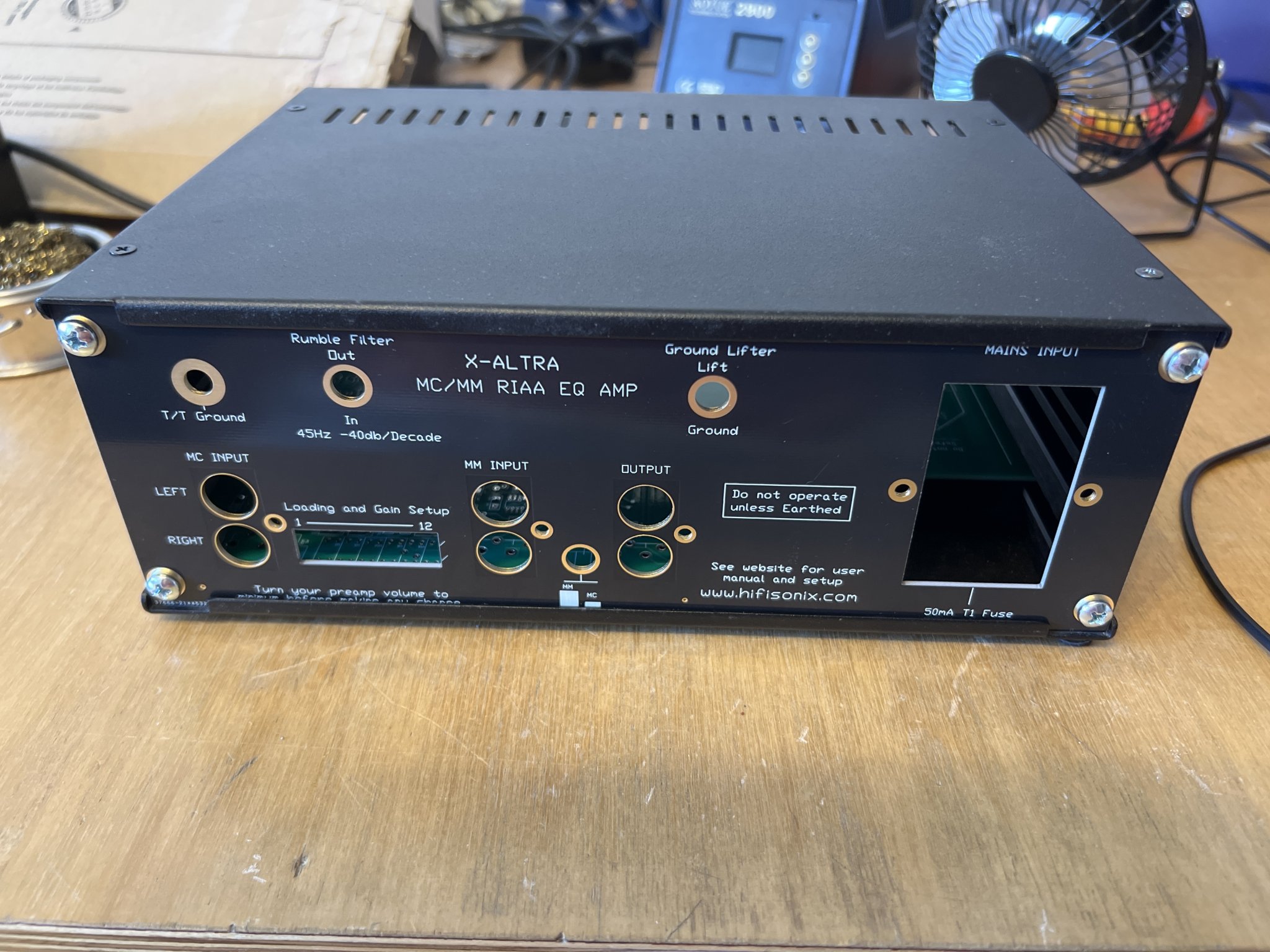

I had an old modushop case from another project which will only need a new front Panel. Is
there any advantage of using all aluminum panels instead of these painted iron ones?
Front panel might be wood (with aluminum foil on the inside for screening.)
Manuel, you can use the iron cover chassis without problems. I have not tried the X-Altra MC/MM without a thick aluminium front panel. A foil screen will only provide RF screening and will not provide any protection from radiated mains noise ingress. In a correctly wired up X-Altra MC/MM preamp with a DL103 MC connected there must be zero hum from the speakers with your ear against the speaker cone and that’s what you should aim for with your build.
So, I would try it with your proposed wooden front plate and foil screen but be prepared to move to a thick front plate if you get a problem.

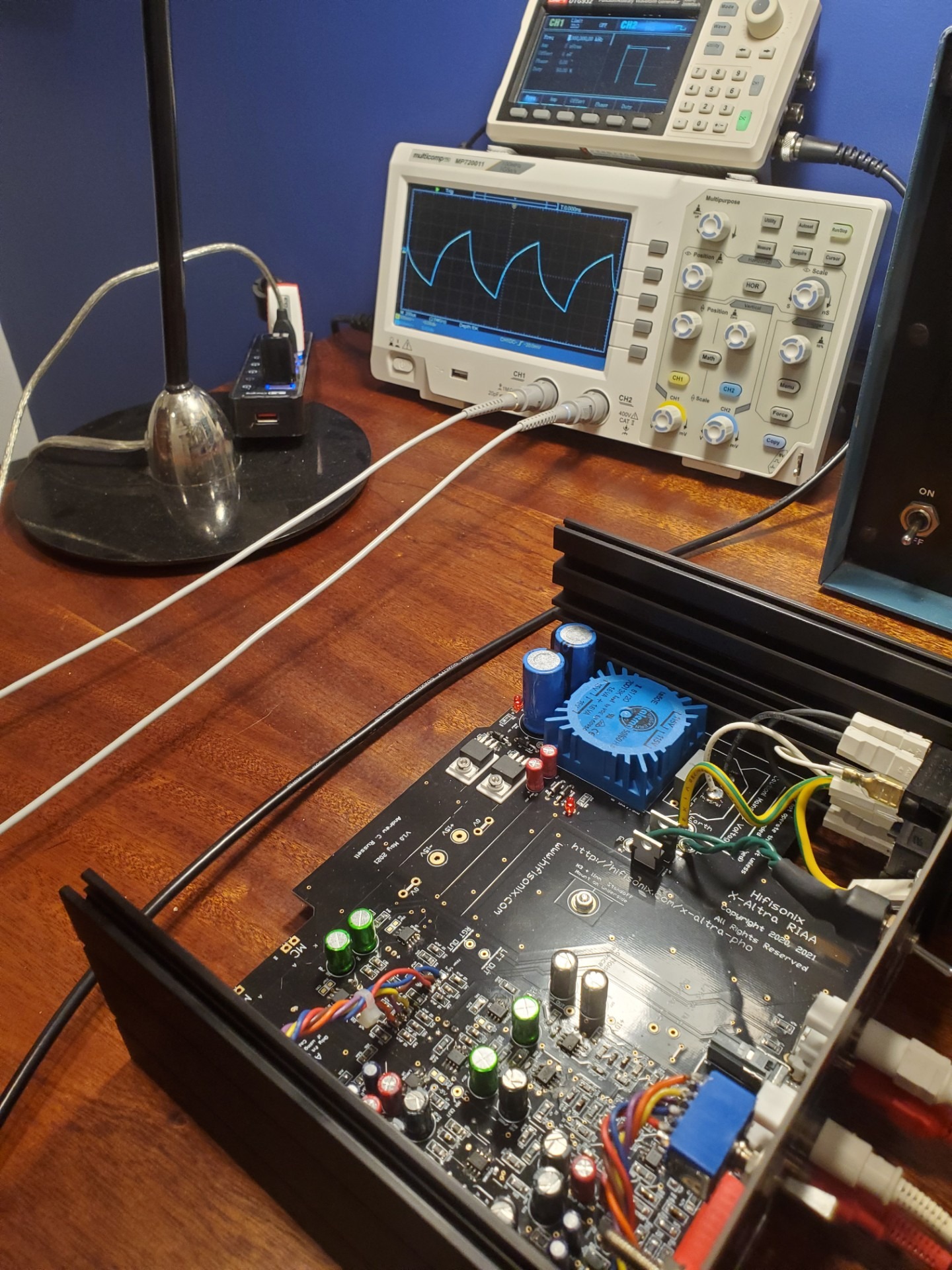

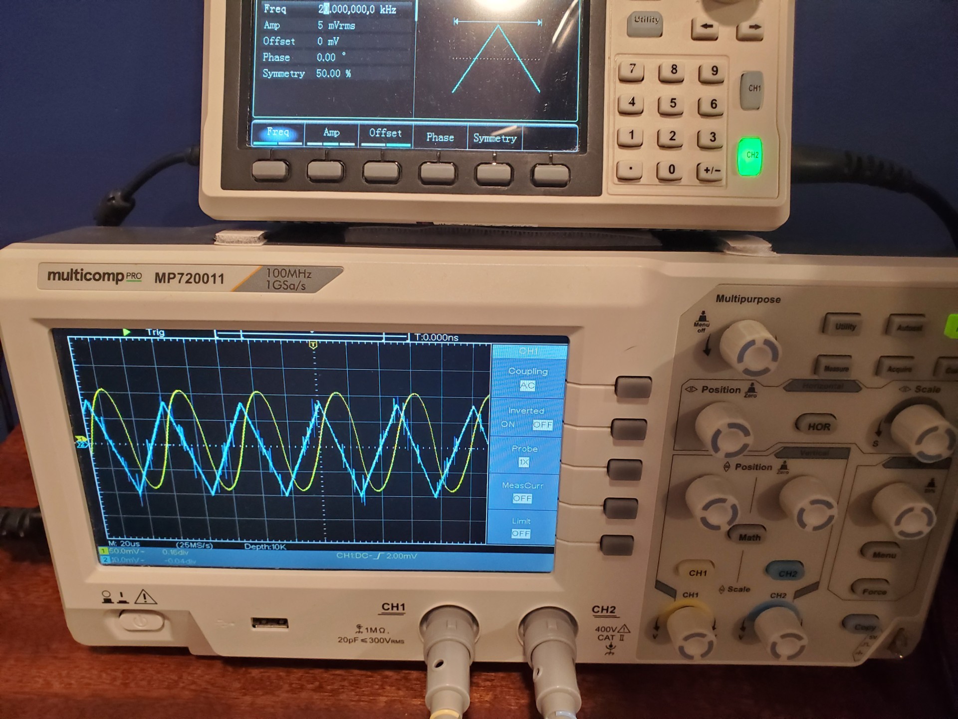

Thanks Bonsai! Square wave 👍
It looks good. My 100khz square wave is more triangle than what you show but I assume that isn't an issue. The others are identical.
I have 2 units working.
Two things to note with final testing.
1) Both units have 50 and 80mv dc offset at MC input(at phono plugs) before DC servo is connected. When servo is connected I get +/- 0.1mv at 60 sec. Stable from there.
2) Both units, the collectors of Q1-Q4 measure 1.5v wrt 0. should be 2-3V. I checked all resistor values from pin 1 and 7 of U3 and U4 back to Q1-Q4 and they look and measure proper.. Q1-4 are not matched..

Just check the waveform with the rumble filter switch in both positions. The test was a quick way to check the preamp functionality. I will try to get around to documenting it a bit better in the next week or so.Thanks Bonsai! Square wave 👍
Your voltages are ok for unmatched input devices. I have come to realise the +-20~30mV offset without the servo engaged was perhaps a bit optimistic as quite a few builders have recorded higher voltages. however, the servo will do a good job of nulling these out. As noted in the write-up/supplementary data, the power consumption is very low at about 2W off the mains, so it is ok to leave it powered up permanently, which is how mine is used.
