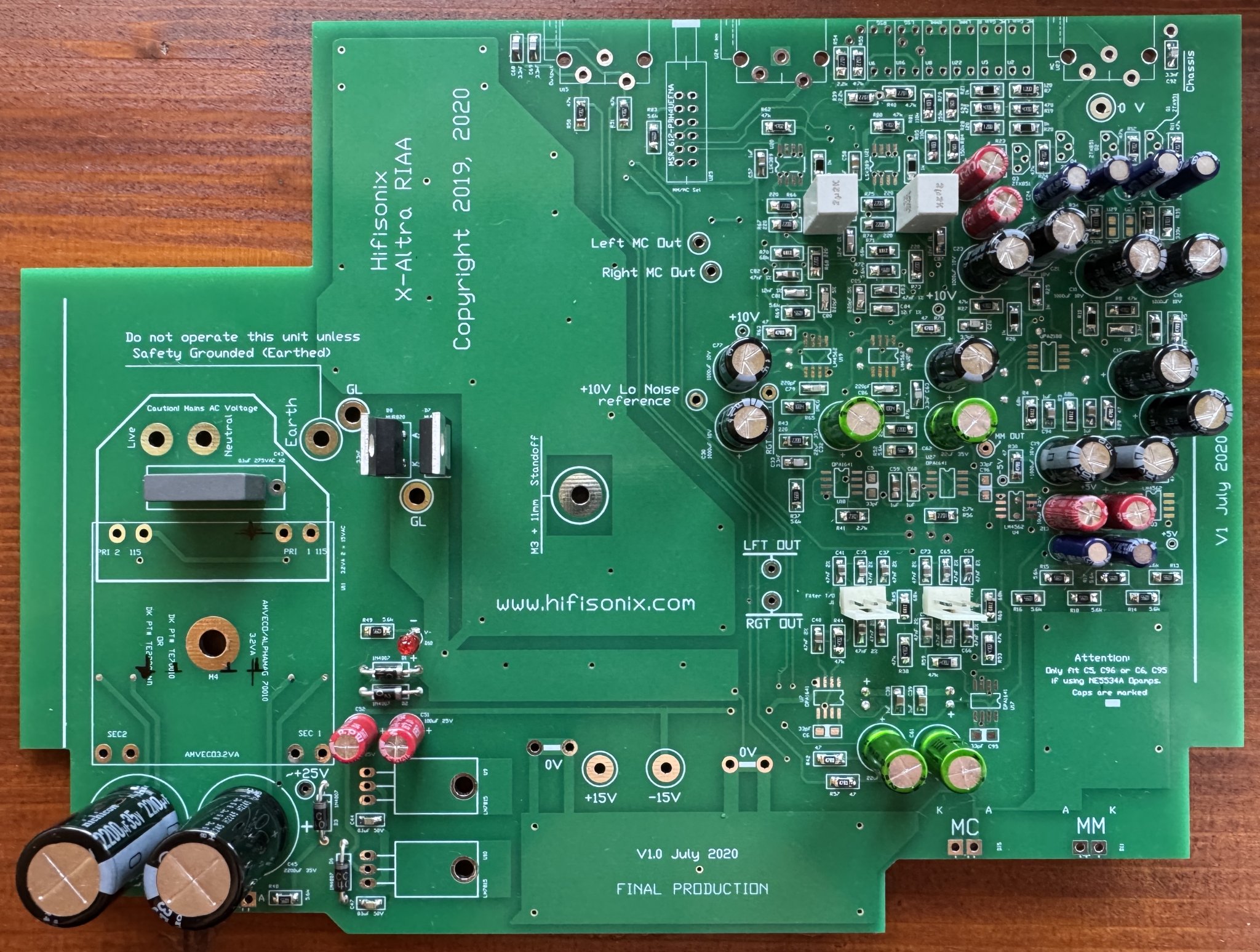

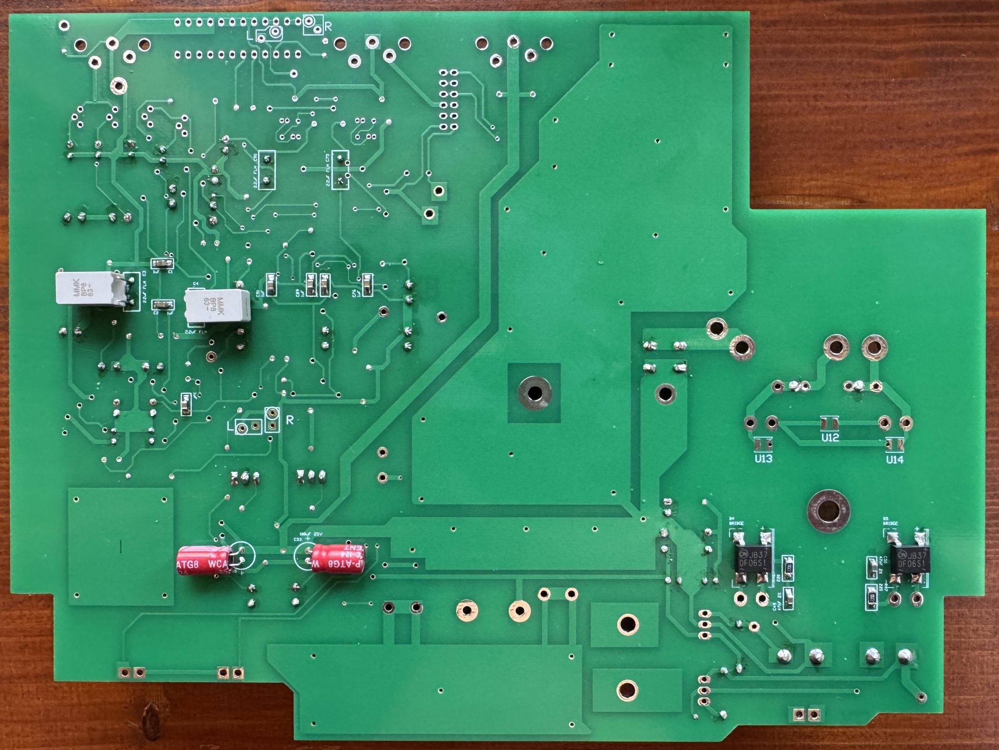

Hi.
Construction continues. Now I'm waiting for the transformer. And then inspection, measurement and complete completion.
Yeah, I still have to buy the box on the Modushop website...
JL
