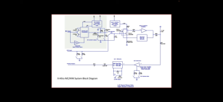

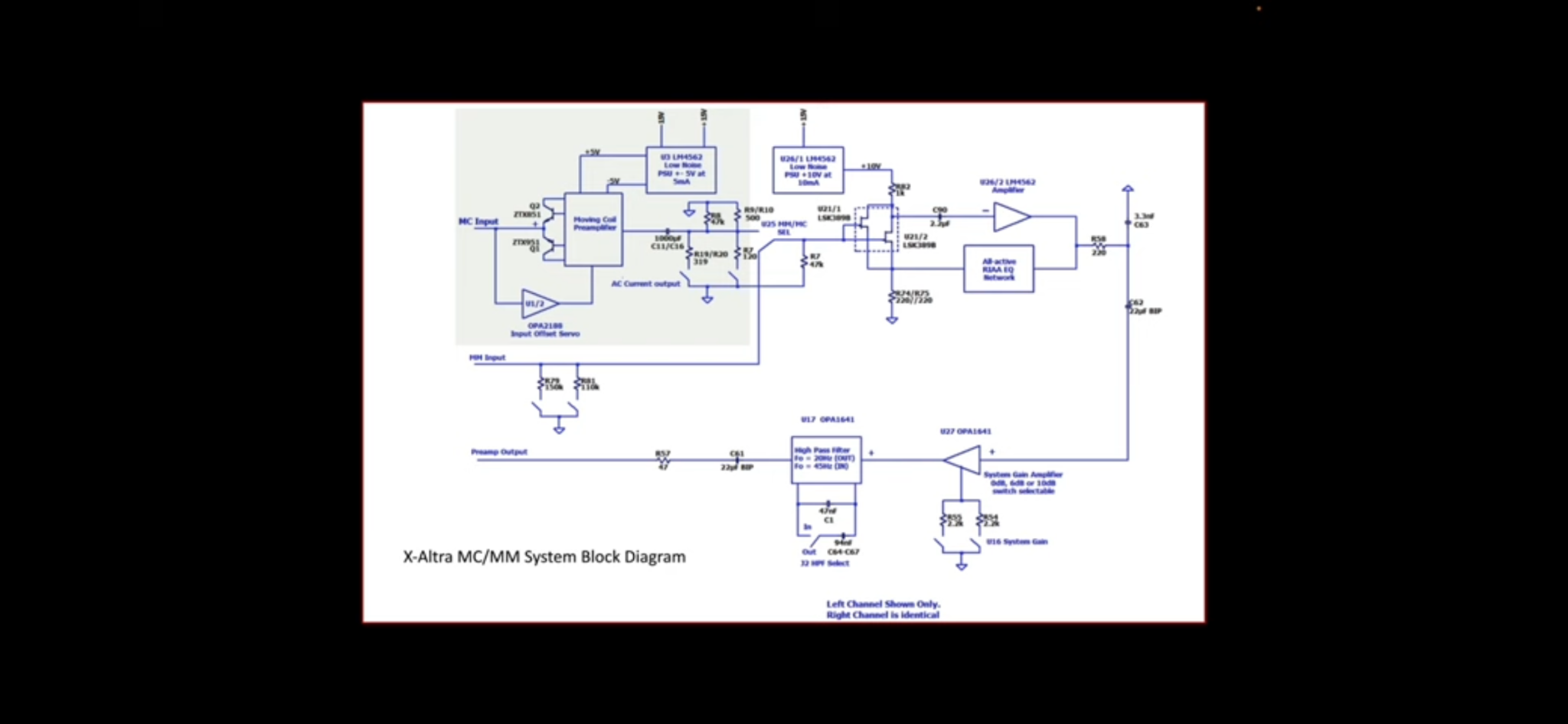

Regarding your video, very interesting and informative however it did raise a question in my non EE mind.
In the circuit diagram shown in the video you have an 100uf capacitor between the mc and mm sections. The complete schematic doesn’t seem to replicate this.
Could you explain this section of the amplifier?
The C11 and c16 1000uF (not 100uf) capacitors.
C11 and C16 couple the complementary output signal from the MC front-end stage to the gain-setting load resistor. They are high in value because the load resistor has to be able to be set to a low value (lowest is 64 Ohms) to cater for high output MC carts and you want the response to be flat down to << 20 Hz. There's about 1.5V DC across each of these capacitors, so it is not possible to directly couple the collectors of the MC front-end stage to the MM input (via the select switch U25) - the alternative here would have been some sort of diff/summing amp that would have seriously affected the noise performance.
Hope this helps!
