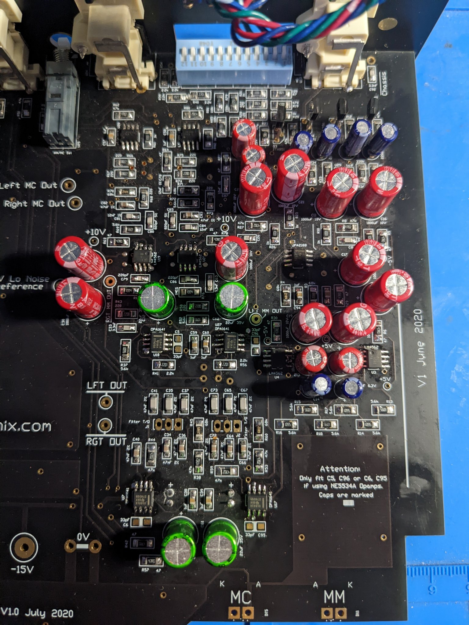

I finally got the right transformer installed and the voltages at the PSU look great for +10V, +25V, and +-15V. Pretty much dead-on.
However, once I installed all ICs, not as good luck. Negative voltages were spot on, but the positive voltages were off.
+5 volt test locations measured -.358v
+10 volt low noise measured -.697v
+10 volt test locations measured -1.744v and -.668v
IIRC, there may already have been prior posts with the same issue, so I'll go back through and locate them when I have a chance to determine if it's incorrect capacitors, resistors, bad solder joints, etc
Check that you do not have a cap the wrong way around - look at the voltages at U3 and U4 pin 6 - should be 5V and the voltage at the junction of R15 and R16 must be 10V. Check that C30 (1000uF 10V) is the right way around - if it is reversed, it will be very leaky and pull the voltage down. Same for C15 (220uF 6.3V).

Here are the installed caps, which appear correct to me. I have v1.0 July 2020 pcb.
R15/R16 junction measures -.697 volts
Pin 6 of U3 and U4 is about -.358 volts.
Quick update - I need to take some time to examine solder joints. One of the other LM4562s had 2 pins with poor contact to the pad. In fact, I was able to lift them off the pads with my tweezers. Tomorrow, I'll reflow all joints on the ICs and then take fresh measurements.
Pretty happy to report that reflowing the solder on the pins of U19 did the trick! 10V test spots are measuring 9.86v and 5V test spots are measuring 4.98v. Proceeding on to the next steps w/fingers crossed.
