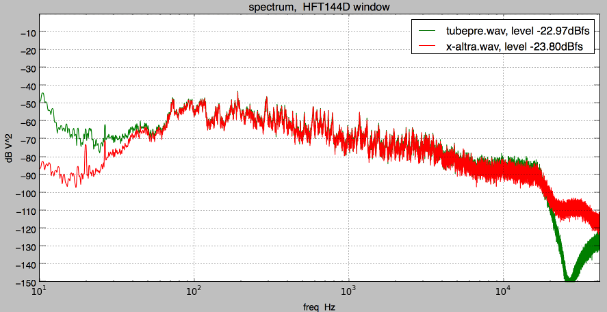

One thing I was interested in with this build is whether I could make out a difference in the sound compared to a tube based preamp. Here's a first test with the same clip from Monk's Criss Cross, DL103 pickup and first through a mostly tube based (E88CC with a SK104 input cascode. Built with kit from puredynamcis.com) and second sample is the X-Altra:
1. TubePre: https://1drv.ms/u/s!Ahn19Qp_SaKQn17VJJkTNI6t8MBk
2. X-Altra: https://1drv.ms/u/s!Ahn19Qp_SaKQpiM7zHTmWwwcTpLa
Recording was made with a behringer UMC204 at 24bit/96kHz and saved to lossless flac to keep the effects of converting to digital as low as possible (given what I have available here)
Well I put those through my Python spectrum analysis code to show the gross freq response and found significant differences in the bass:
(10dB difference by 30Hz, 20dB by 20Hz apparently) - not clear if its just LPF on the X-altra, or some bass boost in the tube version.
Also I'd assume there's no rumble filtering given the upturn around 10Hz in both spectra. There appears to be slight HF peaking with the valve preamp (less loading capacitance?), and the ultrasonic difference is interesting (though this might be an artifact of different digitization options, or perhaps there's a signal transformer in the valve preamp?).
Across the main part of the audio band they match each other suggesting flat responses 70--7kHz or so. I'd worry about the bass difference - it rather suggests the x-altra version simply has the wrong low-pass time constant with the 20dB difference at 20Hz - perhaps a x10 component error?
[ Ah, I found the schematic for the output HP filter - you have it switched to the 45Hz option I think. Its only a 12dB/octave filter so its not great for rumble suppression, but is killing the subbass alas. Its only 12dB/octave so its not great. ]
There is indeed a transformer at the tube preamp's output. It is optional though as I fitted it to solve a ground loop problem that I encountered. But I may have used it while making the test clip. I made that version a few month ago and I must admit that I don't remember which of those outputs I used. I'll redo the recording with the "direct " out.
The TubePre does not implement a rumble filter and no 20Hz time-constant), So there is no attenuation of any of the low end. Having to power 4 double-triodes, it is also bound to have a bit more noise from the power-supply and transformer at 100/50 Hz so that may have some effect as well.
Regarding the HPF, I have not wired up the switch yet and I had assumed it wasn't engaged when not connected, but I may have misread the scematic there.
Update:
There was indeed the transformer enganged in the tube variant. Sorry for the mixup. So here we go again
Without the transformer the high end looks pretty much the same now. What remains is the difference in the low-end with the TubePre not employing any HPF...

The 20Hz 40 dB per decade slope HPF filter is permanently in circuit in the X-Altra. When you switch the acoustic rumble filter in, it moves the turnover up to 45 Hz 40 dB per decade. If the switch is NOT wired in, the HPF t/o frequency will be 45 Hz.
Those who think 40 dB per decade at 20 Hz isn’t enough should try playing a badly warped record. I have a Manhattan Transfer LP that, without any sort of HPF, is virtually unplayable because the bass cone flap is that bad. With the 20 Hz filter, no flap. I used this as a demo on the Model 1501 preamp at a show where you can switch the 20 Hz HPF in and out. 40 dB per decade is plenty to remove or suppress unwanted LF content.
The 45 Hz t/o frequency HPF (‘acoustic rumble filter’ really is designed for use with classical recordings where this type of noise is evident on some recordings eg Claudio Abbado’s LSO rendition of Stravinsky’s ‘Firebird Suite’.
The RIAA conformance is within +-0.15 dB 20 Hz to 20 kHz - see the measurements section of the article and in the supplementary data on the audioXpress website.
If I understand the measurement recording correctly, it was done with a mic. I would expect the mic preamp noise and room acoustics to dominate the resultant recording. No doubt, the 45 Hz HPF will still be visible in a measurement like this.
Dang, now I see it. This was quite a bit of confirmation bias at work when I looked at it and convinced myself that it was at 20 Hz when not wired ;-)
My current speakers fall off quite a bit below 40 Hz so I didn’t really notice it so much during initial listening tests. I‘m working on a fix.

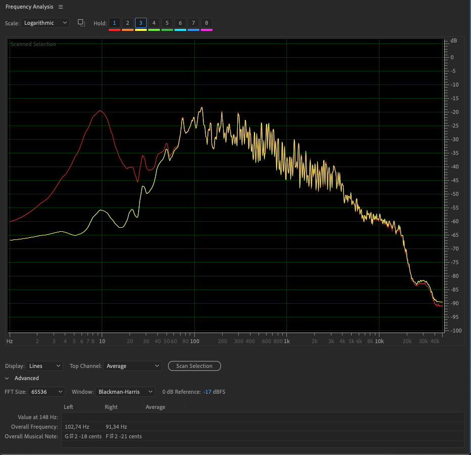

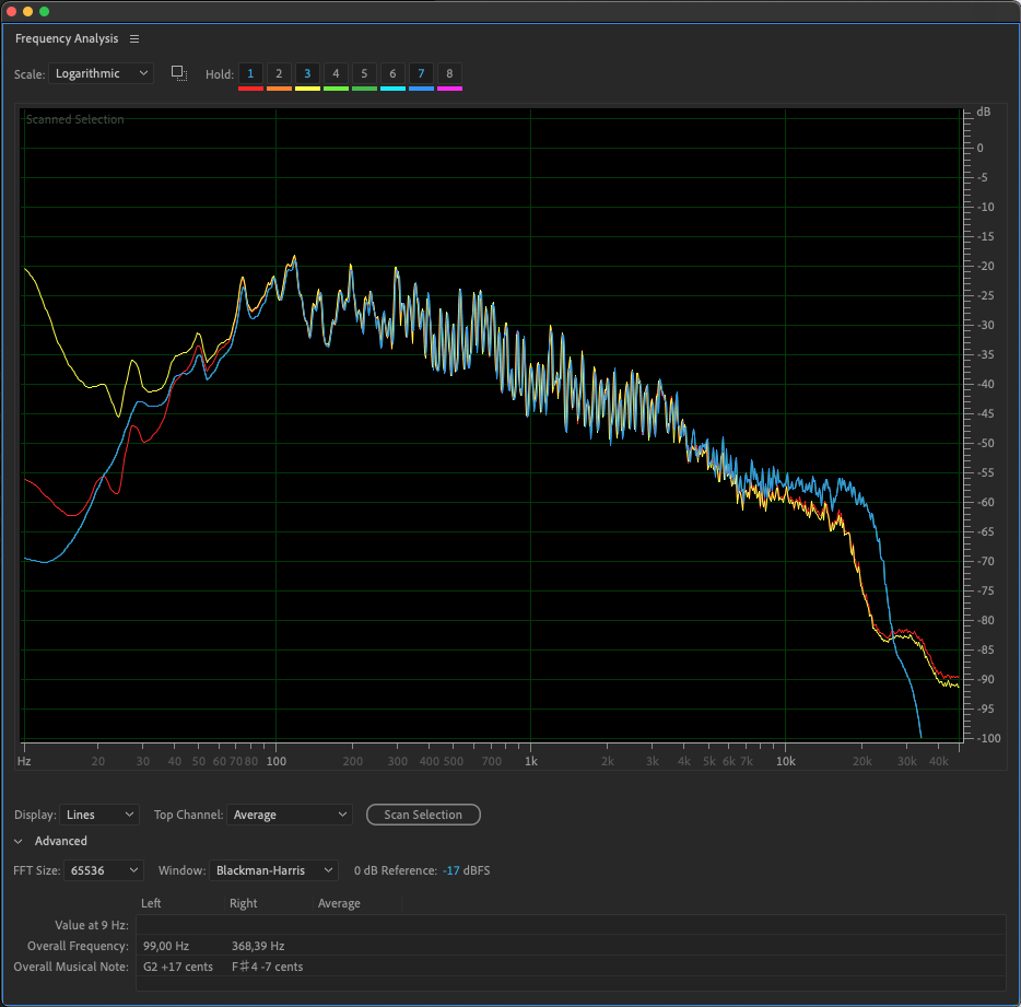

As an additional datapoint I tried comparing the spectrogram with the same clip based on the digital version (Amazon Music HD, 96 kHz, 24 bit) Turns out that version is playing somewhat quicker. I have not seen that before. I've done similar comparisons with other records matching the digital version and what a cart/preamp combination would yield and I've never seen this happen so I'm pretty sure it's not my turntables drive being off (the 1 kHz test tone on the Test LP also still measures in at exactly 1 kHz). The same 1-minute segment is ~500 ms shorter in the digital version.
Anyways, blue line is the digital version:
Looks like the digital HD version was mastered quite a bit differently encoding quite a bit more information at the high end - not that my ears are able to pick that up but it's interesting nonethess - albeit a bit offtopic with regards to the X-Altra preamp, so I apologize for that, but I thought it was an intersting find...
Finished wiring everything up - Lo and behold, with all the caps switched into the HPF the curves match up as expected and at 20 Hz, the X-Altra curve is exactly 3 dB below the TubePre's curve. The samples recorded from the record have a bump at 9~10 Hz - I think that would be due to tonearm-cartiridge resonance. When I look up my tonearm, cart and headshell at https://www.vinylengine.com/cartridge_resonance_evaluator.php?eff_mass=13.5 9-10 Hz seems about right (compliance for the DL103 should be around 11-12 @10hz and my HS is around 4.5g heavier then the standard headshell for which my tonearm's effictive mass was published so cart+hardware should be at 13g)

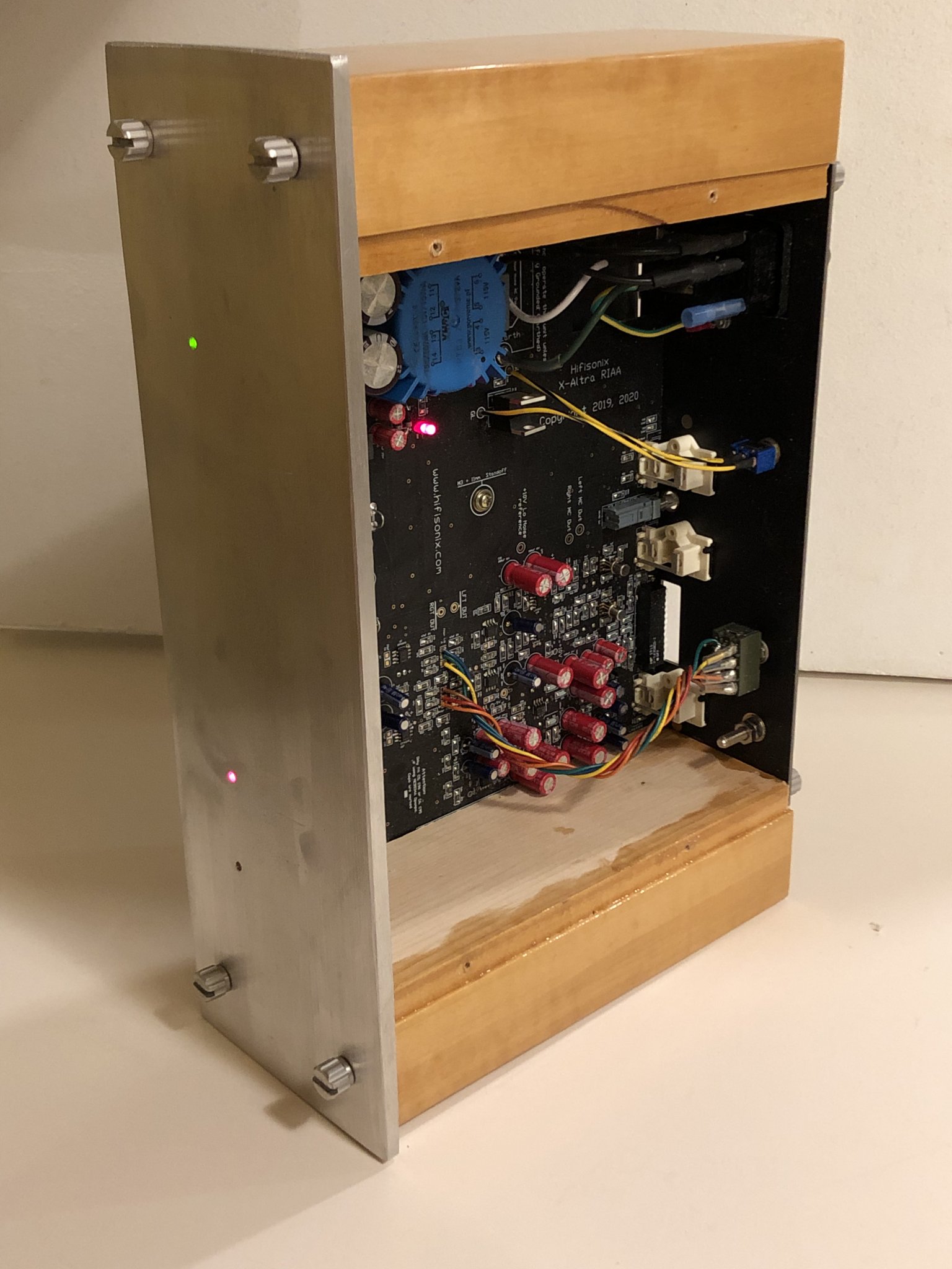

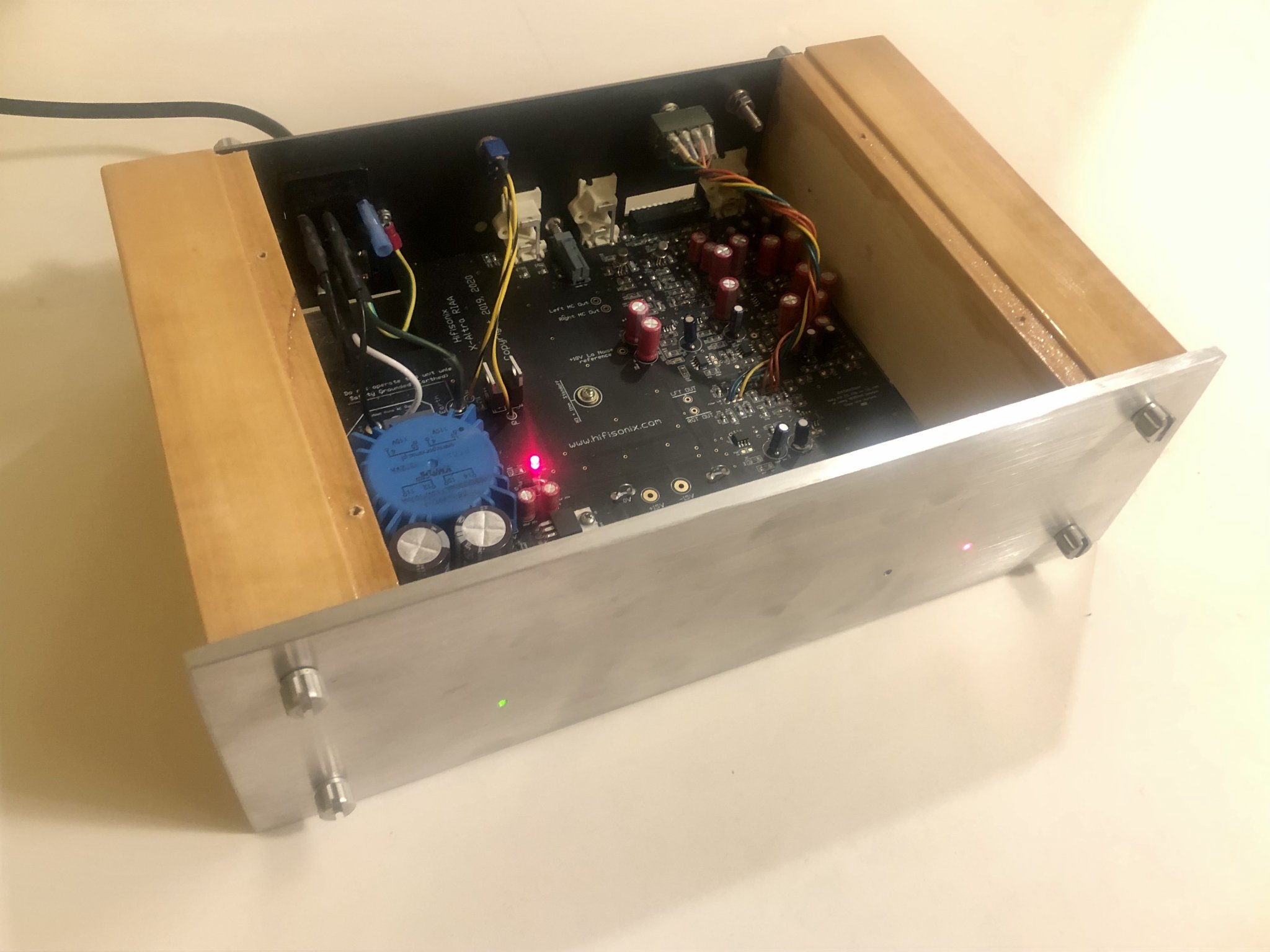

I finally got back to finishing up my X-Altra. I had been stalled on the enclosure. Shipping to Canada and the unknown “brokerage fee” that a shipper might apply left me looking for other cases and since I couldn’t find another extruded aluminum case that I knew would fit I made something up out of scraps that I had around. Wood on the ends and metal top bottom and front.
My question is regarding bonding to keep noise to a minimum. It looks like with the aluminum enclosure the enclosure gets tied to the back plane at the pads around the screws on the back plane. Since I have spectate sheets of metal for my enclosure should I use a jumper to tie them all together?
The photos don’t show an aluminum top and bottom plate that each screw into the wood end caps.
