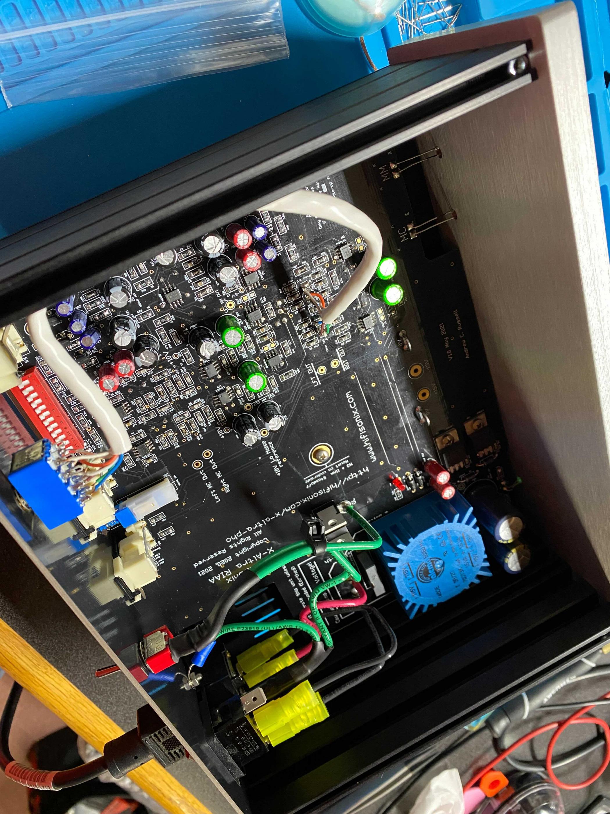

Shoot, Andrew. I took the emitter readings for Q1-Q4. Doh! Here are the COLLECTOR readings:
Q1 & Q4 = -1.520V
Q2 & Q3 = 1.509V
Not 2 V readings, but very consistent. I appreciate your input before I move forward. I will touch up my solder joints with some flux to ensure everything has a good contact. This is my first project with "no-clean" solder and it doesn't seem to wet the contacts as easily as normal solder.
Q1 & Q4 = -1.520V
Q2 & Q3 = 1.509V
Chris, I'm a bit late to reply to this - apologies.
Those readings are ok - looks like your X-Altra MC/MM is ready to go!
No worries, Andrew. I saw Terp's post had similar Q collector voltages and have planned to move forward. My work and family have been keeping me busy lately, so this fun project was put on hold. Thanks!

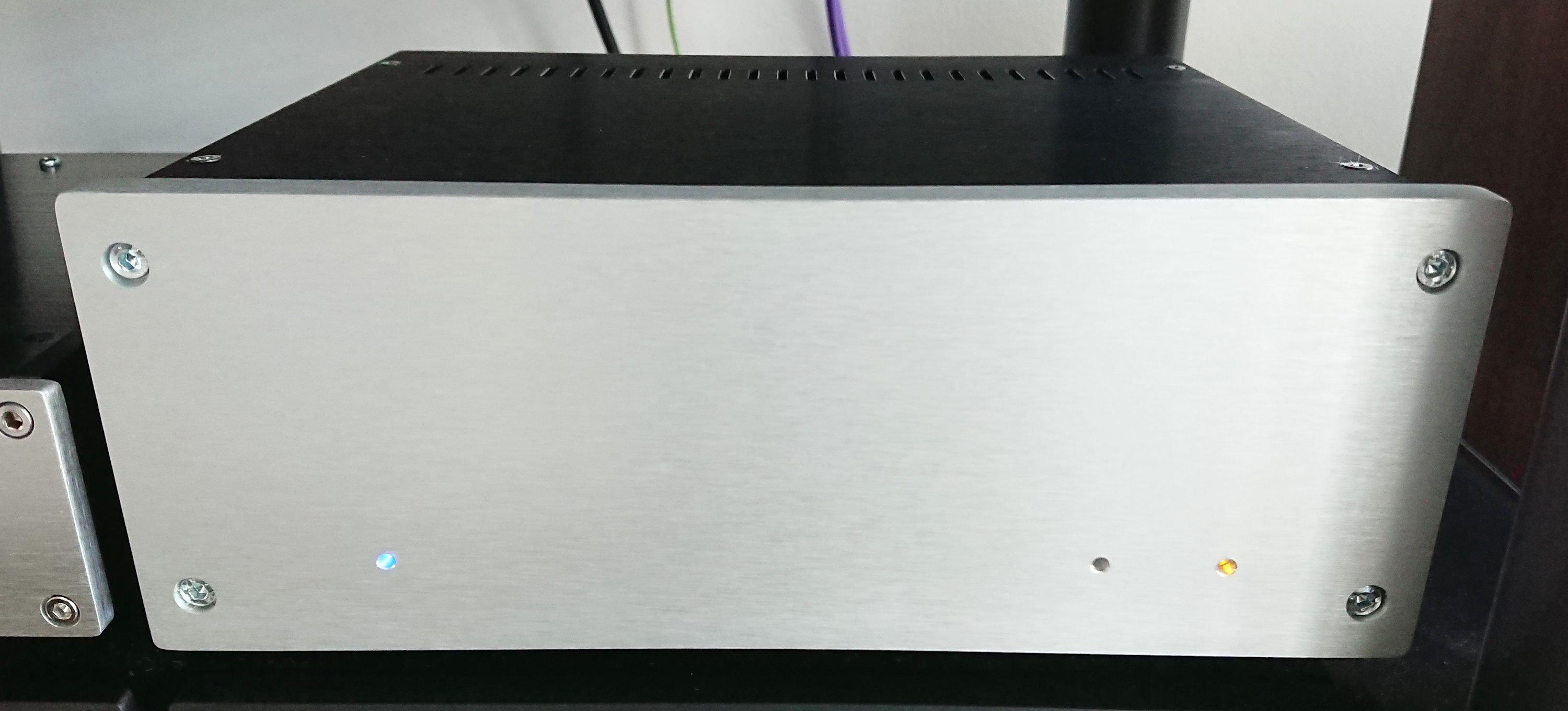

My X-Altra build was finished a couple of months or so ago and I’ve been testing this when time has allowed over what ended up being a rather busy summer. Many thanks to Bonsai for all the excellent design work and for enthusiastically supporting the community during the building stages. This was a very enjoyable build and my confidence with SMD soldering is now substantially higher. I think I actually prefer SMD to through hole now, at least for the bigger packages! The use of a pcb for the back panel was a wonderful idea and made a huge difference to a reluctant metalworker like me. It saved hours of time and the end product looks much better than I could have achieved by hand.
The X-Altra sounds excellent to me and is a noticeable improvement on my previous MM preamp. I actually needed to readjust my tonearm’s VTA, as I could now hear that it wasn’t correct, but this was masked by the previous amp. I’m very happy with it. It’s a very nice companion to my Ovation NX - another of Bonsai’s creations! A few pictures are below.

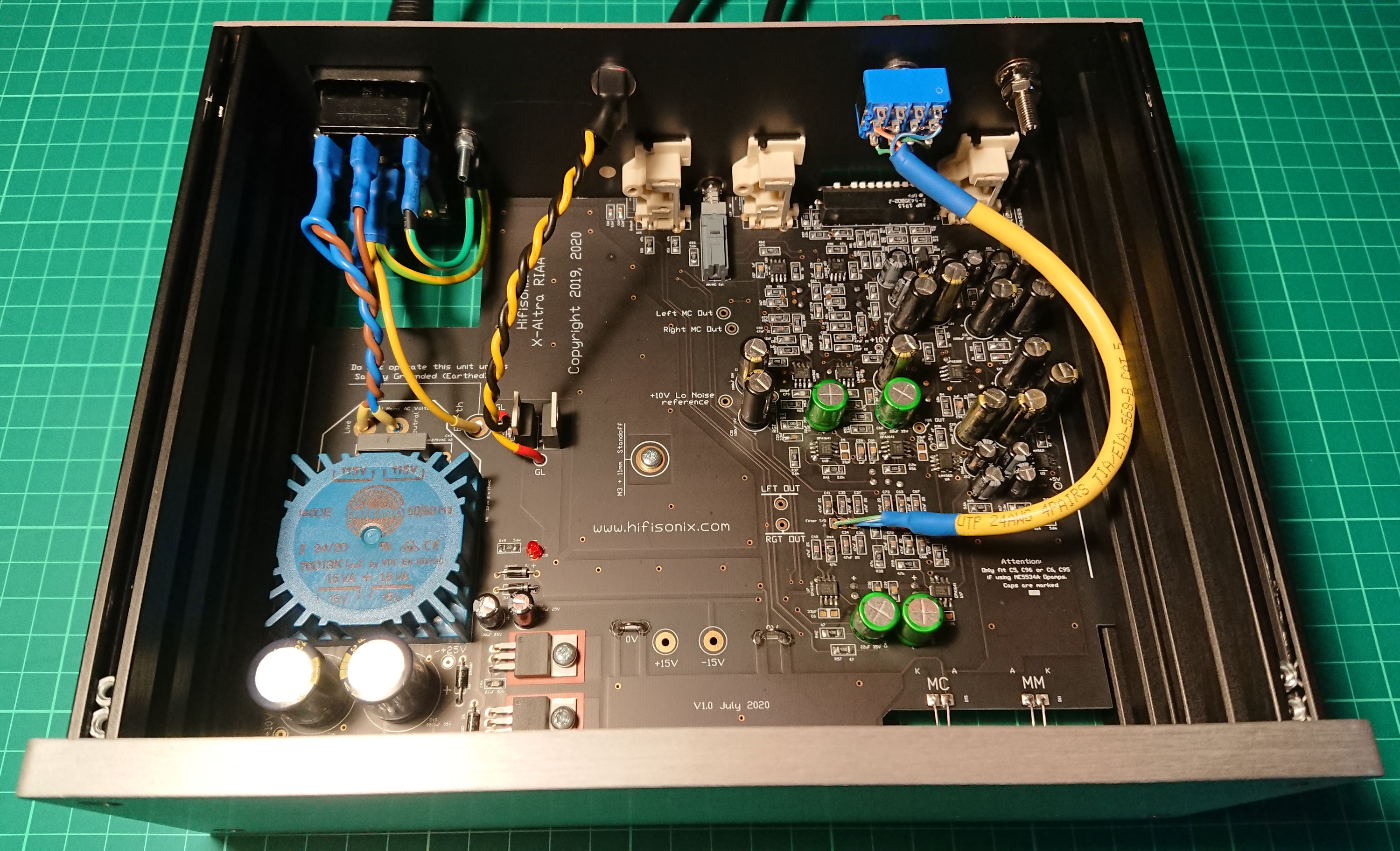

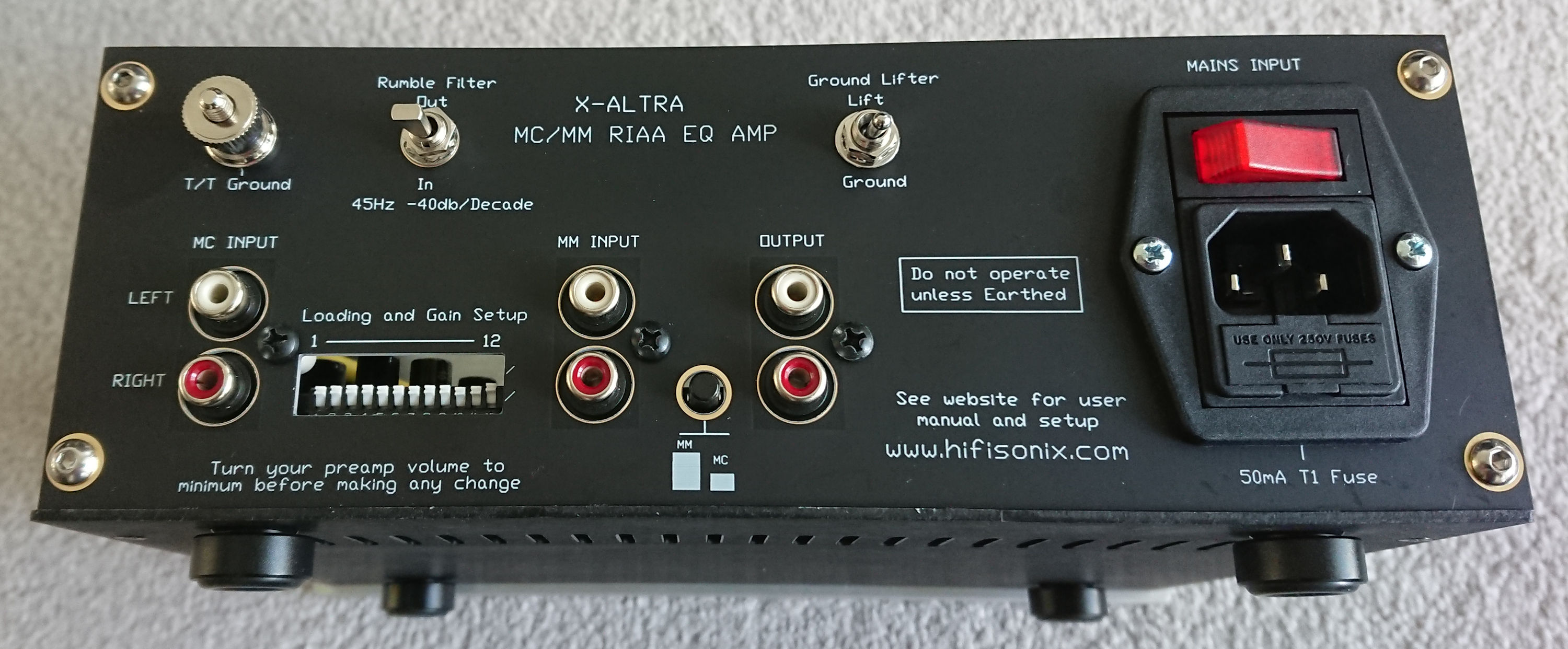

A couple of things that I noticed during the X-Altra build:
* Like a previous poster, I also found that I had a larger than expected DC offset (~110 mV) on one channel of the MC amp. I needed to replace Q1 and Q2 to bring this down to 35 mV, which is a little high, but the servo seems to handle it fine. Is it worth matching the ZTX851/951 pairs in upcoming builds to keep the offset to manageable levels? I didn’t do this initially, but did roughly match when Q1 and Q2 were replaced.
* The rumble filter switch that I went with (RS 320-972) switches the contacts in the opposite direction to the way that I think must be intended (based on the instructions on the hifisonix site). This means that the filter would be engaged when the switch is up (looking from the back), rather than down, if wired as per Bonsai’s diagram. I needed to turn this particular switch 180 o to get the action to match the silkscreen on the back panel – something to watch out for if you’re currently building.
* The user instructions document needs a small update regarding the system gain in the table on page 3 so that the gain available matches that available with 2k2 resistors for R54-56 and R39-41 (i.e. +6 dB for one dip swich engaged and +9.5 dB for both). The left/right labels are wrong for switches 9-12 as well I think – RHS = 9 + 10 and LHS is 11 + 12.
If you are getting high offsets off the bat, please check the orientation of C9 and C25 on your board. On the earlier boards (which you have) these two caps were oriented incorrectly wrt polarity on the silk screen. The cap +ve must go to 0V.
This does cause high offset due to capa leakage, although as you mention, the servo takes care of it, but its not a good idea to leave it like that.
Thanks for the feedback on the other points - I will come back a bit later this week.;
Hi Bonsai. I did indeed have the caps installed the wrong way round - this was before the board revision and info in this thread. However, I spotted the polarity issue when troubleshooting the high offset. Replacing these caps, with the correct orientation, didn't significantly reduce the offset in my case though. It was only by replacing Q1 and Q2 that I could bring this down to something reasonable. Cheers. John

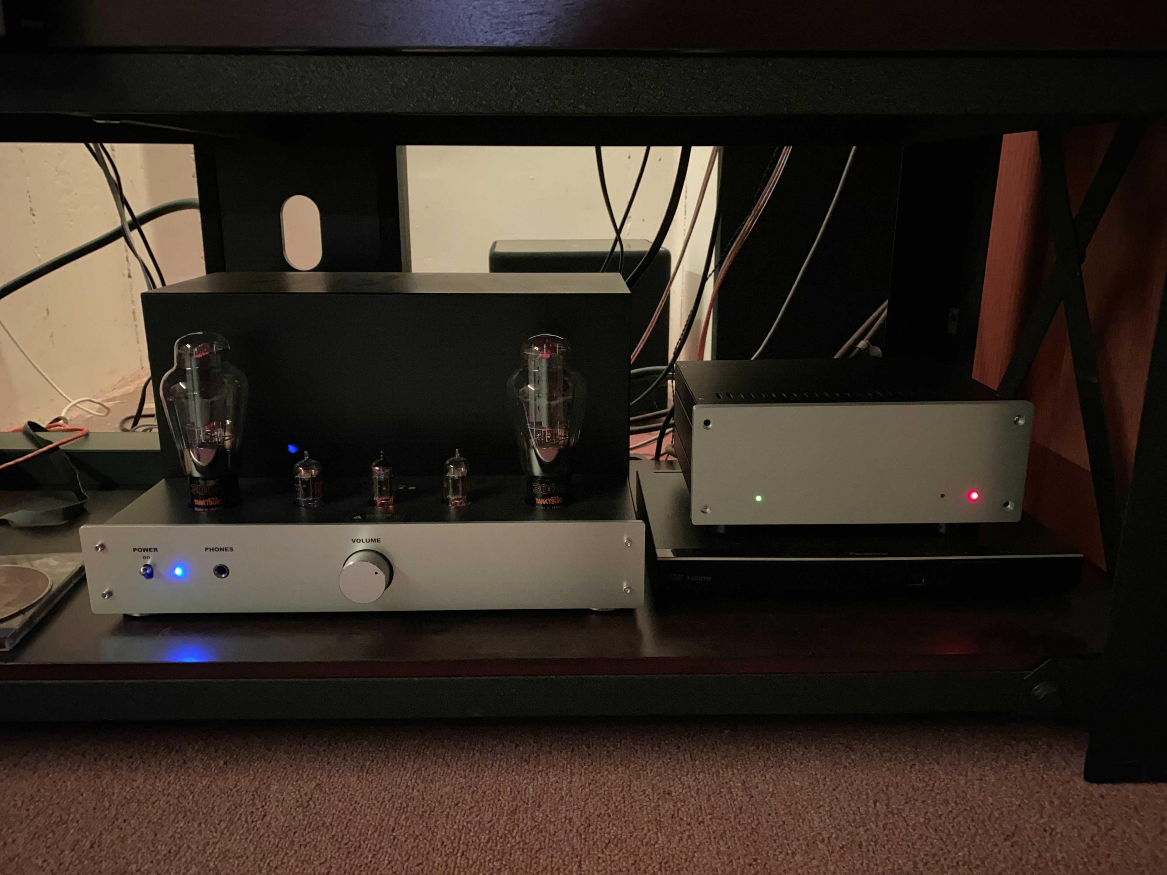

I finally finished this project a couple of nights ago and am still listening to my favorite records. So far, I am really pleased with this preamp. I don't have a super high-end comparison but the main thought that bubbles up in my mind is that the music sounds clean and accurate. The soundstage has depth and is an area I continue to evaluate.
This replaces my Elekit TU-8500DX with a few upgrades and Telefunken 12AU7 tubes that have a rich sound with a soundstage that can place vocals/instruments 1-2 feet in front of my speakers and 2-3 feet behind.
My system is a Sony record player (Ortofon Bronze MM) --> X-Altra Phono --> Elekit TU-8600S --> Zu Dirty Weekend Omen speakers
The record player is the weak link, as the plinth transmits sound to the cartridge. Bonsai's X-Altra phono preamp obviously has stronger bass than my Elekit 8500 since certain recordings have activated that plinth resonance, causing a strange bass drone. This never happened before.
The more I listen to this new preamp, the more I fall in love with the accuracy and small details that stand out in different ways. Thanks for your input along the way, Andrew! Very nice project!

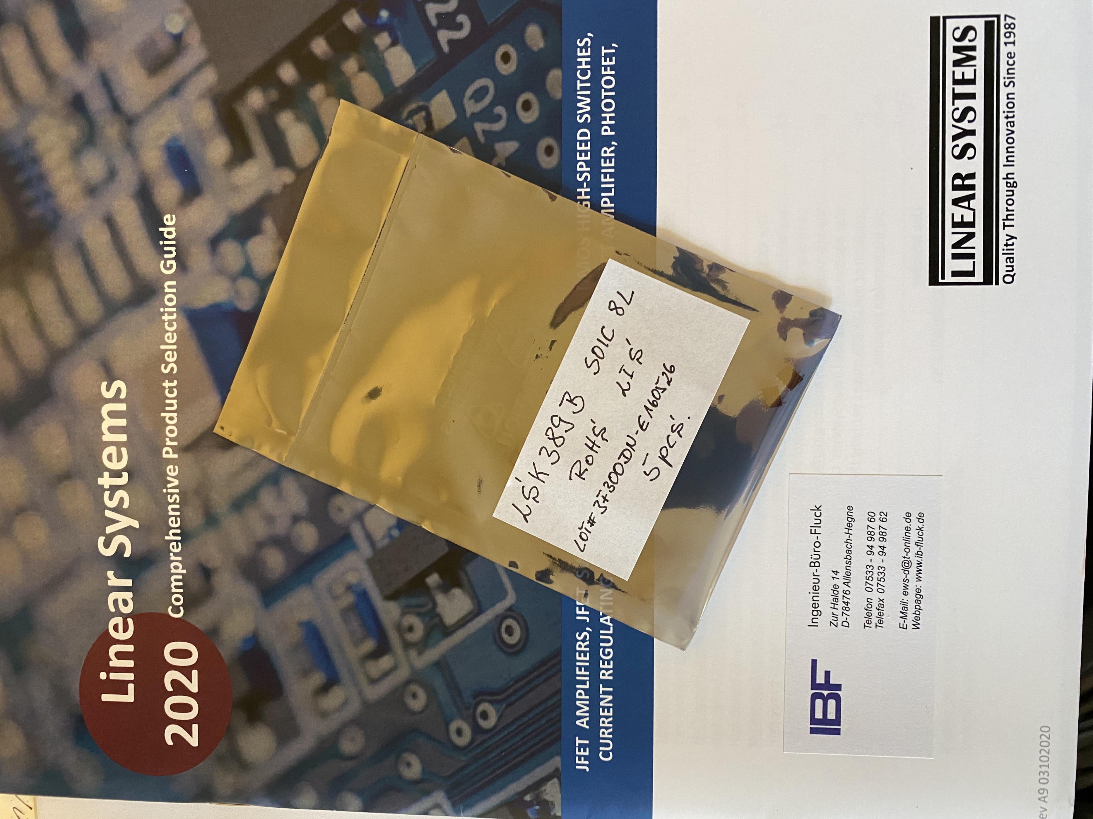

I thought I had all my components lined up but my potential source for the LSK389B turned out to be a false positive.
Does anyone know a place in Europe (Germany) that has them availble? Any viable substitutes?

Hey ZackPlonk, I had to purchase 10 and have 8 remaining. The bad news is that I live in the USA.
If you cannot find a good source, send me a PM with your address and I'll figure out shipping to Germany. No upcharge on them--the shipping will probably be prohibitive, but I figured I'd offer.
