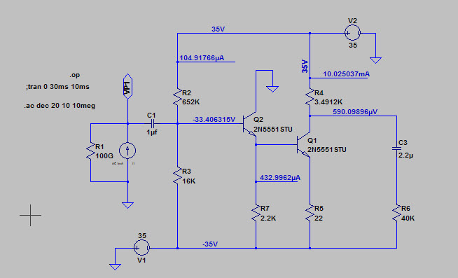

Hi All.
Just wondering if somebody can explain to me how the value of 200K was caculated for the input impedance to the Darlington VAS shown at the bottom of page 68 of bob 2nd edition.
I've attached some photos to help.
I thought that the input impedance was caculated from (22+2.6) x 100 (Q9) x 100 (Q8) Which totals 246K.
I understand that some of that will be lost because of R9 which has 0.5mA running through it, but I don't know how to calculate Bob's answer of 200K.
Can someone please help me understand how to calculate this.

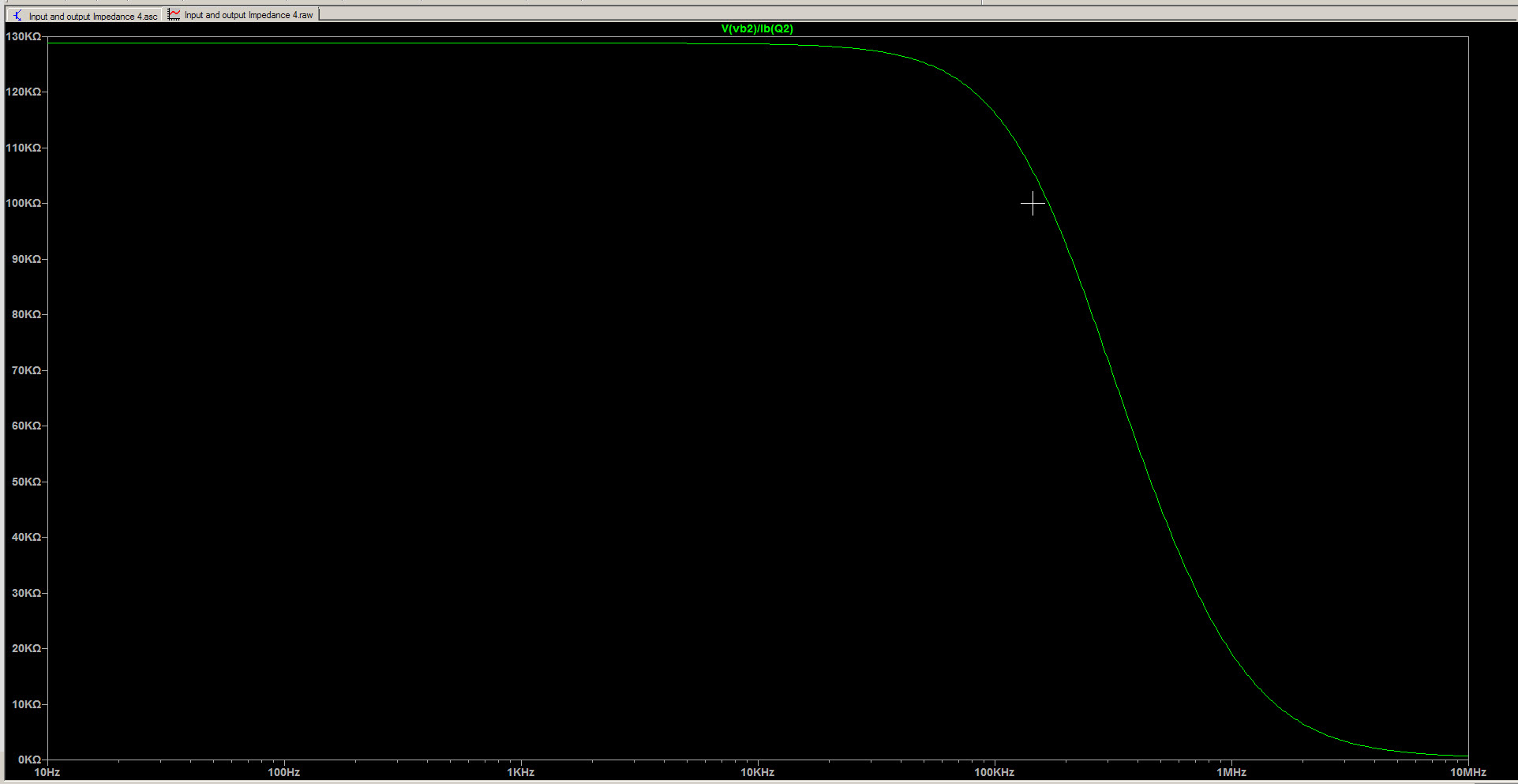

Tried to make a basic model of it in Ltspice
No luck 🙁

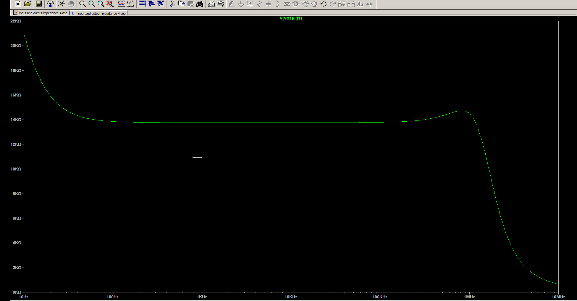

Yes, you have successfully simulated the input impedance of C1 feeding the R2/R3 potential divider (run the sim again with base of Q2 disconnected and you should get pretty much the same result, up to 200 kHz).
Then reconnect the base and run the simulation again, but this time plot (the voltage at Q2 base)/(Q2 base current). What do you see then?

In the emitter follower the input sees beta times impedance seen by the emitter - as the base voltage follows the emitter voltage (to 1st order), and the current ratio is beta.
So for instance an emitter loaded with 1k resistor and transistor with gain of 50 will look like 50 x 1k = 50k at the base. You can imagine a 20µA signal at the base becoming 1mA signal at the emitter due to the current gain. The 1k emitter resistor will make that 1V at the emitter, and thus at the base. All a.c. rms values.

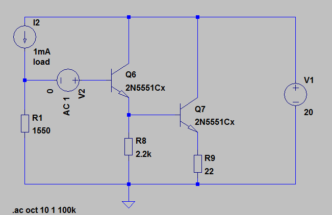

Well, in this case, your Zin is dominated by the R3 resistor value.
Zin will be equal something like this:
Zin = ( β7 + 1 ) * ( R8||( (β7 + 1)*(re7 + R9)) + re6)
So if we ignore re we have:
Zin = 101 * (2.2kΩ||(101*22Ω) ≈ 110kΩ
And the simulation result is closed to 120kΩ.
Open the sim file and plot V(N003,N002)/I(V2)

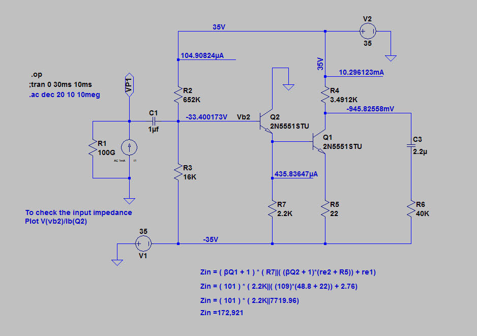

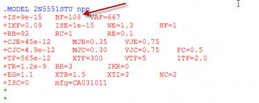

I re-ran the results and yes I get approx 130K as Jony has shown.
The math if I have done it right comes out to 173K
I have also have attach my files if someone else wishes to play with this too.
So are we missing something or did Bob just round this to 200K for simplification?

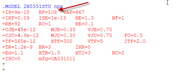

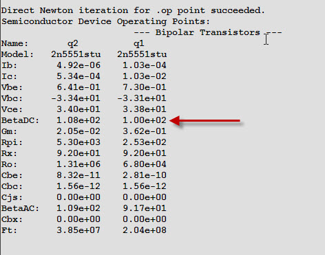

re ≈ 25/Ic, with Ic in milliamps, so re2 should be about 2.5 ohms in your calculation. I believe you'll then get an answer closer to the sim.
Note that the text in the book says the input impedance of the double EF is "the order of 200k". This is not the same as "200k", it's more like "approx. 200k".
It looks like you mixed the re1 with re2.Thank you jonyfor providing the math its a great help as I am a numbers man.
Zin = ( β6 + 1 ) * ( R8||( (β7 + 1)*(re7 + R9)) + re6)
re1 ≈ 26mV/10mA ≈ 2.6Ω
re2 ≈ 26mV/436µA ≈ 60Ω
Zin = ( β2 + 1 ) * ( R7||( (β1 + 1)*(re1 + R5)) + re2)
Zin = (101) * ( 2.2kΩ||( (101)*(2.6Ω + 22Ω)) + 60Ω) ≈ 124kΩ

I think I just did it the simple way and rounded it, as Mark described above. The key words are "on the order of". Keep in mind that for beta ranges of 2:1 in each of the devices, the impedance number can have a range on the order of 4:1. I always get a laugh when I see in a manufacturer's SPICE model something like VA = 105.273. Give me a break 🙂.
Remember, good designs have minimal dependence on transistor current gain unless that current gain is quite small. Moreover, any design that depends on beta being SMALLER than some number is likely asking for trouble.
