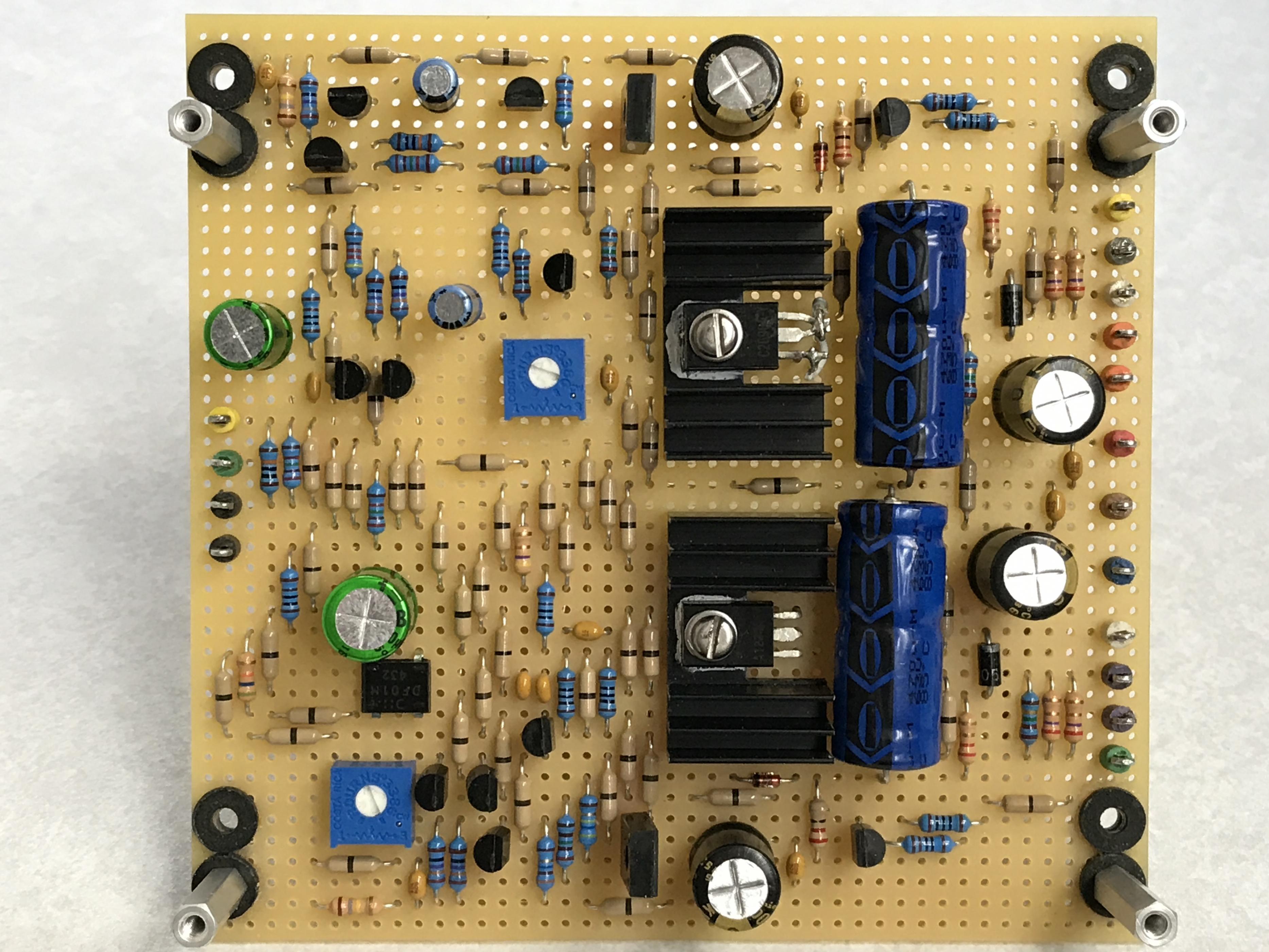

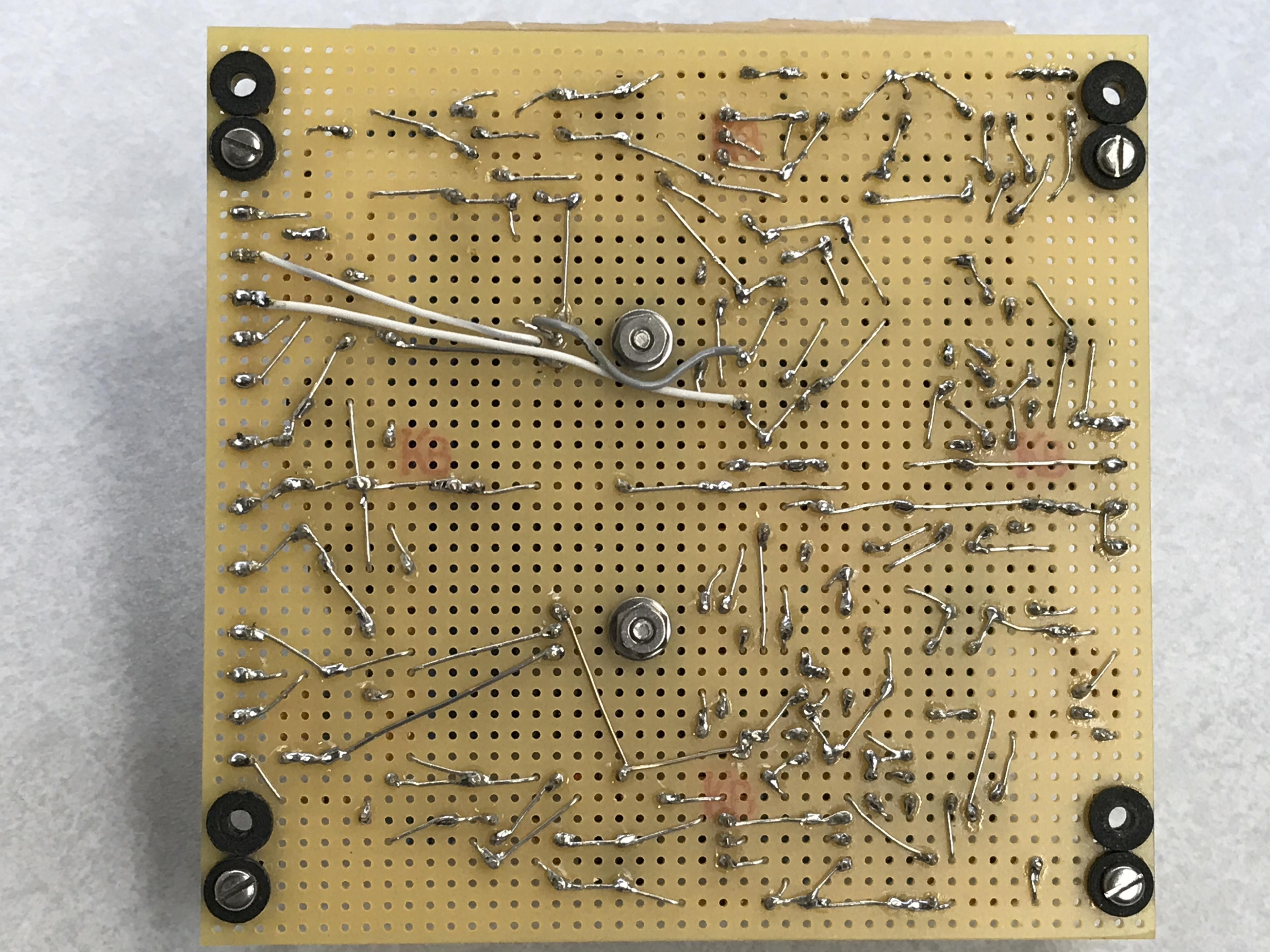

For my PCB design I used surface mount and crammed everything onto the board, but did use both sides. Will the potential PCB track routes with stray capacitances always be an issue for MHz oscillation, and therefore, ensuring that the PCB has the component positions for adding stability aspects (VAS zobel) be the best approach ?.

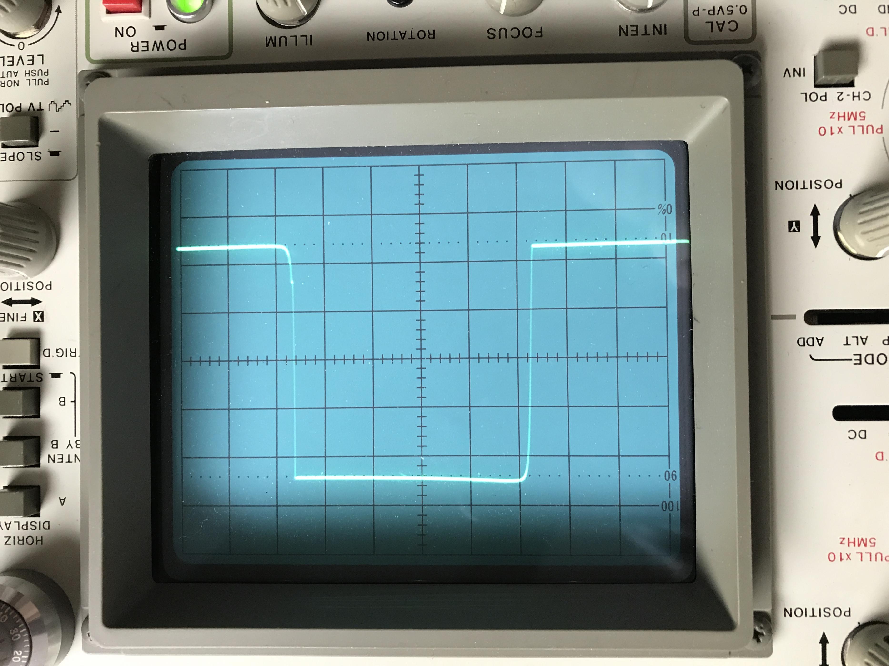

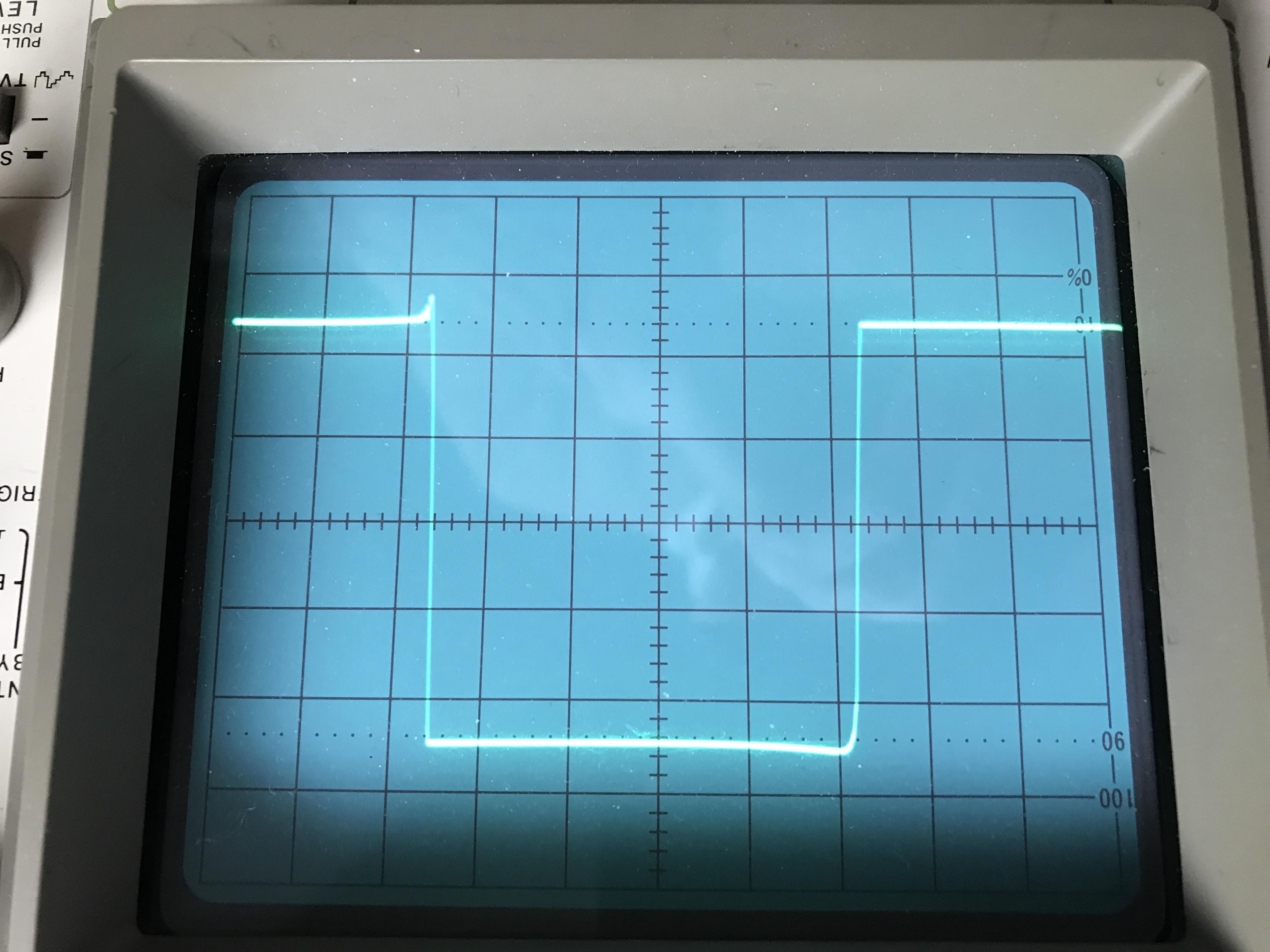

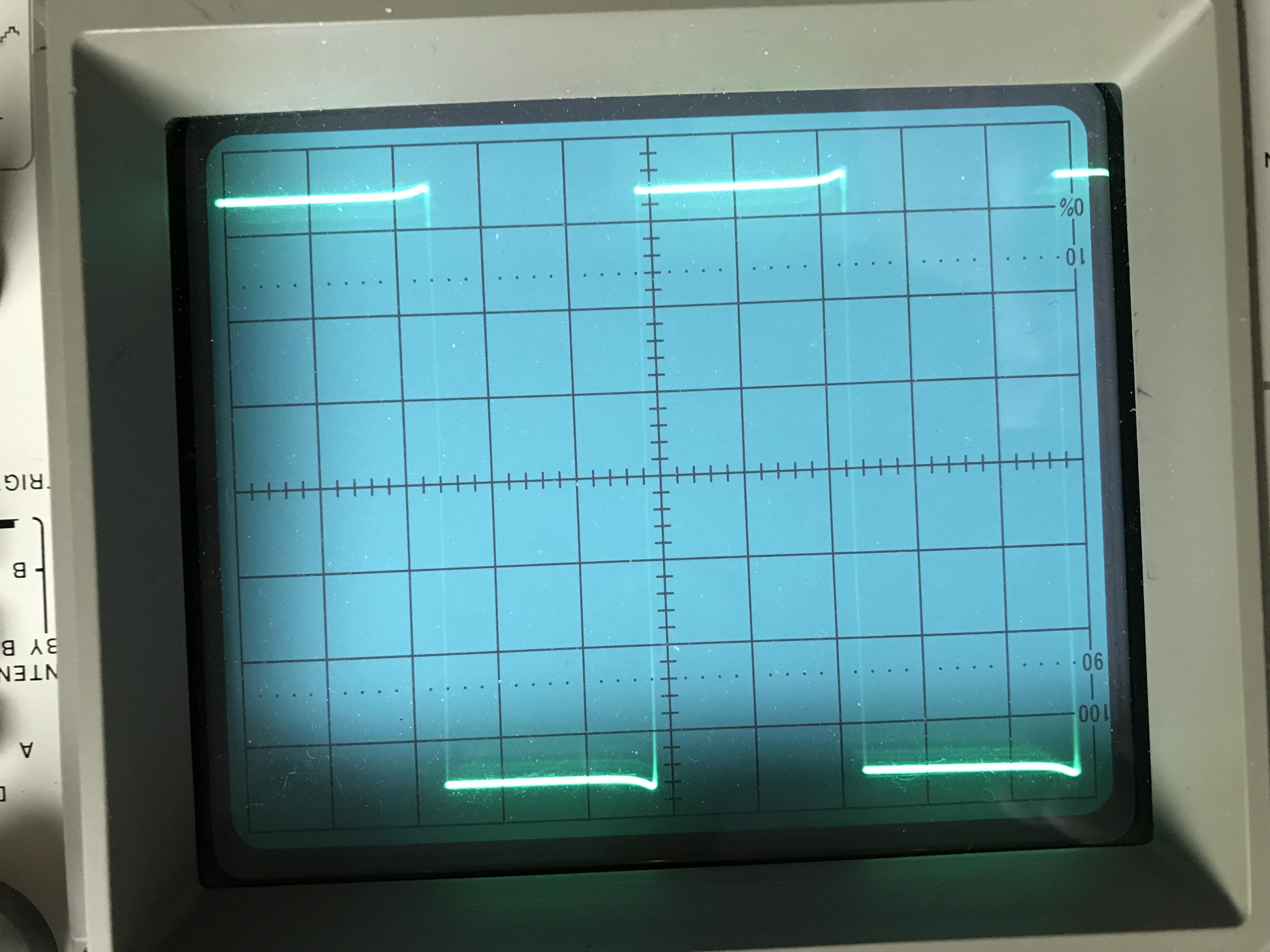

Circuit board with output from drivers is good but when outputs are connected, one pair or 2, no difference, I'm getting some strange ringing. Scope photos below. No load on output. Any ideas? VAS zobel is 100 pF / 100 Ω, Cm is 56 pf in series with 56 pF, 1 kΩ to output rail (TMC).
Photos are upside down, even after rotating and reloading.
1 - 10 kHz square wave, 25 V peak. Positive side looks good, negative side has ringing.
2 - 10 kHz but signal reduced. Note the glitch on the negative swing. Raising signal level causes this glitch to move down and eventually become the ringing.
3 - 2 kHz square wave looks good.

Hi Fred,Circuit board with output from drivers is good but when outputs are connected, one pair or 2, no difference, I'm getting some strange ringing. Scope photos below. No load on output. Any ideas? VAS zobel is 100 pF / 100 Ω, Cm is 56 pf in series with 56 pF, 1 kΩ to output rail (TMC).
Not sure of your design, but if it is not a balanced VAS, then the VAS output may have difficulty switching to a near full on or nearly fully off, depending on how you look at it. Could this be the issue you are seeing ?

I've never seen so many 0ohm resistors! Do you not want to post the schematic?
Schematic is pencil and paper and needs some cosmetic work before I can scan and post. It's still being marked up with revisions. However, it is very close to that on page 88 of Bobs book except resistors are mostly 1% standard values, no D3-D6, no Q5, C9 is split (TMC), and bias spreader is slightly different. On page 92, I don't have C27. H'mmm. Never noticed that before. Might be something to test.
I also have an offset trimmer injecting at the top of the feedback capacitor, even though IPS and current mirror are beta matched.
The 0 Ω resistors are to get from here to there and are easier to deal with than cutting jumper wires. Picture of the back side attached. There were still a couple of wires, needed to get to the bias spreader from the board edge. The standoffs are for mounting the other channel above. Trim pots are offset so the right channel trimmers can be accessed through holes in the left channel board.

Quite possible. The problem would be where the VAS turns on heavily (negative slope of the signal). VAS standing current is measured as 10.9 mA at the current source and 11.1 mA at the main VAS transistor. Not sure why the difference, maybe resistor tolerance. I'd think that they should be the same. This is probably affecting output offset, though my power supply rails are also different by 1/2 volt or so. This is an update for a vintage receiver, so there are other loads on the supply that are not entirely balanced.

I'll look forward to seeing the schematic when you are ready to post it. Seeing the full schematic can greatly help us better understand some of the issues you are facing, and revisions that may make the design more stable.
I like the idea of using the 0-ohm resistors as jumpers when their spread is long enough. Packages of jumpers of various sizes and colors are available, and I use them. However, in the kits I've gotten, a color seems to correlate with a size, and I often like to use a color that is somewhat consistent with the function of the wire in the jumper, especially if the jumper is power or ground.
It looks like you are using single-turn trim pots. Although single turn is adequate for some trim functions, I always default to 10-turn pots. This is especially the case for the output stage bias pot.
