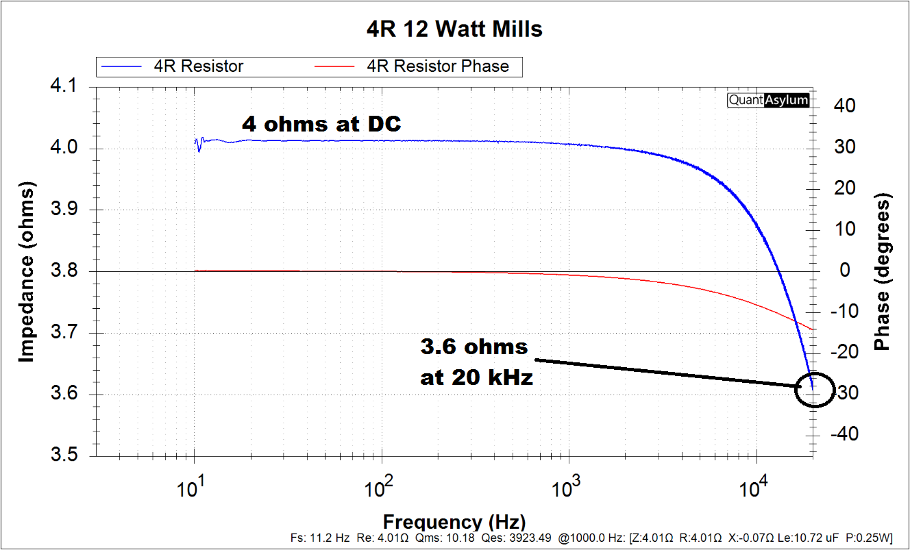

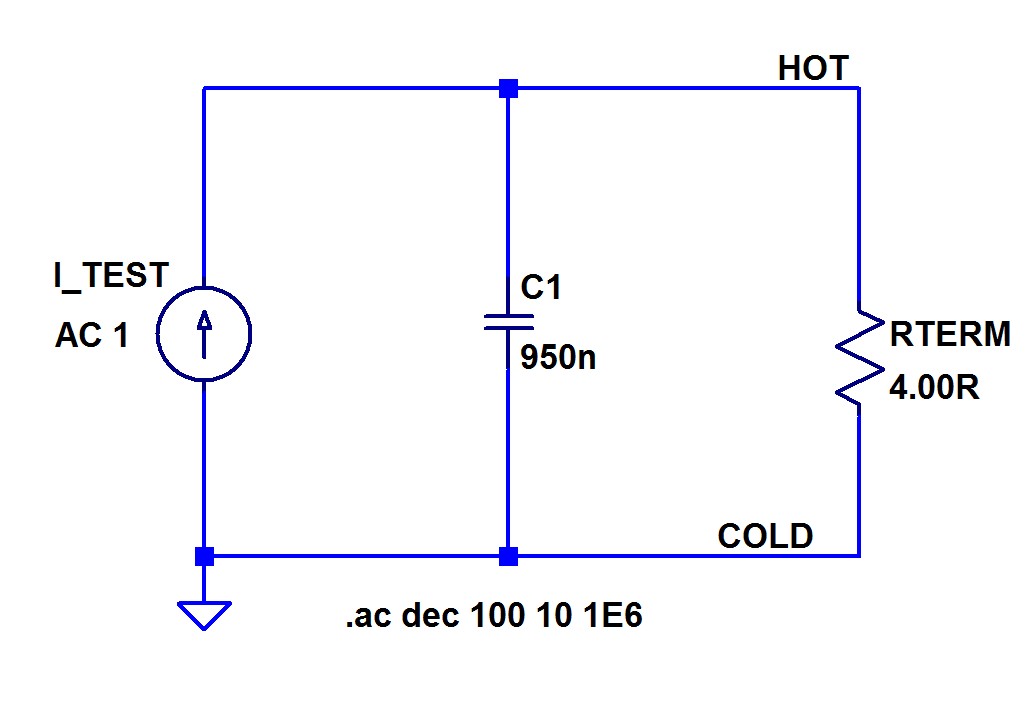

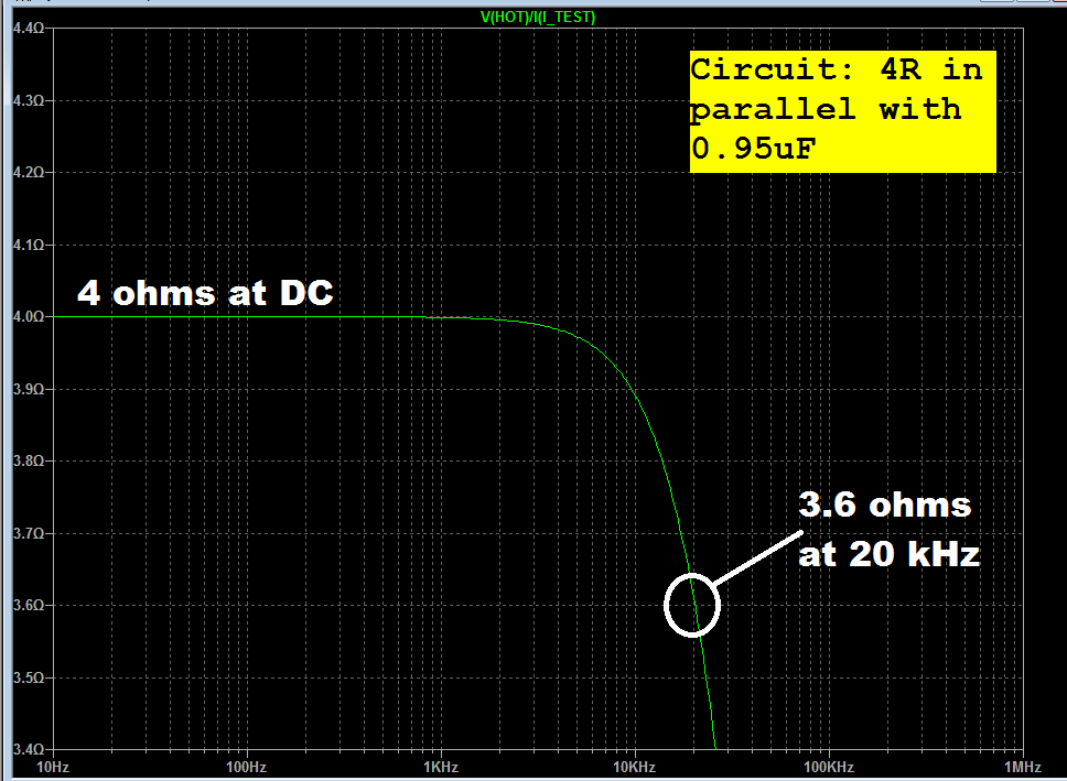

Jan, I am puzzled too. I get different numbers.

Hello Jan,
Nothing fishy or magic here. It is all in the details of the QA401 software code.
As in Le := (calculation results) Le is only a variable name; in this case on the Z (impedance) scale. Le is labeled in H units if the current lags voltage and labeled in f units if the voltage lags current. I assume that an If,Then statement is used in the software code. E L I, I C E
For this test setup the voltage across a 0.01Ohm current sense resistor is user to calculate the test circuit current; E/R = I. Knowing the test circuit current the voltage across the DUT is user to calculate the DUT impedance; E/I = R.

Mark,
I remember that there are several impedance models for speaker impedance including off the top of my head “Wright”.
I doubt that the QA401 software uses a simple resistance in parallel with a capacitance to calculate their plots.

Hello Jan,
OK, yes I can follow that logic. It's just that Le is normally understood as L(equivalent) in Henries.

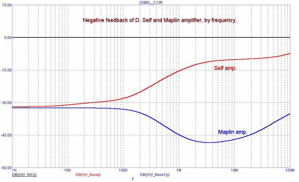

I found the #55 cable was 37*0.32mm inner. This was listed in the cable models of the last known version 12 April 2008 on page 14. It is attached.
Also attached is a zip with MC7 files that Cyril sent me.
One of these files, Cap3.tif, shows the feedback in dB with frequency for both amps for signal reaching the input stage. I'm not sure where the signal was injected for this plot. I presumably includes the output inductor and Zobel. There is a test in Part 2* p26 "Zobel RF attenuation" where the signal was injected with an unterminated cable present -- but not sure if a cable was present for the plot . (*Part 2 link Re: Cyril Bateman Capacitor Sound Archive - Pro Audio Design Forum)
What I find strange is that both amps oscillated with his unterminated #55 cable. It therefore cannot be attributed simply to Self feedback capacitor across the feedback resistor - it would be an easy problem to solve if it was due to that capacitor. Of course you could solve the problem by not using any exotic speaker cables, but that's too easy:).

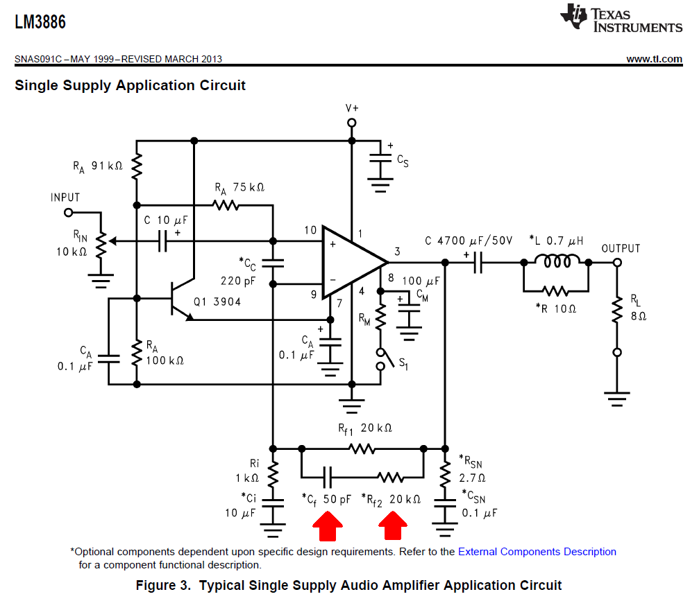

Possibly the leads could act as an aerial at some critical tuned frequency. The lead capacitor impedance reduces with increasing frequency whereas the feedback transistor base emitter junction diode could be a detector.
In the Super Gain Clone thread there is a 22k stopper resistor in series with the 47p lead capacitor making this a step network in parallel with the 20k feedback resistor.
It's right there in the LM3886 datasheet, and I suspect that was Bob's inspiration for installing it in the original Super Gain Clone.
