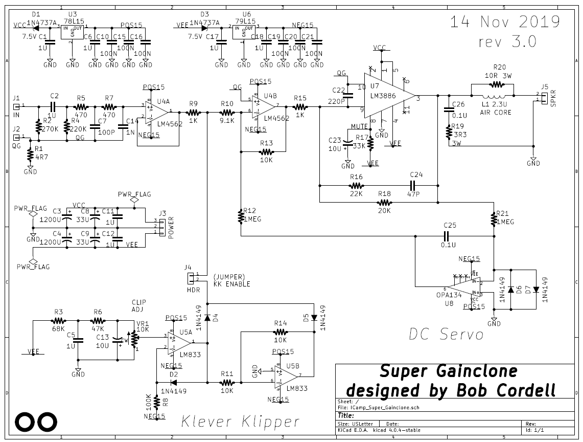

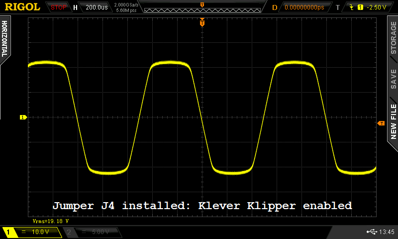

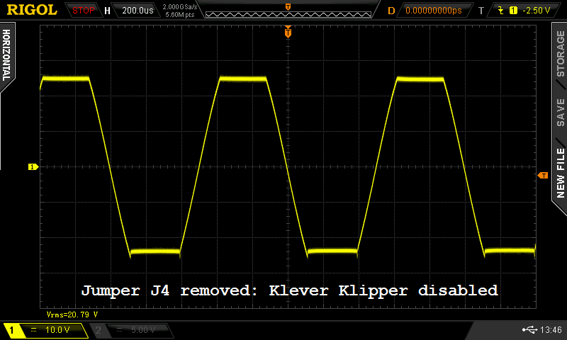

I've now got a step-by-step procedure for adjusting the Klever Klipper. It appears to me that when you get the KK dialled in correctly, it works very, very well.
Here are the before-and-after photos of the same amp ("Super Gain Clone") with the same 1 kHz input sinewave driving both channels, and the same load resistors. We drive both channels to get the max possible "sag" on the power supply, so the amp will clip even sooner. The only thing that changed between the two pictures is the installation / removal of jumper wire J4, which enables / disables the KK.
It sure does look awfully nice to me.

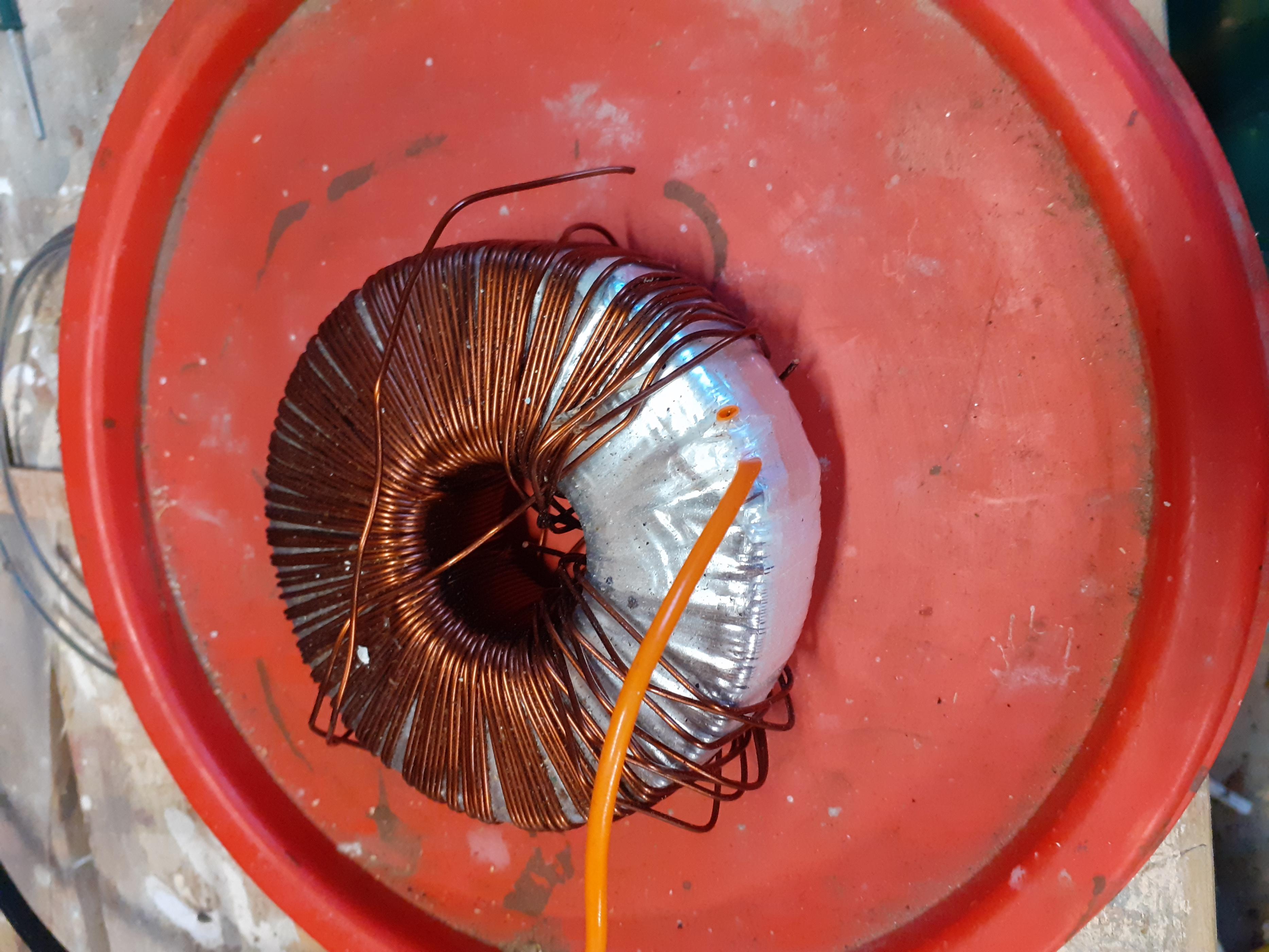

Attached is a shot of a toroidal transformer from my "black museum" which I replaced.
After one of the primary winding ends had broken off I unwound the secondary to see if I could get good enough access to repair the broken end.
The primary insulating tape can be seen. As to the number of layers one would be guessing as to how many would be enough.
The transformer was a 25V-CT-025V ac of 160VA. I would expect the insulation for a mains isolation transformer would need to be more substantial.
With no insulation between a primary and a secondary winding this idea should be laid to rest.

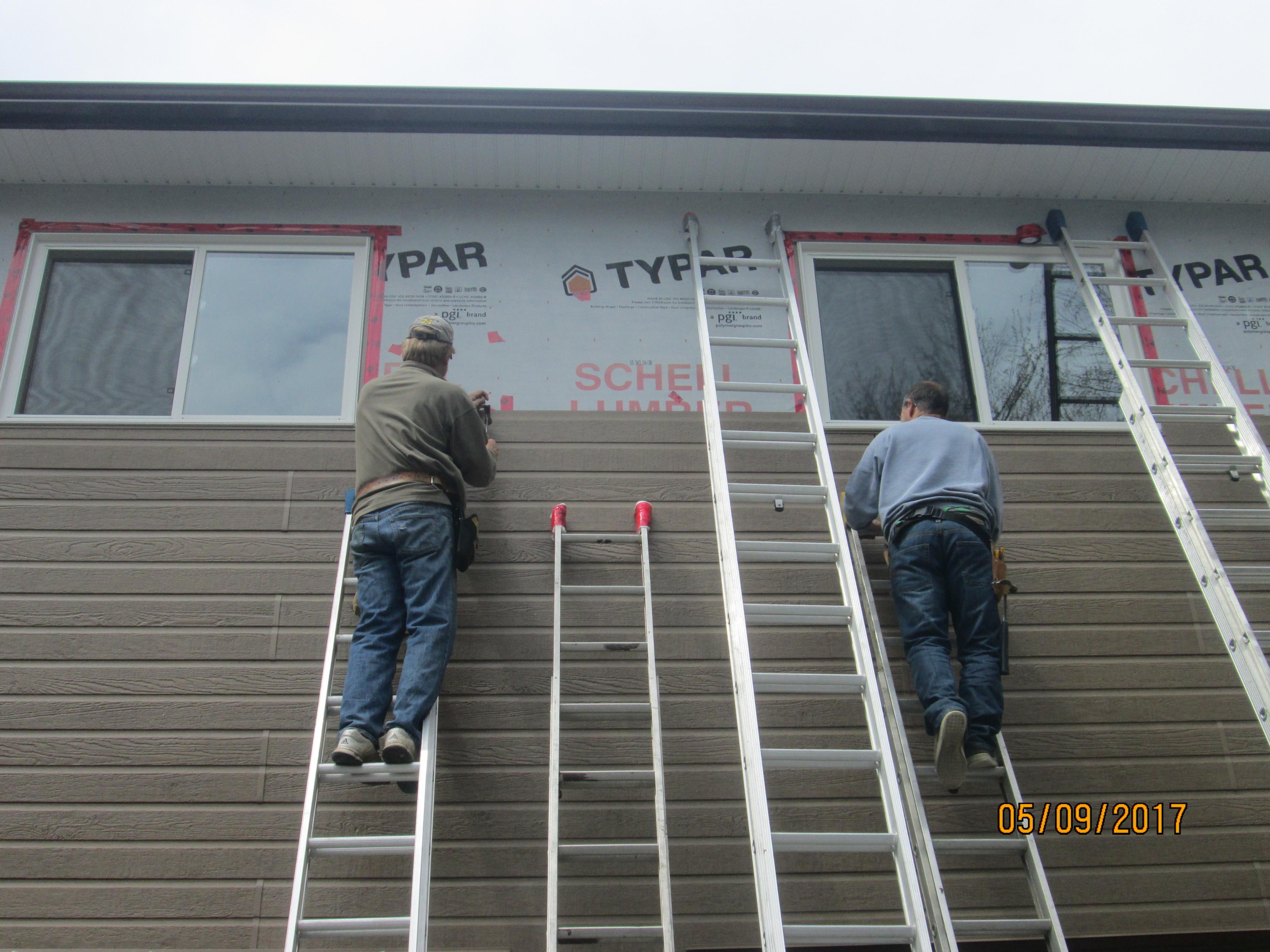

The cheapest house exterior siding these days is vinyl by a long shot. 2 years ago we sided the garage/loft, 768 sq. ft. I do not like vinyl, I chose CanExel® Ridgewood D-5, basically pre-finished imitation wood siding, I get comments on how good it looks, you tell me. Nothing like hopping across ladders, to save time going up and down 🙂 I found out what Bursitis in the hip is all about after that job was done.

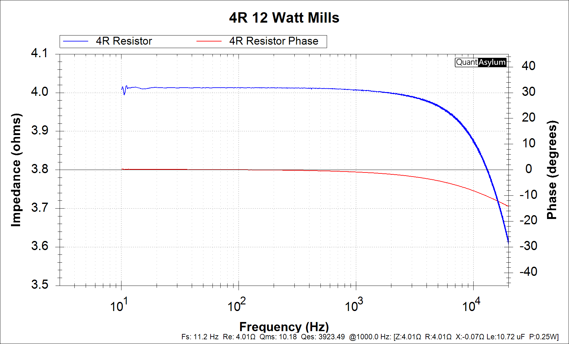

There is a QA401 Audio Analyzer sitting here test driving the speaker impedance application. The amplifier will be called nameless. To setup the baseline there is a 12Watt 4Ohm Mills resistor, the kind used in a quality crossover. The connecting speaker wires are 5 feet long fine stranded 12 AWG flexible silicone rubber insulated, the kind used for test instrument leads.
See the attached QA401 plot. The output data shows 10 plus uf capacitance with impedance and phase shift with increasing frequency shown on the plot.
10uf is a lot of capacitance hiding somewhere.
The capacitance on test does vary a small bit if I adjust how the leads are placed on the carpet covered concrete floor.
