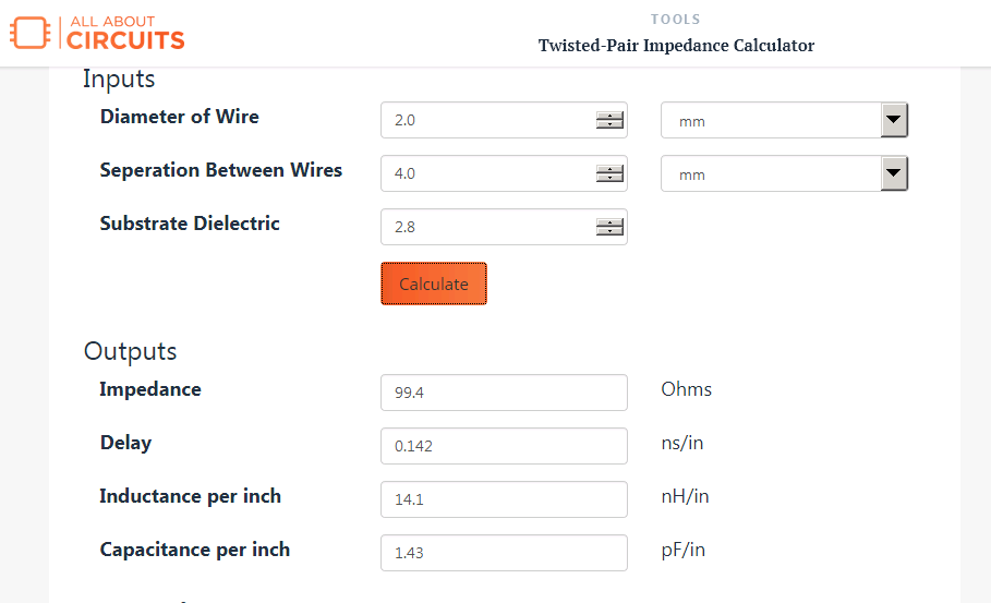

Ok thanks Bob, RNMarsh reckons 100kHz is into TL behaviour for 100R/Z Cat5 pairs, agreed most fig-8 twin speaker cables will be around 100R.

Can anybody here do measurements including RF impedance on a say 3m length of Cat 5 please ?.
Dan.
What measurements do you want? The DCR can be calculated from the gauge. The RF impedance is 100 Ohms +/- 5 Ohms measured to 500 MHz (Cat 5 E) and higher for Cat 6 & 7. Most reputable cable has been tested and certified to UL standards on a network analyzer.
If possible a Z sweep of Cat5 wired as speaker wire (the 4 pairs paralleled).
IOW I want to see at what frequency paralleled Cat 5 becomes TL, and the Z absolute value....please.

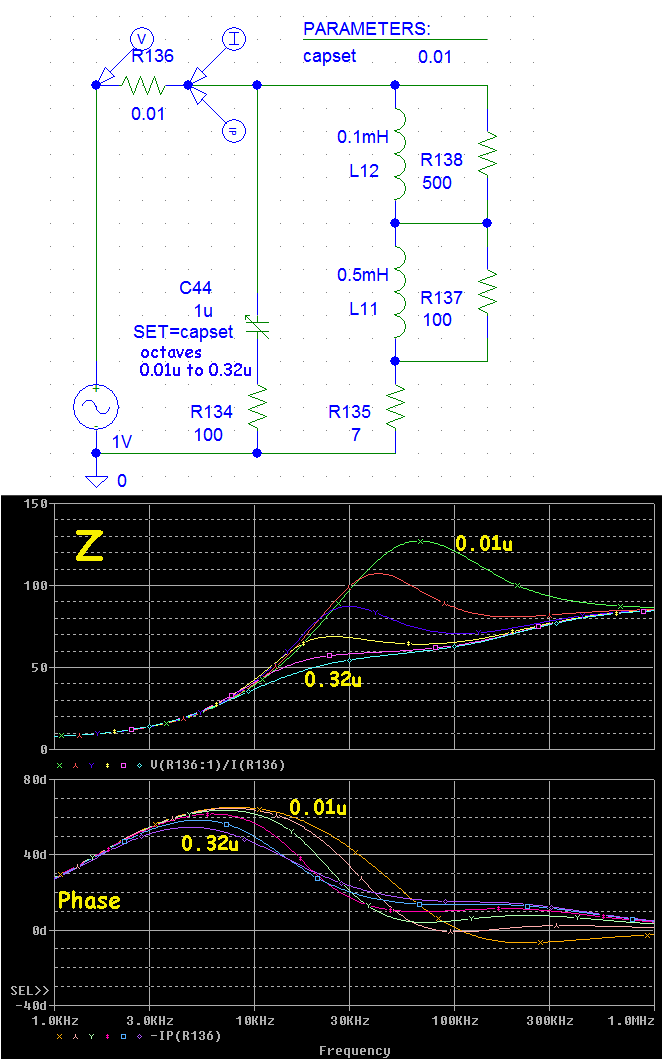

Hello Bob, how did you arrive at 0.01uF value ?......
...all things are considered, the overall optimum is quite broad. ...
Cordell may be (generally IS) right. But it took a long session on the board to see why. 100r + 0.01..0.1u all seem fine, and "all things" must consider the speaker.
I started with a basic R-L model of speaker impedance over 5kHz. I got some mighty sharp resonances, around 160kHz. While Cordell's "audio" amps loaf at 160kHz, I remember when that was a real danger-zone for most transistor amps. While many Tigers died, a few survive to this day.
Ah! SPICE coil is perfect, real speaker inductance is real lossy. Eddy current in the pole. An LR network is a narrow approximation, a string of LR is better. The Dodd paper surveys several models against a real speaker, however it is a woofer. Applicable to Full-Range speakers but not boxes with tweeters. No values given either. I "know" the shape of a speaker's Z above the audio band and hacked the curve.
With eddy-coil loss the curves get smooth and the "optimum is broad". Anything from some less than 0.01u to say 0.1uFd is fine. (0.3u may be over-damped and also absorbs cymbal-power.)
Part of the reason for "no preference" is that different tweeters will have different inductances and losses. So the curves will vary. Enough to matter? My shoulder is sore, not today.
BUT: I assumed a normal voice-coil tweeter. There are electrostats. I have been touted a "panel" which clearly had a Motorola piezo (made trumpet sound like plastic). The Z of these goes DOWN above the audio band (there may be some stopper resistance). Then a zobel at the speaker does about nothing; of course some amps still object to naked capacitance.
