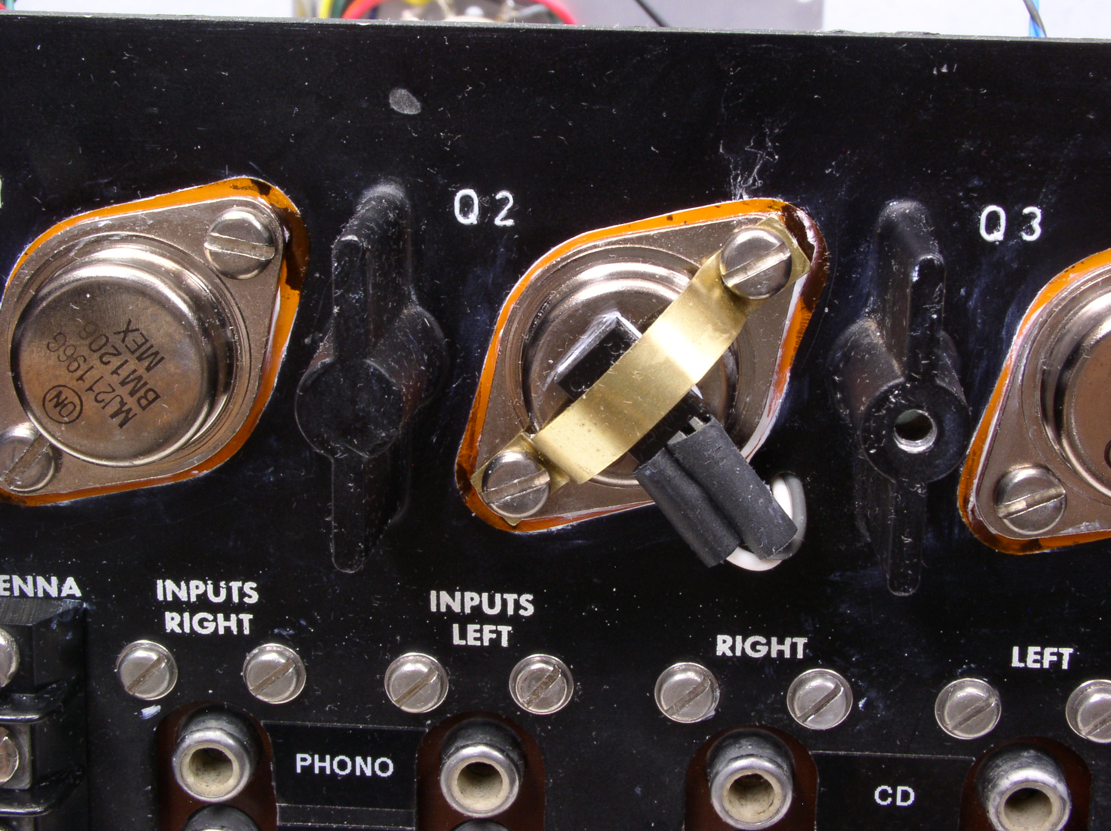

The 2 transistors in the bias spreader are mounted on one driver and one output. As stated earlier, this has been a very good setup. While the drivers maintain constant temperature, there is a major change during initial warmup. Photo of the output sensor. The KSC2690 is completely insulated so it can be clamped directly to the TO-3 case with a custom cut brass strip.

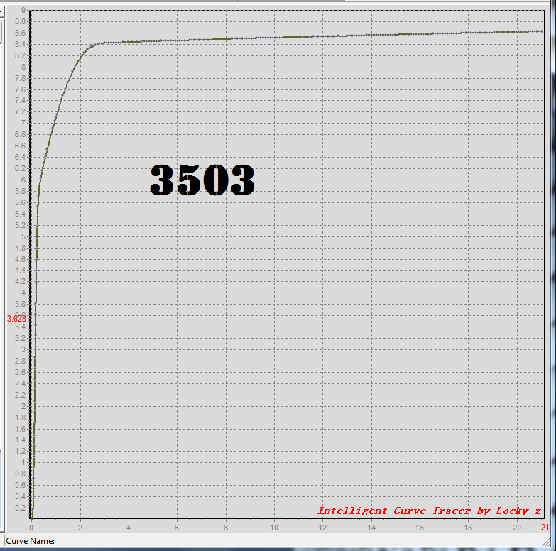

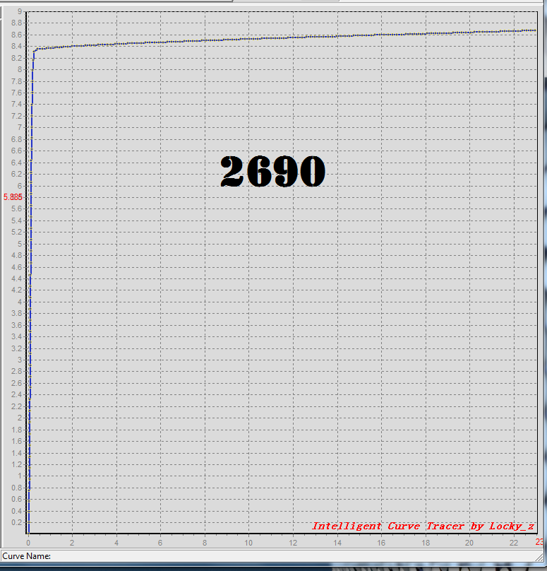

Also if Bob used the KSC3503 and you use the KSC2690, it could be that your transistor is just harder to drive (I don't have datasheets memorized, but I think the KSC2690 is slower). The KSC3503 is hard to beat. So maybe in bob's design it was a non-issue. Just shooting from the hip.
That essentially agrees with Bobs numbers (500 µA), so let's see what he has to say on this. The comments have been interesting.
Just look at the collector current waveform of that transistor during the square wave edges in simulation. I think the question is whether during positive slew rate limiting does the resulting current through the collector-base capacitance of the VAS transistor exceed 500 uA. If slew rate is 50 V/us and Ccb is 5 pF, I is 50e6 * 5e-12 = 250 uA if I have not made a mistake. Just throwing out some numbers here. Bear in mind that Ccb varies with Vcb, and it can get fairly small as the voltage at the collector of the VAS transistor rises.
Bob
fT is essentially the same. However, Cob is 2.6 pF (3503) vs. 19 pF (2690) which is a large difference.

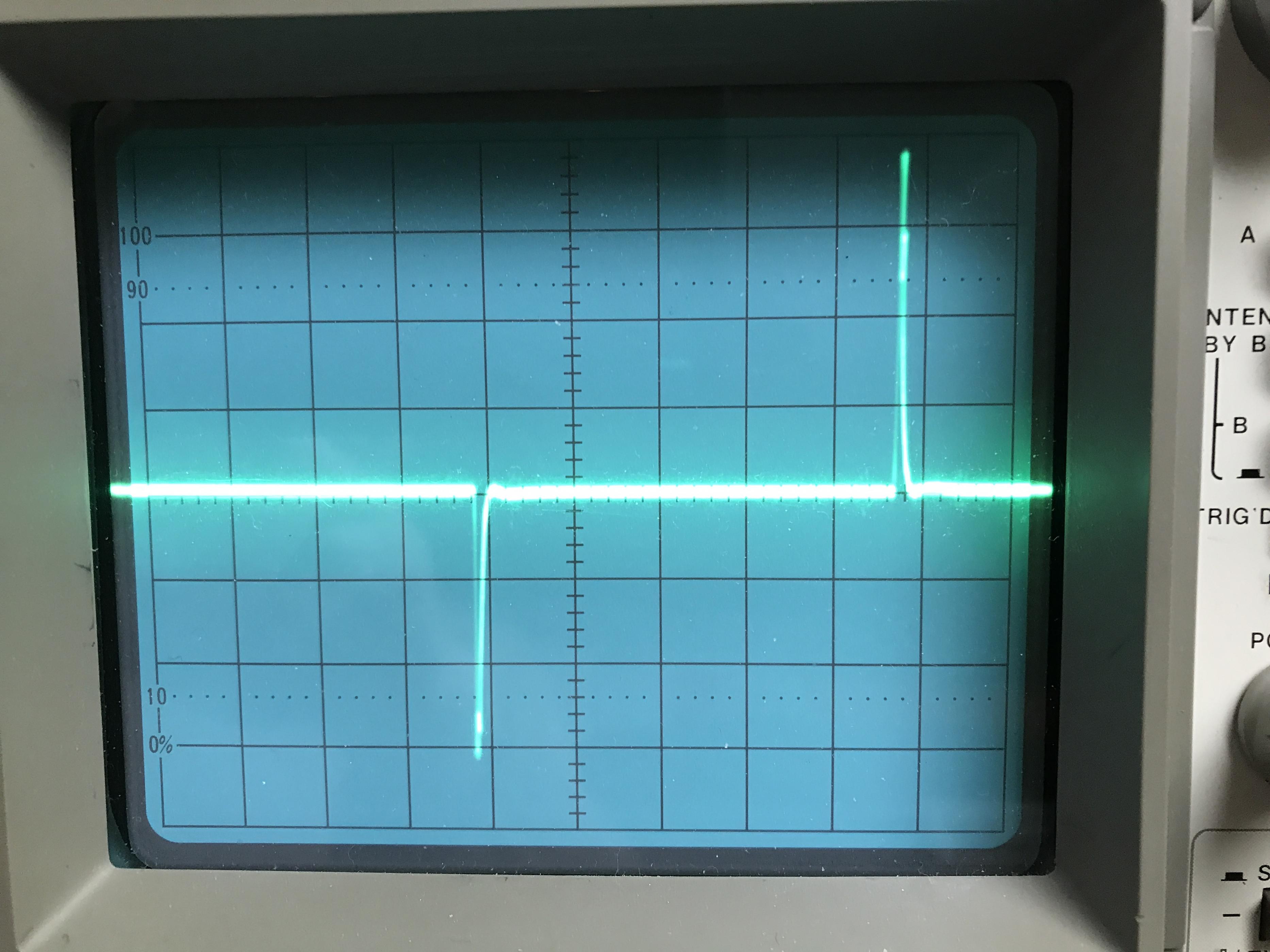

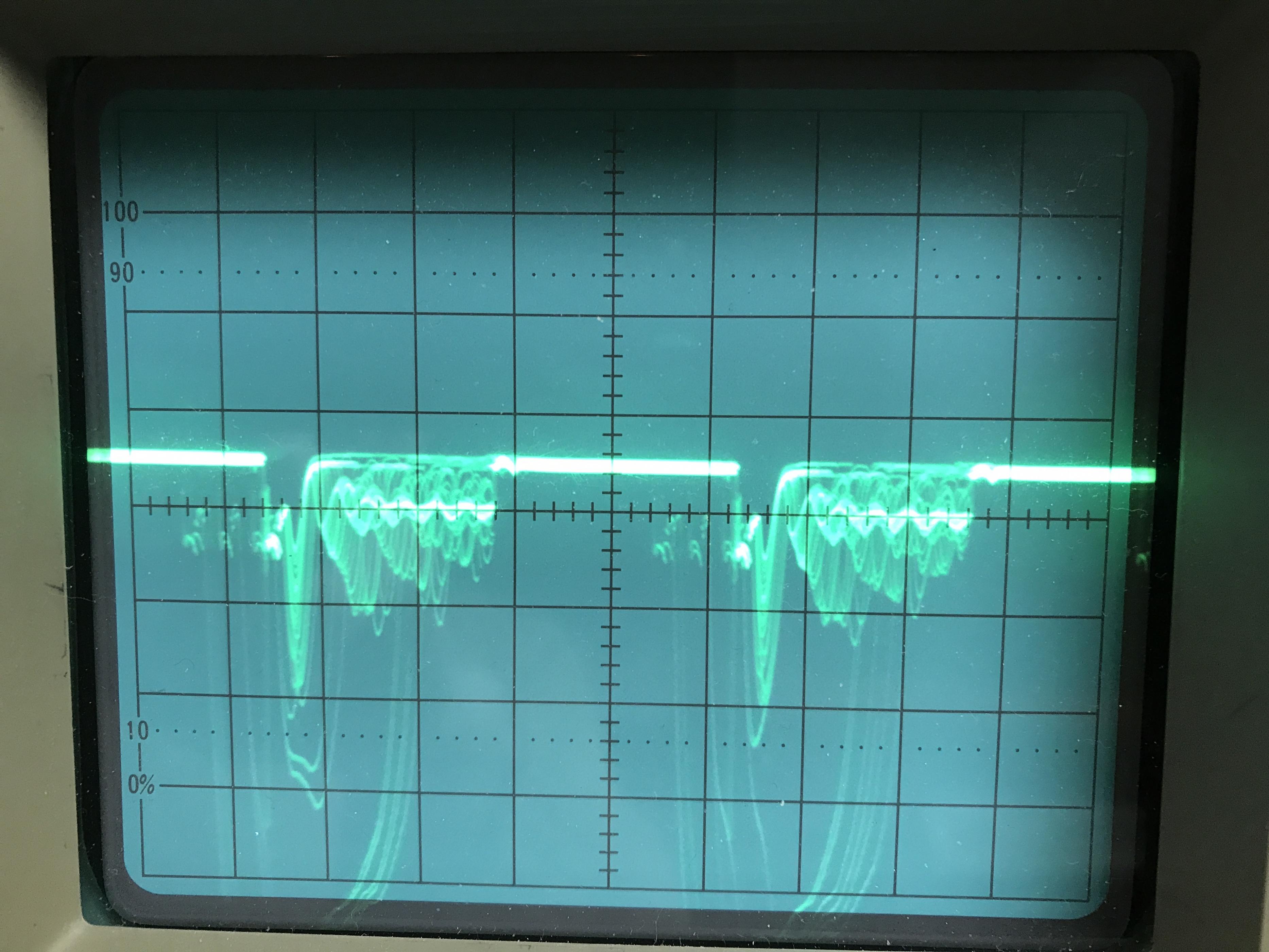

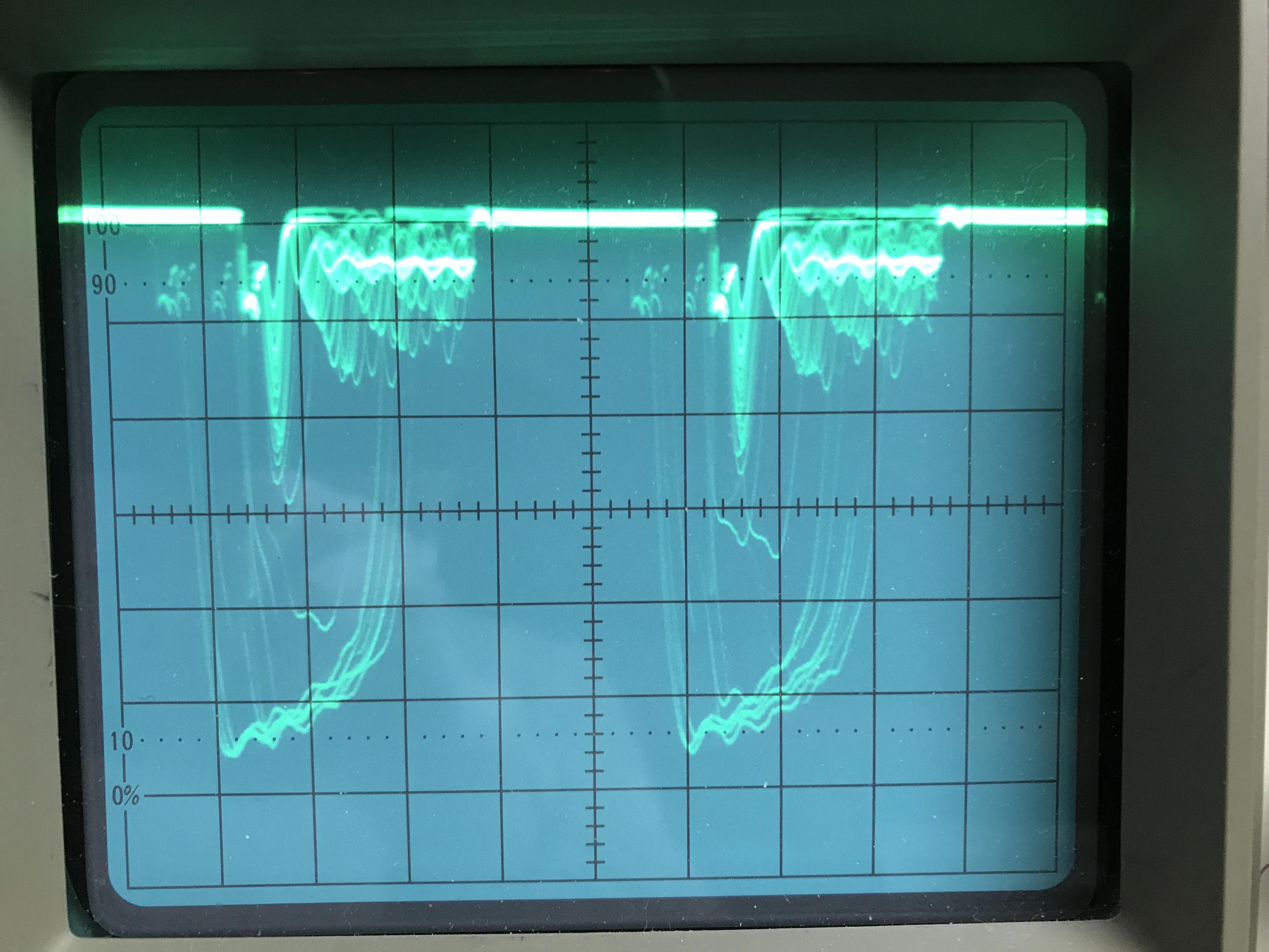

Scope traces from the VAS driver collector. All are 10 kHz square wave.
1 - 4 V out, 2 mV spikes
2 - 25 V out (safely below clipping), 50 mV spikes
3 - Hard clipping, spikes are 100 mV per division. I think the 0 V line is centered.
4 - Same but baseline moved up to show the bottom part of the spikes
