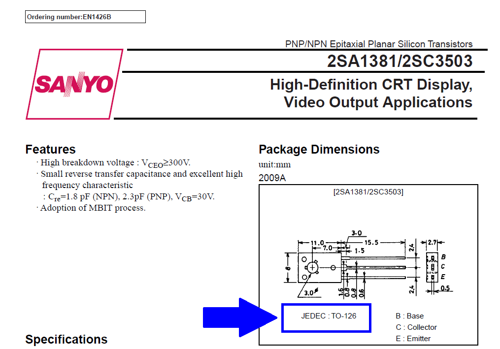

As it is I recently bought some 2SC3503's that should be genuine Sanyo transistors. But checking Sanyo's datasheet on this transistor it does not appear to have a metal backside for cooling - which the ones I have bought have (photo attached).
Might one of you confirm or dismiss that these are genuine Sanyo 2SC3503s?

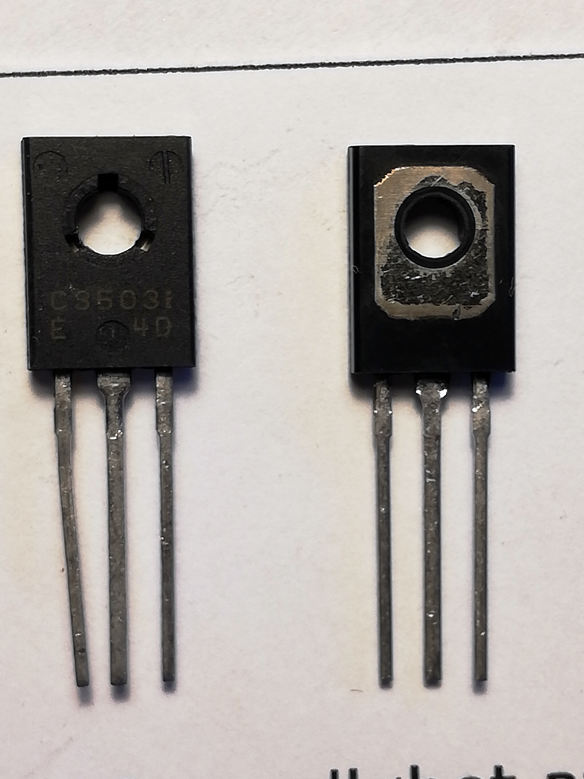

Hi,As it is I recently bought some 2SC3503's that should be genuine Sanyo transistors. But checking Sanyo's datasheet on this transistor it does not appear to have a metal backside for cooling - which the ones I have bought have (photo attached).
Funnily, i was looking at some youtube videos of fake IC's etc., and the picture indicates tinning of the leads of the transistor, which indicates that they may be fake components.
Did you purchase from ebay ?.

If you investing the to-126 package you will find that it has a metal plate. The KSC3503 is in a to-126ML package which is isolated and thicker. I bought some 2sc3503 from eBay polida that look to be genuine, the metal tabs are oxidized so show there age. I have yet to test them
Hi,I bought some 2sc3503 from eBay polida that look to be genuine, the metal tabs are oxidized so show there age. I have yet to test them

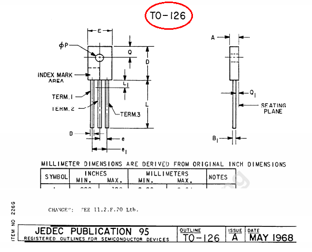

Fairchild should have said there package is not a true to-126 by Jedec definition and a variation to not cause this confusion

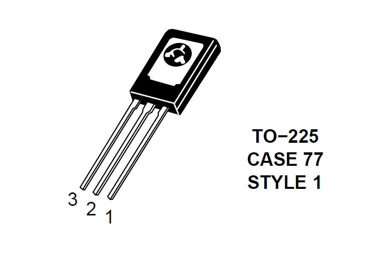

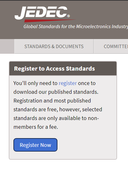

JEDEC standard package TO-126 has no metal tab for heatsinking. You are thinking of JEDEC standard package TO-225.
Fairchild's copycat parts KSC3503 are also packaged in TO-126.

Looks like the fakes I have bought years ago:

Yes I am confused. I do see that Sanyo has the thickness as 2.7mm & Fairchild has it as 3.05-3.45mm so they do not agree so who is correct? I know the to-126 heatsinks I am using are a PITA to put on the Fairchild package so I wonder if it meet the jedec outline. Can you post the complete Jedec spec for me to look at?
