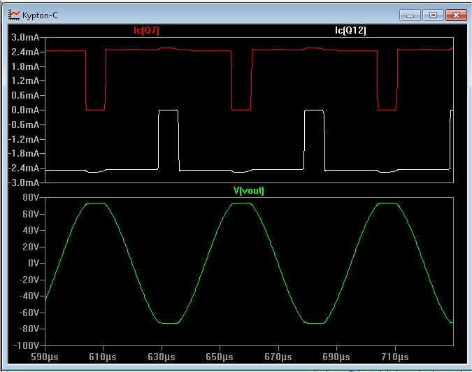

A complimentary VAS won't go class B on saturation .
I'll show (below) ....
-what a baxandall VAS does on clip.
Rounded like valves (tubes). Saturation is "clamped" (totally)
You say " it won't sound good" - but no worse than the 5% THD of
the loudspeaker. With this IPS , it's hard to tell when you are clipping -
short of a gross "hard clip".
Complimentary is also the same , just 2 LED CCS's. The only X-over
distortion is at the EF3.
BTW - with a level shifter , bob's IPS could run a symmetrical VAS ...
(luxman , many H/K amps).

They don't have to be complicated (below).
"What are the benefits" ?? OMG
10ppm - soft clipping - saturation is "tamed" - 150+v/us slew (even with a VFA).
- get this slew rate with 5ma VAS currents
I was a "LIN" fan up until a year ago - those days are gone.
Thermally, some of the complimentary's will cancel to the uA (VAS I).
PS- LIN is still good for "industrial" duty (subs /PA)
OS

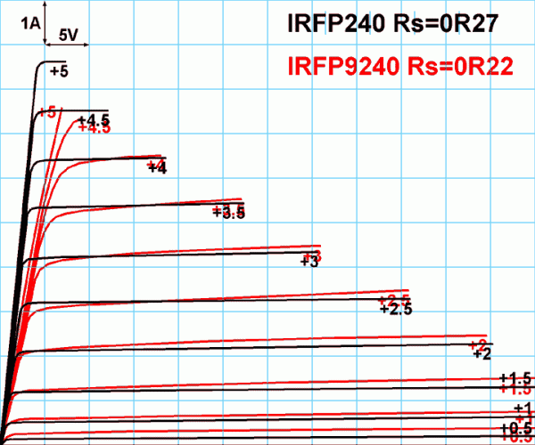

Hi Bob,
I am building a MOSFET amp with IRFP240/9240. I your book page 233, "Use of Source Resistors" you suggest to use dissimilar Source resistor to reduce crossover distortion, 0.15R for N-channel and 0.22R for P-channel mosfet.
Could you explain why you choose higher Source resistor for the P-channel mosfet, I would expect otherwise, lower Source resistor for the P-channel mosfet as it has lower Transcounductance. For example, Wishay IRFP240 min Transonductane is 6.9 S and for IRFP9240 it is 4.2 S.
One other thing I notice that your Spice models for those MOSFET have the Transconductance in reverse, IRFP240 Kp=4.8 and IRFP9240 Kp=9. Why so?
Best regards and Happy New Year
Damir
Hi Damir,
I'm sorry to be so slow in getting back to you. My wife has me looking for new carpeting, among a slew of other things. I have also been trying to finish my writeup of measurement results for resistor voltage-dependent distortion.
Its been awhile since I did those models, so I had to look up some old files to answer your question about the apparent reversal of Kp for the IRFP240 and IRFP9240 vertical MOSFETs. I believe those numbers are not reversed and are indeed correct. I realize it is non-intuitive for a P channel device to appear to have higher gm than an N channel device. However, I went back and even double-checked the IRF datasheets and it does appear that the IRFP9240 has greater gm than the IRFP240 at a given current. I re-simulated some of my device modeling SPICE test benches and it still seems to hang together.
Its been awhile, but I also seem to see that Kp by itself is not all there is to gm, and that the ratio of Kp of 2 devices in the model may not reflect the ratio of the gm of the 2 devices, both operating at the same drain current. Note that what is important is gm vs. Id.
Note also that tabular spec sheet numbers for minimum transconductance and not always all that useful, especially for evaluating SPICE models. I used actual IRF datasheet curves to make my models. I also did some lab measurements of individual devices.
I encourage others here to double check me on this. Errors are indeed possible and I always appreciate people pointing them out.
Bob

Hi Bob,
Thank you very much to be patient with me. What I am trying to decide where to use higher value Source resistor in N-channel or in P-channel mosfet to get better complementary behavior.
I have mosfets fro Vishay and the data sheet says:
for IRFP240 min forward Transonductance gfs is 6.9 S at VDS = 50 V, ID = 12 A
for IRFP9240 min forward Transconductance gfs is 4.2 S at VDS = - 50 V, ID = - 7.2 A
I am not sure how parameter Kp represents that.
Here is one example of the measurement taken with a tracer for the same mosfet types but produced by IR.
Best wishes in New Year
Damir
