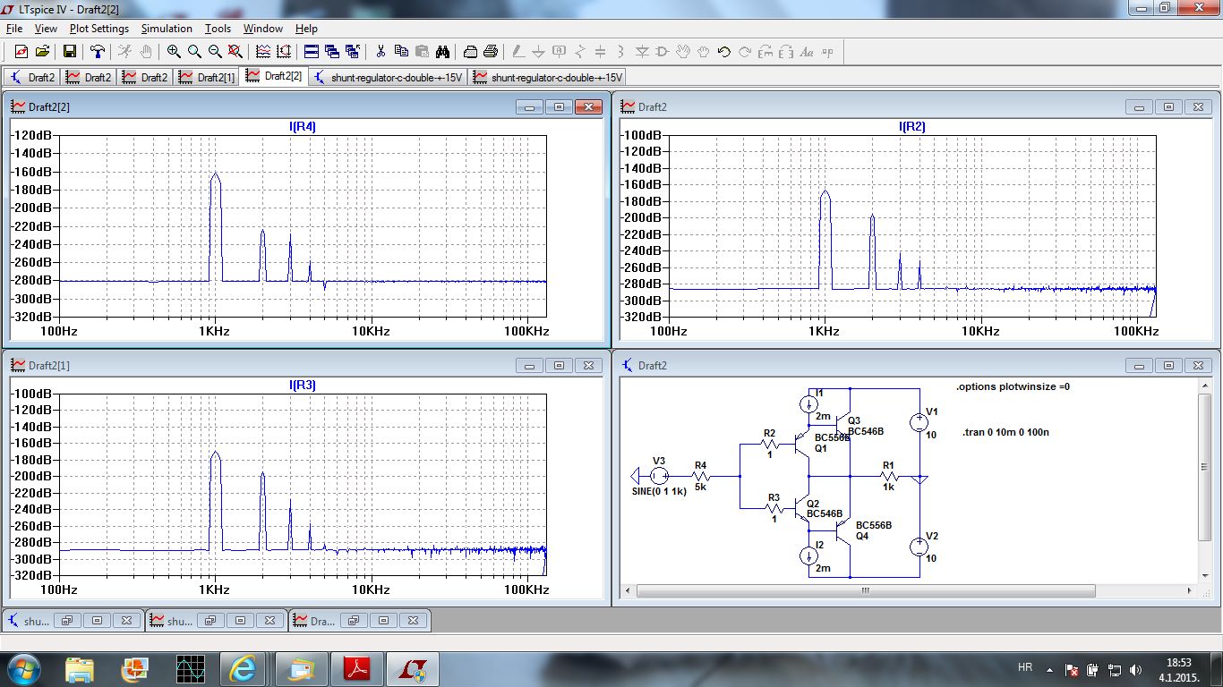

The input buffer is cascoded by the second pair of transistors which hold their Vce constant. Yes, it can be a Baxandall, cascode and buffer all in one. These names are all ideas, and they are not mutually exclusive.
You can check for yourself in the simulator. See the attached plot. Yes, the base current of one transistor is positive and the base current of the other transistor is negative. But they respond in phase to the AC input signal. When the input voltage rises, both bases draw more current. While the idle currents cancel because they are opposite phase (+ and -) the AC currents do not because they are in phase.
There is some kind of input current distortion cancelation.
Okay, that is a cancellation of the 2nd harmonic, not a cancellation of the total current. Notice that the fundamental behaves additively as I showed.
What happens if you use a few different BC5xx model? Does the H2 cancellation change much with transistor properties or stay basically the same?
