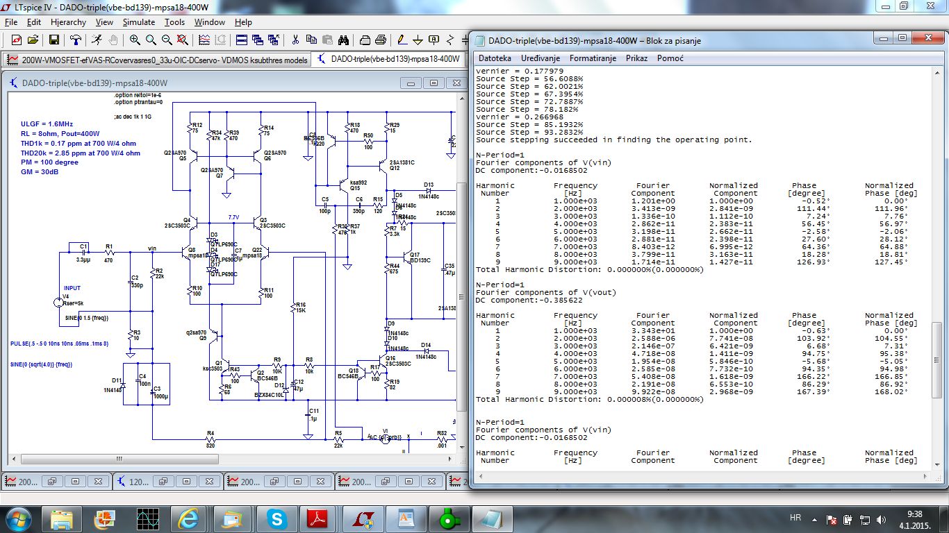

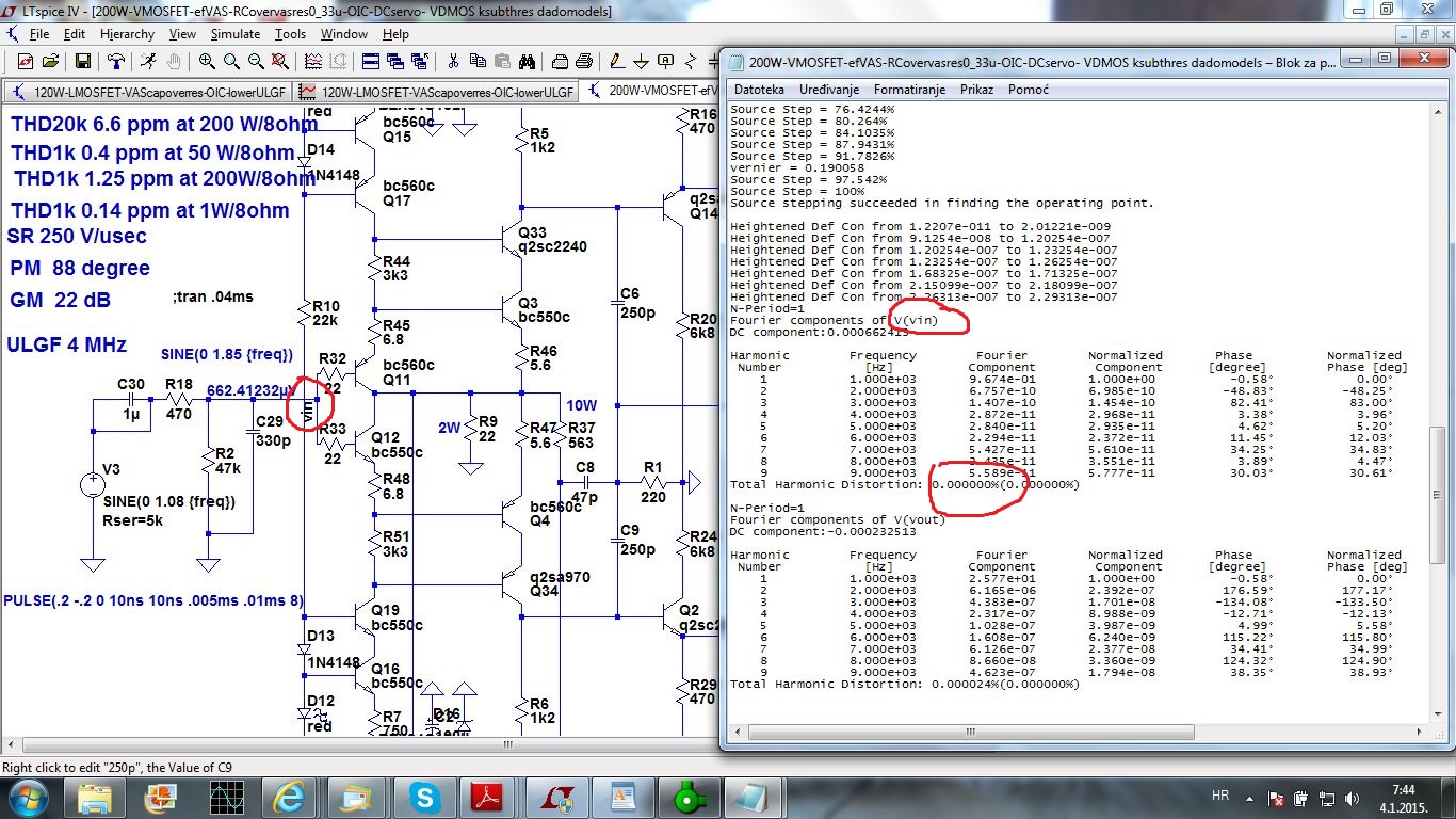

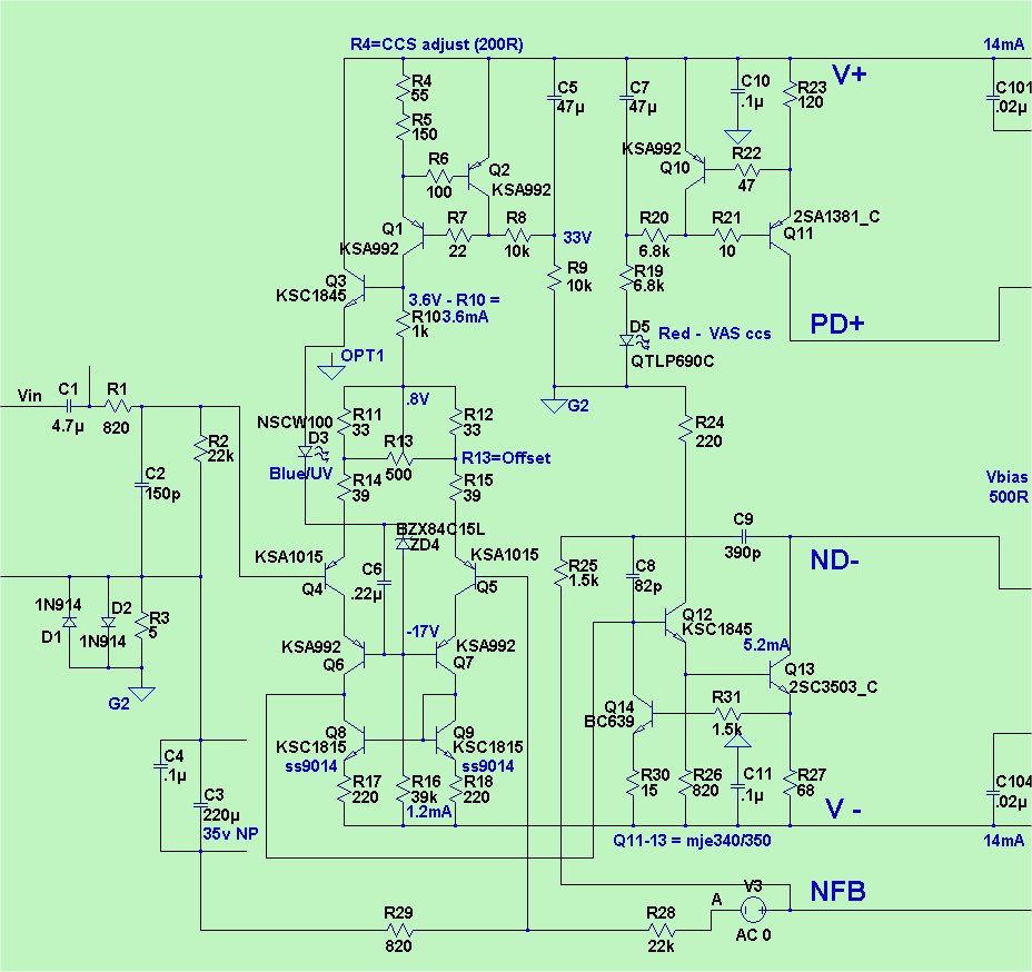

1 .... regularly 3-5ppm thd 20K. About the "bottom limit" with TMC compensation
and a full "blown" cascoded LTP. (below 1 - with BJT "clamp").
2. Yes , blown beta enhancement devices with too much saturation.
PS - Uh , huh .... I've blown one. 😱😱

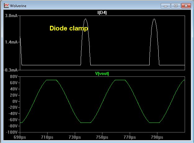

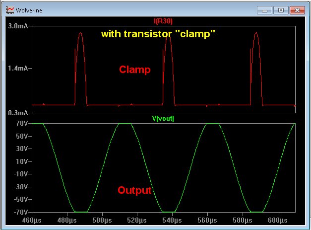

3. An example (below 2). Using the BJT (Q14) as clamp , some sort of saturation
induced oscillation on the negative clip. 🙁
Tried this on the real one - with TMC - a fast "chirp" of oscillation as the saturation
is clamped. 😕

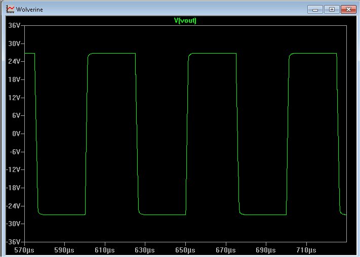

(Below 3 - diode) Just a fast diode between Q13 -C and Q12-B - no issue.
Notice I do get nearly symmetrical slew and clip ... 🙂
Short of overload , square wave response is not bad ( 4-close to symmetrical slew ).
So , there is a close example of the textbook amp .. . luckily ,both clamp options are
there.
Edit - this misbehavior must be addressed , the old japanese amps that DID
survive DID address this. Hey , this is not a "pinnae" amp , just a "working
man's" amp
OS

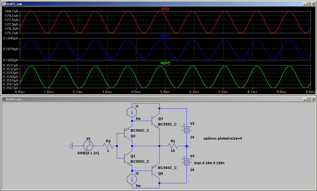

The base current only cancels at DC, if it cancels at all. It behaves almost exactly the same as it does in an LTP.

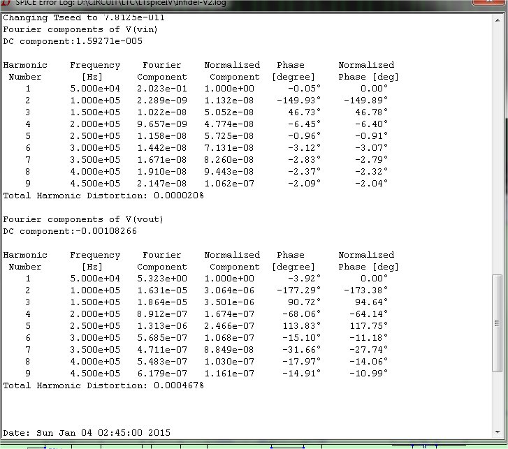

How you can explain this, simulated a LTP input (blameless) and complementary pnp/npn input (CFA)? The same source resistance, the same input filtar.

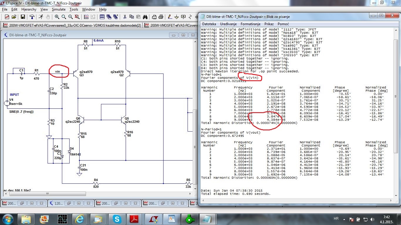

2nd confirmation - symmetrical TIS (below - diamond input).The LIN is not even close. 😱
PS - same "everything" as the LIN , 1000% performance.
EDIT - NOT a true CFA (OPA 660 that runs on 80v rails 😛 ) RF amp !
OS
as just a bit unfair - try bootstrap cascoding the VFA diff pair
Something like this? I did not say that I not possible to make better LTP.
That's cheating , try 50K. 😛
(horrible offset)
edit - and it can't do 1KV/us , either ...(35mhz OP device BJT limit)
OS

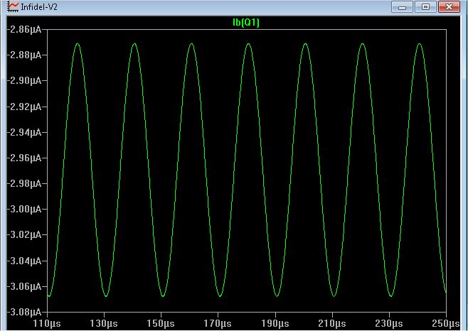

Yes, the Diamond inputs were cascoded in your first example. If you cascode the LTP the performance becomes much better. Furthermore, your diamond has buffers as input transistors. Your LTP doesn't have any buffers.
In the Diamond input, the base currents and junction capacitances are both loads on the input. They both draw current with positive input, and sink current with a negative input. They add, rather than cancel.
But the current is low (uA).

The idle currents cancel. The AC currents, which carry distortions, do not. Hence one way of reducing them is to cascode and/or buffer (exactly like Dadod's schematic). This applies for both LTP and Diamond.
Those input transistors are not a buffer, thy are supper pairs, and could be connected as a diamond with similar result. EDIT: OK it could be called a kind of a buffer, but that buffer is not cascoded.
When you say "In the Diamond input, the base currents and junction capacitances are both loads on the input. They both draw current with positive input, and sink current with a negative input" and those currents flow the same resistor(input filter resistor and source resistor) isn't it subtraction and thus cancelation?
The input buffer is cascoded by the second pair of transistors which hold their Vce constant. Yes, it can be a Baxandall, cascode and buffer all in one. These names are all ideas, and they are not mutually exclusive.
You can check for yourself in the simulator. See the attached plot. Yes, the base current of one transistor is positive and the base current of the other transistor is negative. But they respond in phase to the AC input signal. When the input voltage rises, both bases draw more current. While the idle currents cancel because they are opposite phase (+ and -) the AC currents do not because they are in phase.
Re stability of the cascode VAS: An old rule of thumb says that if you enclose more than 2 transistor stages in a feedback loop, the loop will need some sort of compensation. This has always been true in my experience. The cascode VAS has 3.
The problem with asymmetrical slew rates in the Lin topology is basically down to the CCS that loads the VAS being imperfect. Its output impedance falls at high frequencies. Self used positive feedback to counteract this. I found that with a 10mA CCS, and a VAS current limited to 20mA, the slew rates were reasonably symmetrical. However, replacing the CCS with another VAS is a nicer solution.
Ostripper, I split my last amp into driver and output stage boards in exactly the same way as you did. 🙂 The only difference is that I included the protection on the driver board, so I have 2 more connections for the emitter resistor voltages. I also used the diode you mentioned to fix the clipping behaviour of the beta-enhanced VAS.
