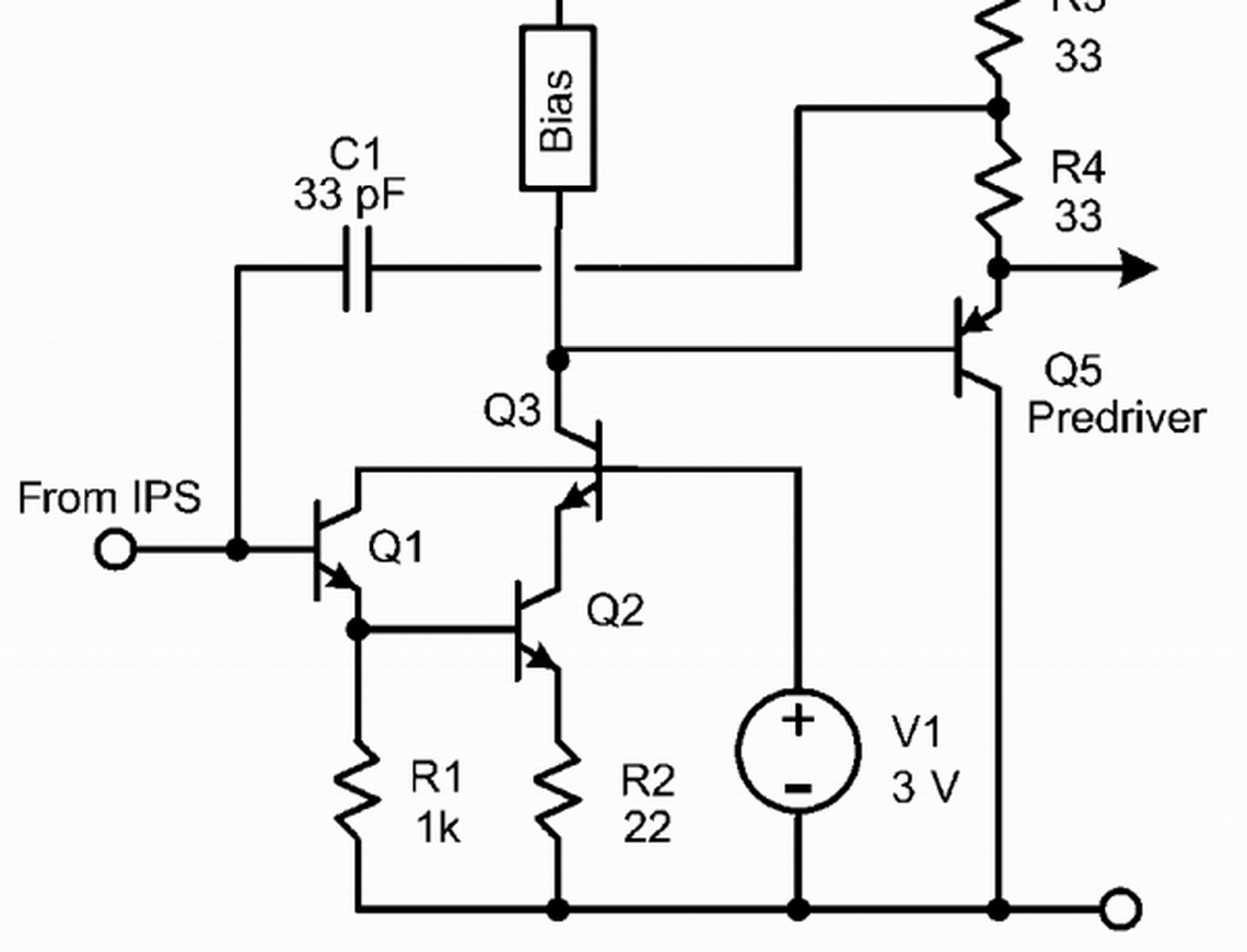

Don’t forget that, being common-base, cascodes are “fast”. If a configuration is stable (with healthy margins) without cascodes, adding them will probably be OK (but of course this should be checked!!). Adding an emitter follower is the most likely thing to adversely affect stability margins. In any case, the miller loop can be compensated fairly easily with a small resistor and capacitor.

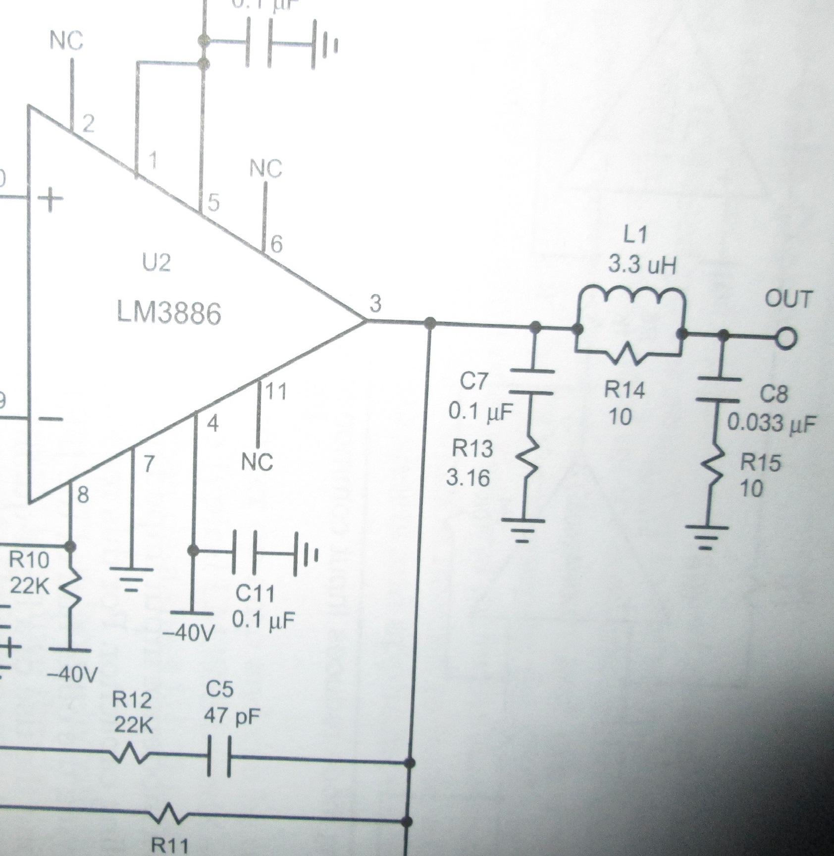

Hey guys,
Have you looked more at this circuit?
It's the extra output zobel at the speaker cable entrance to block RFI ingress:
Like his chipamp (pg 540 of Cordell's, Designing Audio Power Amplifiers, Fig 27.3 The Super Gain Clone Employing a DC Servo)
On pg 541, he writes:
"Output Network
The output network is a pi-section arrangement with Zobel networks on both sides of the L-R network. This provides enhanced resistance to RFI ingress via the speaker cables. The inductor is optionally constructed as an air-core toroid to keep the magnetic field circulating largely inside the toroid, reducing possible magnetic coupling to other circuits. The first Zobel, comprising C and R, is located close to the output of the LM3886. The L-R network and second Zobel are located close to the speaker output terminals, optionally on a small separate board. The output signal is carried from the main board to the output network board by about 6 in. of high-quality speaker cable."
Any formulas, simulations, analysis ... ?
Jeff

I posted an excel.xls that shows the Dr Cherry analysis of the Thiele Network a few years ago.
http://www.diyaudio.com/forums/solid-state/94029-when-output-inductor-needed.html#post1105724
I started looking at the Pi Network a few years after I read the original '97 article and now adopt regularly.

Hi Harry
Yes they are "fast" but I am not sure how much this helps.
My intuitive feel is that if we keep the outer loop return ratio the same then the added cascodes must push up the return ratio of the inner loop.
But this stuff isn't always intuitive so I have started to look at inner loop stability, as part of a study of Two Pole Compensation.
Do you have any references to work on inner loop stability?
Principles are the same of course, but plots of outer loop Return Ratio are so common that the inner loop looks "funny" by comparison.
Especially since it is often implicitly assumed that the inner loop has no poles at all.
Best wishes
David

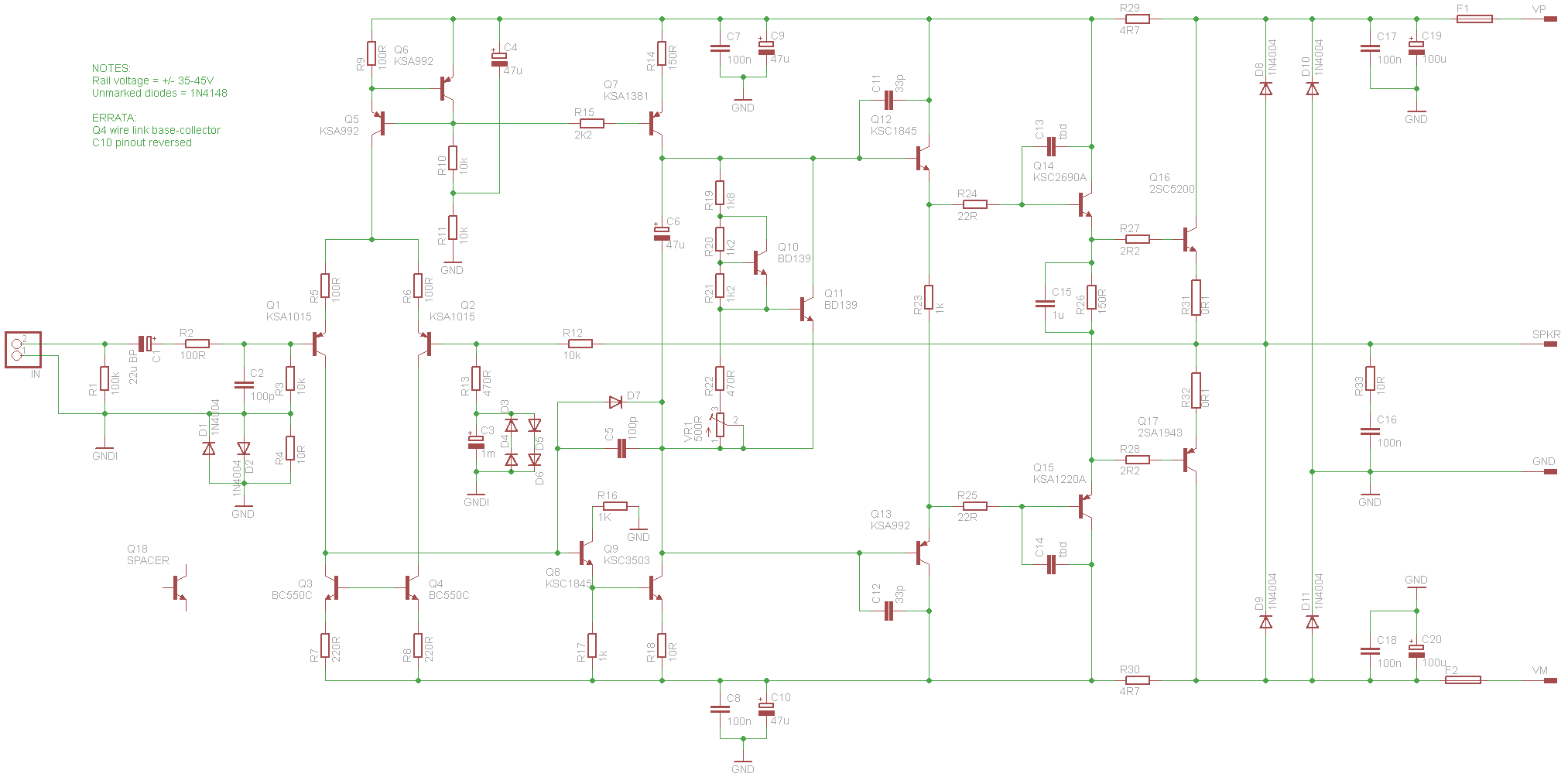

Hi Bonsai
I'm looking at your schematic now and see a 30 MHz driver with a B-C zobel @ ~6 MHz and a small base stopper. Can you explain how you arrived at these values or was it a case of trial and error.
I suspect I'm still getting some minor parasitic oscillation on my amp (the heatsink is warmer than I would expect) although I can't see anything obvious on the scope trace (a 100MHz Tek CRO).

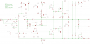

Hi Bob
The examples in your book (I'm referring to the schematics in Chapter 3 specifically) all feature very high LTP degeneration (470R emitter resistors) and a 1mA tail current, which is relatively low for a degenerated LTP.
Self on the other hand runs the LTP much hotter at approx 4mA and I suspect would run them even hotter if the packages permitted. He suggests 68-100 Re as a practical compromise between LTP linearity and voltage noise in the degen resisters at those currents.
Bonsai from these forums takes it to the extreme and runs the LTP super hot @ ~10mA
In my circuits I try to keep TO-92 Pd to < 100mW or thereabouts, since any higher and the device feels too hot to the touch. That correlates approximately with Self's examples.
Intuitively, I would think the tail current should be as high as practical (appropriately degenerated) to maximise drive into Cdom.
Can you shed any light on your philosophy?
Cheers
Christian
Hi Christian,
You have asked a very good question, and one that has obviously sparked some good discussion here. There are no black-and-white answers here, and many of the replies subsequent to your post are quite good.
Like many engineers, I have my own comfort-zone rules of thumb, and sometimes we do not venture outside these zones as much as we should dare.
That having been said, and particularly for the examples in Chapter 3, here is some of my rationale and sometimes slightly arbitrary choices. First, when in doubt with a CE BJT stage, I always like to use 10:1 degeneration. This gives good linearity. If I am running a transistor at 1mA, this means that re of the transistor will be about 26 ohms and the degeneration resistor will be about 260 ohms. Actually that is probably 11:1 degeneration in terms of gain reduction. I also like to keep Miller compensation capacitors in the range of 30pF plus or minus a factor of 2. I think I had 30pF in most instances in Chapter 3. The amplifiers in Chapter 3 usually had fairly conservative compensation with ULGF of about 500kHz. These personal rules of thumb of mine tend to work together with these various numbers.
Of course, whether we use a current mirror load on the IPS (which I usually do) influences this because it doubles the gm of the IPS. Also, the sweet spot for Cmiller is also influenced by whether a VAS is used that includes a Darlington (which I usually do). The Darlington VAS largely kills the nonlinear Cbc effect of the VAS transistor, permitting use of a smaller Miller comp capacitor.
This is admittedly somewhat arbitrary hand-waiving. I also shy away from passing a lot of current through an early stage when not needed.
A 2mA tail with each input transistor at 1mA provides peak current of 2mA into Cc if a current mirror is used. 2mA into a 30pF Cc yields 60V/us, a reasonable number for many amps, especially when it is achieved in a linear way, as with 10:1 degeneration.
If we want to go to higher ULGF and keep the same Cc, we will likely double the tail current and IPS gm to get to, say, 1MHz (rather than going down to 15pF for Cc. But this is just a judgment call.
Now to noise. This is indeed a possible objection to operating the IPS transistors at only 1mA and with a full 10:1 emitter degeneration. Some folks are obsessed with low noise, even in a case where signals are line-level. Don't get me wrong, I like low noise as well. IPS gm and degeneration do affect noise, including that which is input-referred from later stages like the VAS. I like to have a power amplifier input noise below 10nV/rt Hz, and consider 5 nV/rt Hz to be really good. If you look at the sub-section labeled "Noise of a degenerated LTP on page 152 you'll see some back-of-the-envelope numbers that show that a 2mA tail and 10:1 degeneration delivers about 5nV/rt Hz without considering later stages.
I guess the bottom line is that in the kinds of designs I do, I don't see much important advantage of running the IPS hotter than a tail of 2mA in designs with ULGF in the 500kHz - 1MHz range. Running the IPS hotter doesn't hurt, especially in amps with higher ULGF or SR targets as long as impedances in the base circuits of the IPS are kept reasonably low so that base current noise does not begin to intrude too much.
Note also that in some amplifier arrangements operating the IPS at higher currents without using high-beta transistors may make the DC servo have to work harder, even in the case of matched transistors.
Bob
Hi Harry
Sorry, I should have been clearer that I meant that if you take an inner loop that is “healthily” stable and add cascode stages to it, it will probably still be stable afterwards (as these added common-base stages will be faster than other stages so add their additional phase lag beyond the crossover frequency of the loop). However, the margins of the inner loop do sometimes tend not to be so healthy, probably because not everyone thinks to check or know how to do it!
You are correct though that adding cascodes to the design could also affect the global/main loop so there is some interaction here. My preferred method is to compensate the global loop for ULGF in the region 1 - 2 MHz (using fast transistors throughout), and then compensate the inner loop. I suppose that a full algebraic analysis would allow co-optimisation of the global and inner loops but I’m really not sure if doing so is worth the effort - it’s unlikely that this would yield significantly better overall performance of the finished design.
You have been studying this for quite some time! Are you going to write a book/thesis/paper/article?
No. Op-amp design literature would be a good place to look.
That’s because there’s no feedback at DC (global loop handles that). There’s also the possibility of the dreaded right-hand-plane zero (yuck!).

Hi Bonsai
Refering to the Ovation 250 schema, I used 4R7 stoppers in the bases of the 21193/4 power devices (note they are not shown in the schematic but they are fitted). In the base of the driver I used a 27 Ohm resistor and a 1nF cap to ground as showm.
The pre-drivers have 100 Ohm base stoppers.
I had no instability issues with this set up and spent many hours testing it.
What I found (this is in 2006) was that I could not remove the driver RC networks. Doing this always guaranteed oscillation.
The 4R7 resistors could be removed (linked out) and the amplifer remained parasitic free - but I left these in for additional safety.
It is also quite acceptable, and probably easier, to run the RC caps to the supply rails as you have done in your schema provided the supply is low impedance and well decoupled.
On the Ovation 250, I got the dreaded parasitic oscillation on the prototype and some research on the web at the time lead me to a Microcap application note that described the cure for negative input impedance of emitter followers - which is the prime cause of instability in most cases. The values were obtained through trial an error and I got good results with 27 Ohms+ 470pF, but in the end settled on 27 Ohms+1nF which I felt was a good safety margin. You can of course model this - there are a few slides on my website covering 'cascode oscillation' - the mechanisms are similar.
In the e-Amp, which uses fast 30 MHz devices, I've gone with Bob's advice on decoupling, base stoppers etc per his book and have gotten very good results - no parasitics. The risks of oscillation with the faster devices are of course much greater - so layout (short tracks between stoppers and their associated devices) good local decoupling and isolating RC networks between the pre-driver and driver stages are mandatory. You can see the details on the e-Amp schematic.
As a general point, I think EF2 is ok up to 100W and I've gotten very good sonic results on the nx-Amp although Bob will probably say thats a bit too high for an EF2.
Re your parasitic oscillation, can you tell us what frequency, or better still post a picture up? IIRC on the Ovation 250, it was abouy 5~10V pk-pk ruding on the input signal and at a few MHz.

Please Bob, i am facing some troubles related the 33pf capacitor in your cascode VAS
At the first moment i have imagined the tripple darlington was the issue..then i have removed the first from the three stages, re adjusted the floating emitter resistor to 220 with the output back to EF double darlington..
I cannot reduce this capacitor below 130pF without face oscilations...with three stages at the output, with two stages and tried even with a single stage... please, confirm this value.... and....if you wish, tell a little bit more about this circuit.... i know it was made to "see" higher impedance.
I have readed your excellent book, but sadly the circuit i chose to try if driving me crazy.
I have used a very modified circuit into the Mark One...but even this way the circuit is unable to work with 33pf..... less than 130pf it starts to oscilate.... wave form becomes an amplitude modulated carrier with some few Megahertz in the carrier.
Circuit really reduces distortion but square wave form resulted very bad....not a good slew rate...raise time no good.
Is this 30pf just a reference?
Thank you,
regards,
Carlos
