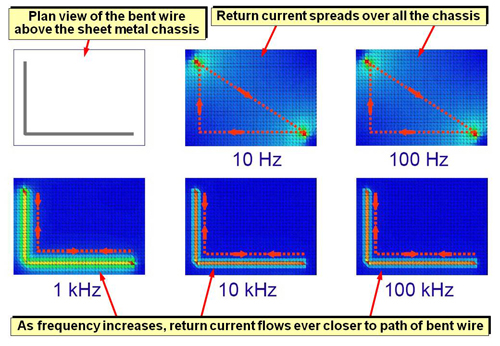

Think about the corner frequency between the mutual inductance and the resistance of the ground plane. Depending on the thickness of the copper it can be in or above the audio range.
When there is very little mutual inductance and total inductance is >> resistance, I would expect the current path to become thinner and straighter, although I may be totally wrong about that since I know there are things about currents sticking to edges and holes in the plane.
True and well within audio frequencies.
THx-RNMarsh
Yes, we have a beautiful experimental demonstration of this in a professional development EMI course that we present at our university.
A long, L-shaped trace is on the top layer of a pcb, driven at one end, with the other end terminated to the ground plane, and the return current
in the ground plane is made visible.
Below about 1kHz, the ground plane return current goes directly from the terminated end of the L to the source ground diagonally, in the path of least resistance.
At higher frequencies, the current flows directly under the arms of the L, tracing out its shape faithfully, in the path of least inductance.

Such as this -->
THx-RNMarsh
Such as this -->
THx-RNMarsh
Yes, this is very similar to our EMI course demonstration, using a pcb trace over a ground plane, and with the same frequency behavior.
