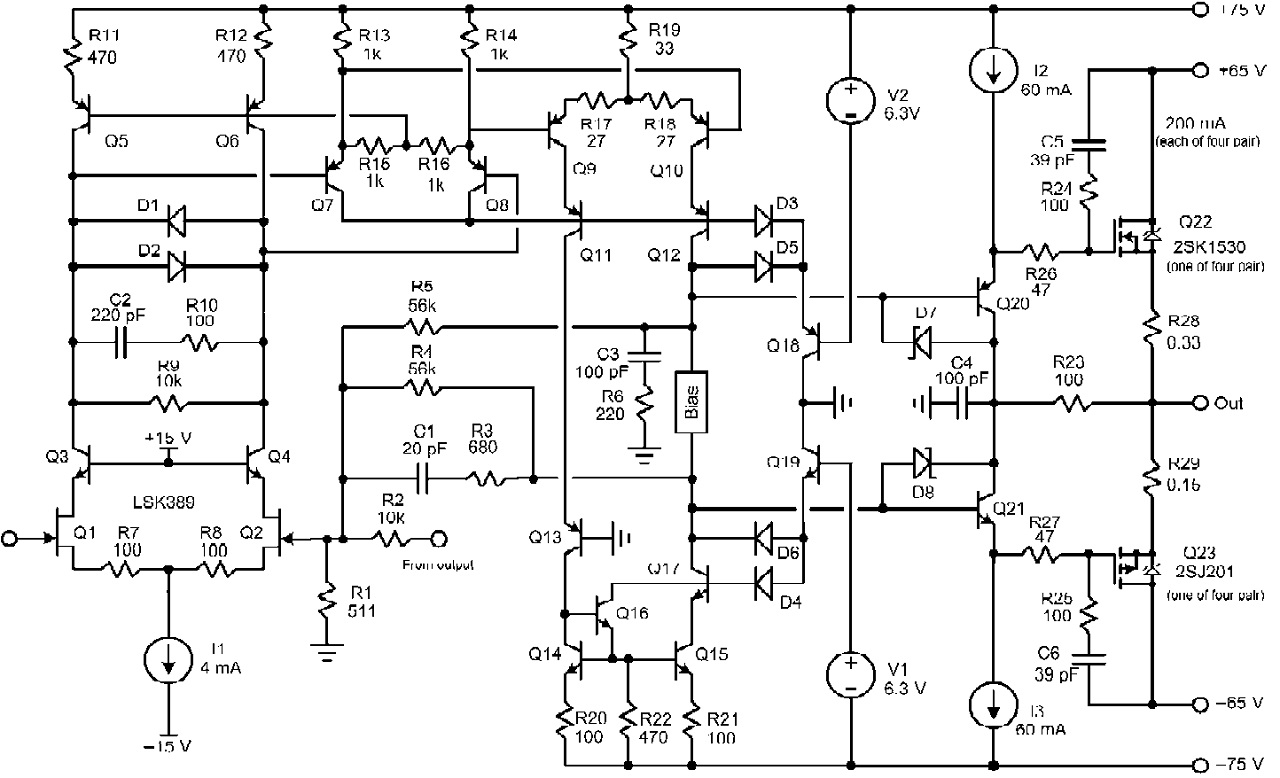

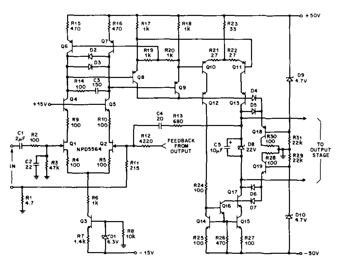

Fig. 22.15 in your book (p. 525) ''A MOSFET feedback amplifier with 40-kHz open-loop bandwidth.'', it look seem you've used Miller Input Compensation technique. But compensation cap connect from Bot (neg. drv to output stage) to input.
This is different with your 50W MOSFET amplifier in 1984, the compensation cap from Top (pos. drv) and to input.

Hi Bob,
Hope you are enjoying your retirement.
I was wondering if you would like to like to comment on the Sansui diamond configuration, as used in the Sansui AU-X1 and others.
In particular is it a good topology, pitfalls, enhancements, the compensation method used etc. I have simulated the design somewhat and have posted the ltspice .asc file in another thread.
http://www.diyaudio.com/forums/soli...ifferential-pa-simulation-possible-build.html
I have heard that the amp has been known to oscillate, so I was wondering why that was so. I think it is the compensation, so I was wondering if you can confirm to change C11,12 to be a around 6pF or what ever else you determine. It actually helps the square wave response overshoot and the phase response, but the slew rate slows and the distortion goes up.
I see there is about 150 degrees of phase at 0dB which seems to be on the hairy edge in my mind? Is there a way to improve the phase?
I tried LSK389B and NXP BF862 jfets and they both seem to perform well as subs to the original 2sk129 pair.
I think if you have a good impression for this amp, I may do a layout/build for it and test it out.
If anything, it is fun learning a bit more about ltspice and figuring out why the designer made the choices that they did.

Hi Rick,
This is an interesting amplifier. It is an example of a design where a unipolar JFET input stage is used in an amplifier with a push-pull VAS. I generally like such amplifiers, since I like JFET inputs and only good N channel duals are available. The key in such designs is how the output of the N-channel JFET pair is converted to signals that can drive the positive and negative VAS transistors.
In this design Sansui has effectively added another stage between the IPS and the VAS transistors. This contributes gain, but also phase lag.
It looks like each VAS transistor has a bit of Miller compensation around it, with rather small-value capacitors less than 5pF. I usually cringe at the use of such small-value capacitors. It also looks like a bit of Miller Input Compensation is used, again with uncomfortably small-value capacitors. Finally, it looks like there is a bit of shunt lag-lead compensation to stabilize the MIC loop.
Such a design may depend a lot on the characteristics of the transistors used. So substitutions and accurate models may be an issue. My overall impression is that this may be a design that is more complex than needed and one that may be cutting it too close on compensation.

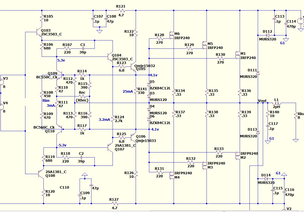

Hi Bob,
I sim'd Figure 7.13 today and got it going okay with a standard triple output as you are using in other figures. Seems to perform as well or better than the Sansui diamond design.
I understand your reasoning for not releasing or at least controlling who gets proprietary information (IP).
What is your policy with regard to me posting the .asc file as drawn in Figure 7.13 of your book, in this thread?

Hi Bob,
Okay, per you permission, I will post a working LTspice sim of Figure 7.13.
Now, if I was to design a pcb of this ckt, what are your conditions as far as releasing that to the general public? I mean offer a pcb, maybe the gerber/drill/fab data. I guess I would like to know the bounds of your IP? Something that could be stated up front in your book as well!
The figure 7.13 design, as I have captured it, has inherent around 7mV of DC offset (which in itself seems acceptable), but in reality, I am sure it is a lot more, due to component mis-matches, so to null it out, one needs either a servo or a pot to trim it out. Any suggestions to follow?
If possible, maybe you can comment on the baker clamp, bias spreader and any other enhancements/improvements to make this design something that can be a finished/working design.
I guess by your lack of response that you are not adverse to working with me on a real design, that could be offered to the DIY community at large? I take no offense, if you chose to work alone , keep it the way it is or work with someone else.
My aim is to prove to Doug Self and others that your work can/does represent real working designs. I understand that you do not need to prove anything, as you have done it over and over again, but I think myself and many others would like to have a working design to use and that you bless or endorse. I realize that there there are many designs to chose from, so that is a problem to sort out. If one can make the design as universal as possible, stuffing options, then at least that opens up the field. I do relaize that taking figure 7.13 and re-arranging it to be a standard lin design is not very possible, but to say use MOSFETs instead of bjt's for o/p's maybe a possibility.
So see attached the Ltspice ".asc" file of figure 7.13. I have posted my sim library previously in the Sansui thread to make it convenient.

Hi Rick,
I have no problem with you making a PCB incorporating the circuit that is available to the general public for DIY use. I like the circuit and it would be flattering. As long as I get some credit for it and it works well, I'm happy.
I'm sure the circuit can be refined, of course. Moreover, a good complete amp takes more than just a good IPS/VAS.
Regarding the offset, I always recommend the use of a dc servo.
There is no need to convince Doug Self of anything, and those efforts are usually fruitless anyway 🙂.
I'll try to help by answering questions and offering advice here and there, but I often have trouble finding the time to get deeply involved.

LSk489 app note,figure 11, what spice model to use?
Anyone out there?
I read the Linear Systems app note on using the LSK489 = well done, lots to play with. I entered the design, figure 11 into LTspice and will post the schematic for others) to use and comment.
I added the input stage cascode, as an option, so that I could compare with LSK389 and BF862 jfets. It can be bypassed, when i find the correct lsk489 jfet model to use.
What spice model do I use for the LSK489?
I downloaded the set from the mfg web site and not sure exactly which one to use,JF201(_1),(_3),(_5),LS843(A),(B),(C)? I guess I could sim the models and compare to the data sheet, but I'll see what anyone else has to say.
Thx
Rick
Anyone out there?
Thx
Rick
Anyone out there?
Thx
Rick
Hi Rick,
The SPICE model for the LSK489 is the same as for the LS844. The LSK489 is essentially a lower-noise version of the LS844. Use the JF201 or the LS844 model on my site.

I would like to ask about your version of the HEC OPS.
You state "Q22 is mounted on the main heatsink for thermal feedback".
(below) is my simulation. (your Q22 is Q109 below)
Would not BOTH Q109/110 be used as thermal feedback ?
The other example of HEC (SYN08's) The output stage uses LFET's (negative coeff.)
and does not need this.
Another option would be to not use the HEC devices as such and
use a typical simple bias spreader at the OPS input.
Even as I have manipulated some currents/values , the below
simulation works as advertised. The HEC FB adjustments performed
just as your article said they would.
Fine tuning of Rhec (on schema) gave me .02% THD20 at high power.
...It's amazing how the most non-linear (IRFPxxx) of the 3 output device types (VFET/LFET/BJT) ,
can match or exceed a BJT EF3 OPS with this enhancement.
OS
