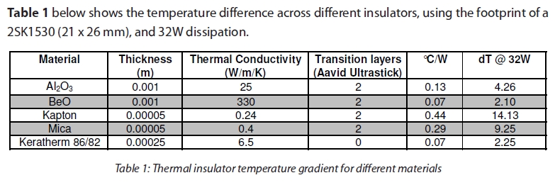

Any one know a lower thermal resistance product?
Best wishes
David
Table 1 from EUVL's Linear Audio Vol 3 article.
Know your literature ;)
Jan
All you need is a thin film to use as a spacer between the transistor and heatsink. You'll just have to look for thin films around the shop with a micrometer, unless you're willing to buy something online. I found that wax paper had a thickness of 1mil, but that's a pretty questionable material for heatsink interfacing. I never would have thought so, but heavy duty aluminum foil has a thickness of 0.75mil. So I cut out a very small foil washer to fit within the plastic ring around the screw hole in the TO-247 type package. Depending on the transistor package, it may be more convenient to put the foil in other places, for instance in strips along the top and bottom providing those parts are plastic.
I wouldn't try this with an uneven heatsink (or one with deformed screwholes), and I found most of my heatsinks weren't very even when held up to the light to inspect the gap. TO-247 would be most workable for deformed heatsinks since the top and bottom are plastic and it can be supported by foil strips around the edges rather than a washer around the screw.

Not sure if you get the concept of "thick" or "hard" anodizing. That's much different from the usual aluminum coating, see the Anodizing Reference Guide. Oxide layers are orders of magnitude thicker and harder than type I or type II. If you can get such hard anodizing for cheap, then definitely use it - and don't forget to post some pictures. You can hope to get a 0.2 C/W improvement in the Rthc-r over the standard greased mica or thin kapton sheet. That would help with a 5-8 degrees case and junction temperature reduction.
Adding another pair to your existing n output devices pairs will lower the junction temperature with as much as P*(Rthj-c + Rthc-r)/(n+1). For say five pairs of output devices (n=5), adding another pair would help as much as a 0.15-0.2 C/W reduction in Rthc-r. That would be about as much as switching from washers to hard anodizing, and if you think this is worth the cost, then again, so be it. But I'm afraid you are as concerned about the heat sink washers as about RHPs in audio amplifiers :scratch2:.
Funny enough (but intuitive if you think it through) lowering the case to heat sink thermal resistance is much more efficient in keeping the junctions cooler for only one or two output pairs.

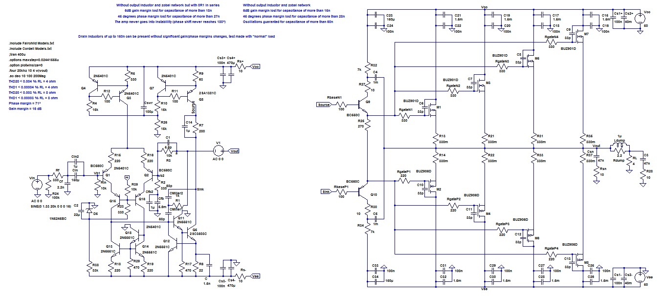

Hi everyone and sorry for talking about a different matter,
I'm interested in making an amplifier using beta enhanced VAS + cascode, but I was warned by a friend, that said me that it was a discussion between Michael Kiwanuka and Bob Cordell, and it was proved that this topology is locally unstable. I've made the simulations following Michael Kiwanuka's instructions present in his .asc file and I've got the same results 192 degrees of phase shift at 0dB, I've changed this circuit to look a little more like the ones present in Bob's book and I have something between 170-175 at 0 dB which is really bad news :(
Removing the cascode I still have 166 degrees phase shift at 0 dB, which isn't good enough for me.
What do you think?
Beta enhanced VAS isn't that good?
I've made some experiments and I've noticed that adding base stopper resistors to the EFs seems to help reducing this phase shift problem, but could have other problems, the values should be calculated taking in account cpi(cbe) and cmiu(cbc), and then using 1/(2*pi*Cin*fmax), I've used the following fmax values, 10 MHz for the first EF, 2 MHz for the second, and 1 MHz for the output devices.
I Don't know if this solves the problem, but I think that maybe it's only encovering it. With 2SC/2SA as drivers it's almost impossible to have a low phase shift.
I will post the test circuits latter, and I will also test the effects with mosfets outputs.
Can anyone help me here?
I don't know almost anything about local stabillity.
Thank you very much for your attention,
Best regards,
Daniel

Hi Daniel,
Try simulating one of the amplifiers in Chapter 3 of my book using my models. If you poke around in it in an ac simulation I don't think you will find any evidence of instability. Simulate out to 100 MHz closed loop and probe internal nodes, looking for suspicious peaks or dips. Similarly, do a transient simulation with a very low-level non-bandlimited squarewave (avoid slewing) and look for signs of ringing.
Bob

Hi everyone,
Thank you all for your help,
In the amplifier that I'm projecting I've good phase/gain margins, but I've never tested the internal nodes to check for local stability, how this can be made, I've read the section of your book where you talk about that, you say that the internal node should be tested with a signal injected by a voltage source thru a 10Mohm resistor, but using this procedure and probing this same node I've strange results.
Can you explain to me better how to test the internal nodes to evaluate local stability? Please?
I've a doubt, what happens if an amplifier is globally stable, due to high frequency roll-offs like gate/base stopper resistors at the OPS and capacitors or zobel networks from gate to drain (base to collector), and it has local instability, for example in the VAS, this can lead to some kind of problem? What can go wrong? The amplifier could be destroyed?

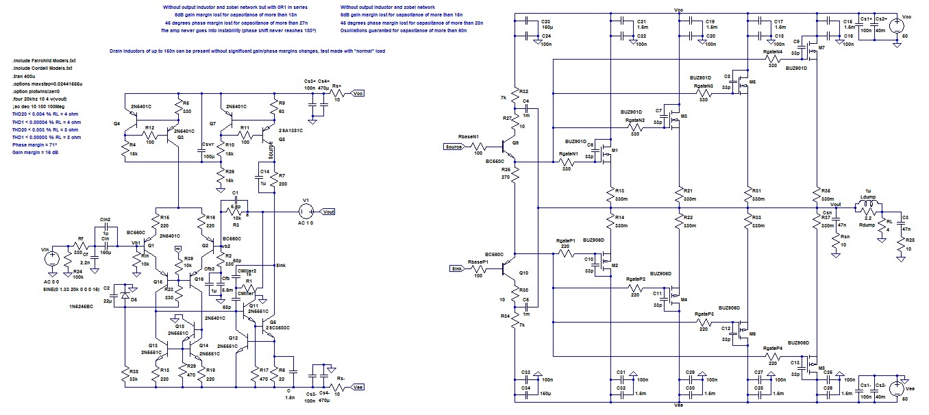

Attached to this post is a picture of the circuit, LTSpice circuit (.asc file) and your models including the lateral MOSFET output devices.
This amplifier is based on the amplifiers present in your book, and in designs like the Honey Badger by Peter V (ostripper) and astx (some ideas from his amplifier with the double EF stage), mcd99uk is also now helping me with some questions related to this design, I've learned lots of tricks, and I've made lots of improvements to my design with his help ;)
Attached is a figure of my circuit with and without the cascode at the VAS, the LTSpice (.asc files) and the your models with the lateral MOSFETs models included.
If you are interested in know more about the amplifier that I'm projecting, the thread associated to it is "How to make a low distortion lateral MOSFET amplifier?".
Best regards,
Daniel
