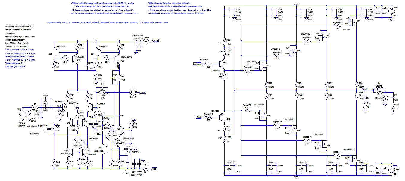

I'm sorry,
I've posted two pictures of the same circuit.
This is the one with cascoded VAS, I think I have lower THD1 because I'm using a BC550C (when using the cascode) as the main VAS transistor, which has lower noise/distortion figures. But as the cascoded beta enhanced VAS can be unstable, I think I'm going for the beta enhanced VAS like mcd99uk suggested.
I'm sorry for talking about my project in this thread, I only want to know how to evaluate local stability. Can you help me?

Minor loop stability is something I'm struggling with too. I have figured that the tian probe needs to used but can't fathom how to isolate the loops I want to test.
I find it effective to draw a simple block level schematic of the circuit to work out exactly what loop you want to probe. It's easier to be think clearly at this level about what you want to do.
Then the trick is to think about how to correctly place the Tian probe in the LTSpice ASC to examine that specific loop.
Correct placement means you should not have to "isolate" the loop with enormous inductors or capacitors, their use is both inaccurate and also prone to actual mistakes.
The Tian probe itself calculates and allows for forward and back transmission, so placement rather than attempted isolation is the key.
Is that helpful or too "hand wavy"?

Hi David,
I shall try this method of drawing a block diagram. It may help starting at the top level.
I am beginning to see these circuits these days as a mass of meshes. (Yes, I am slowly digesting the bode text you suggested studying) The trouble is I see loops affecting other loops and this is where my confusion starts.
I figured placement was important but where to place it is also something that confuses me. Even trying to analyse TMC is problematic.
Thank you for any help.
Paul

... The trouble is I see loops affecting other loops and this is where my confusion starts.
Bode himself understood this problem and solved it with the concept of Return Ratio.
This is a property defined at each node.
It is equivalent to Loop Gain for the case of a simple loop but is cleverly independent of any assumptions about loop structure, so is still clearly defined even if the loops are tangled.

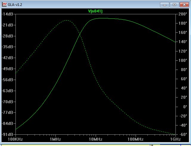

What is the mechanism which allows an oscillator put on the speaker output terminals to get back to the VAS input? [besides low output Z]
And, second, what is the best way to minimize (attenuate?) this? Is it thru greater isolation and how?

Hi Richard,
Sorry to be slow in getting back to you on this. I assume you're talking about signals that get somehow injected onto the output terminals getting back to the VAS, such as EMI or speaker EMF. I'm also guessing that you are primarily thinking about the path via the NFB loop and through the input stage. This is the concern most often talked about, and it is often even more in the context of disturbing the input stage. I believe that JFET input stages are superior in being resistant to these effects.
Anyway, in most cases the mechanism is through the NFB, especially if there is a lead capacitor across the feedback resistor. Also, most often we are talking about stuff getting fed back at higher frequencies.
It is true that there are other ways in which EMI injected at the output can get possibly do bad things, and possibly get back to the VAS. For example, the output stage has very finite ability to isolate the VAS output node from the amplifier output due to the finite current gain of the output stage. Triples most certainly help this a lot at audio frequencies, but are also limited in current gain and isolation at high frequencies.
In principle, it is also possible that some stuff at the amplifier output can make its way back to the VAS via the compensation capacitors in a TMC arrangement through the TMC resistor.
Finally, and not directly involving the VAS, HF currents flowing into the output of the amplifier meet up with PN junctions in the output transistors, where there exists the possibility of some intermodulation.
Admittedly, all of these effects are subject to a matter of degree, and some may be very small. In my book I discuss some arrangements where one or more RF tones are injected at the output of the amplifier to evaluate an amplifier's resistance to such effects.
The output network, consisting of the series L-R coil and R-C Zobels on either or both sides of the L-R network will mitigate some HF stuff getting back into the amplifier to some extent, and can only help. Damping provided on the output node by these networks helps, but one also needs to realize that the small-value resistor in parallel with the coil (often 2-5 ohms) will limit the amount of HF attenuation provided by the coil.
I view the combination of the speaker cable and the loudspeaker as a big potential antenna, and touch on these concerns in my book.
I hope I have addressed the right question here and hope that it helps.
Bob

To test this could you inject an .AC analysis into the OP after
the output inductor and just monitor the NFB loop ?
A crude example below (AM - Ghz)...
PS - I don't see how you could get 1V RF , unless your neighbor was a ham
operator 😀 .
OS
