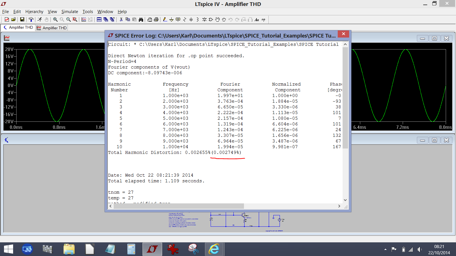

Slightly OT perhaps but relevant non the less......
Does anyone know the reasons for the change in LTSpice following an update and the way distortion data is now shown.
This is Bob's own amp and file (from the book fig 19.7). What is the reading in brackets showing ?
I can't find any info about it in the LTSpice helpfile or changelog. You can try asking Mike directly using the email address in the help menu under "about LTSpice".
Explanation from Mike Engelhardt is here,
http://www.diyaudio.com/forums/software-tools/263590-whats-ltspice-doing-there.html#post4097547
