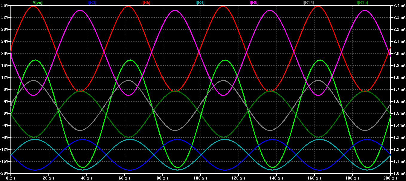

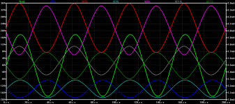

Nothing in the front end of this 15W CFA (input buffers, summers, TIS stage) runs in class AB. Everything is in class A.

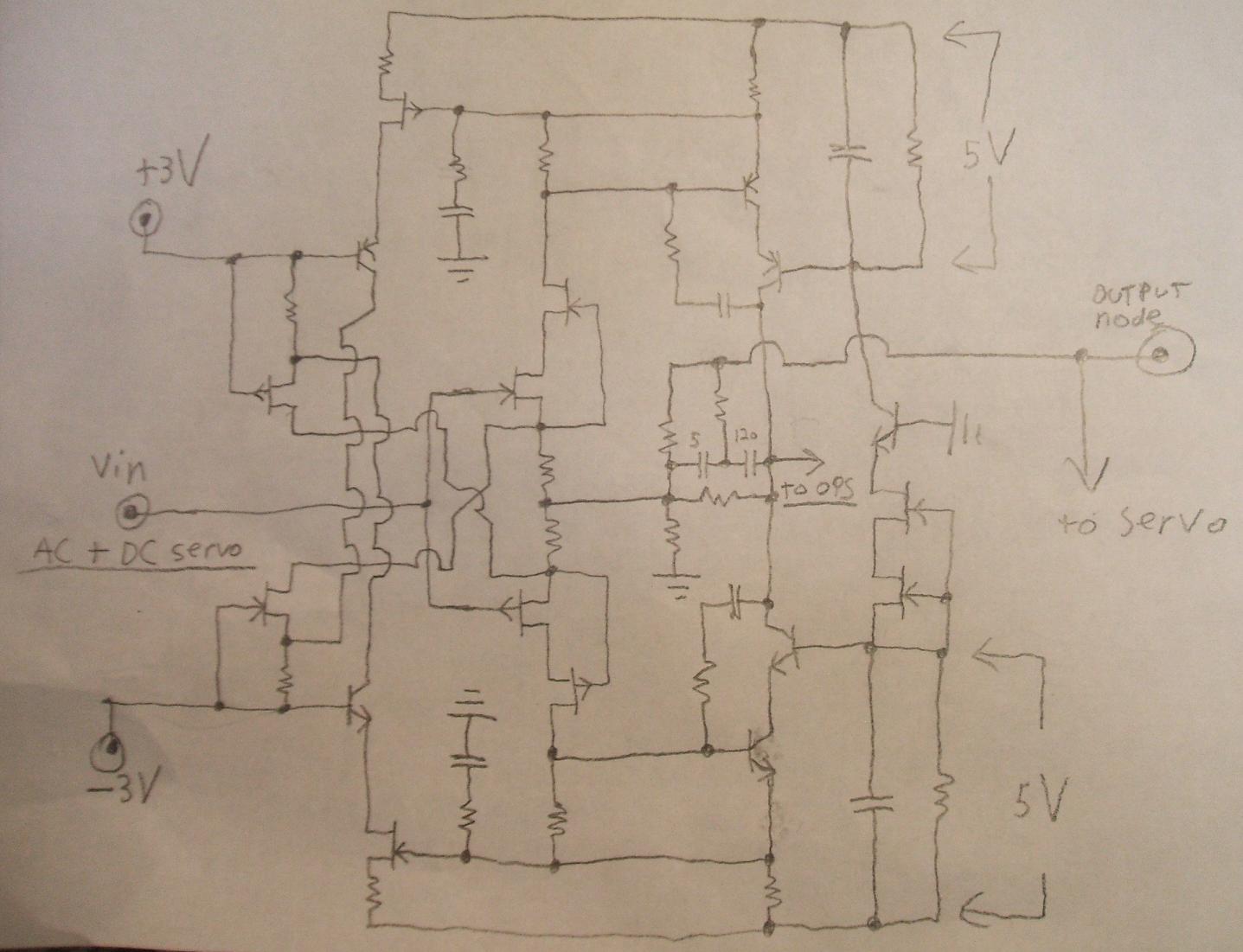

Not to complicate things:cheeky:, but I have found that the 'CFA' topology is quite friendly with using 'common mode error correction' via a common mode amplifier to modulate the source current that bias the input stage. Any stray difference in bias due to the feedback current is mitigated. I have played with this concept with both VFA and CFA input stages. I find in the CFA version that the common mode loop is easier to stabilize. Here is a basic sketch example of what I did. The common mode 'dependent CCS' current must be higher than the maximum change in 'error current' from the feedback voltage divider. This makes sure the IPS is always in class A, and that the actual change in current of the IPS is only that of what is required to drive the next stage. The global compensation is TMC ala Edmond S. & Cherry. You can criticize this approach it if you wish:smash:, I do not care because I know it works.😎 BTW, I have a special place in my heart for J-fets.:hug: I fear the day they are no longer made and no longer available.🙁
