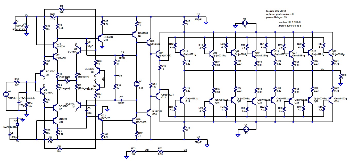

BTW, I have designed and simmed a quad comp input stage. Results look interesting with full power THD at ~6ppm 20 kHz. This is a VFA design, but features 'current on demand' architecture so its fast (See ADI's Walt Kester op-amp app note for a brief description - although in that implementation they seem to use diode biasing of the input devices). If you apply conventional TMC, the distortion is about 30ppm. This design might also benefit from MIC, but I have not tried that yet, and the slew rates in any event probably ok as is. If you drop the RHS of the input stage off, you get a classic 2 stage CFA topology -similar to nx-Amp).

BTW, I have designed and simmed a quad comp input stage. Results look interesting with full power THD at ~6ppm 20 kHz. This is a VFA design...

Seems the editor got the better of me about the amp I posted above . . .
Straight MC comp: 30ppm at full power 20 kHz
TMC comp: 6ppm at full power
Rails set to 85V and peak output swing is 76V delivering 350W RMS into 8 Ohms.
Rounding the output pair complement to 10 each side will drp THD to about 5ppm, and AFEC will take it to 500ppb. Of course, getting these levels on a practical amplifier really requires good layout and wiring skills - this a big challenge
Thats a very good topology, there are three audio companies using it at the moment, the most famous one is Marantz.
This however is not the quad core topology but its called H bridge.
What is this amp's ULGF?
For 8 pairs of output devices, due to physical constraints, it is not realistic to rely on ULGFs higher than 7-800KHz.
This is an interesting trade-off. Increasing the number of output pairs allows less current per device, hence less (open loop) distortions. But increasing the number of output pairs decreases the practical (not in simulation) ULGF, so less feedback to linearize. So where is the optimum?

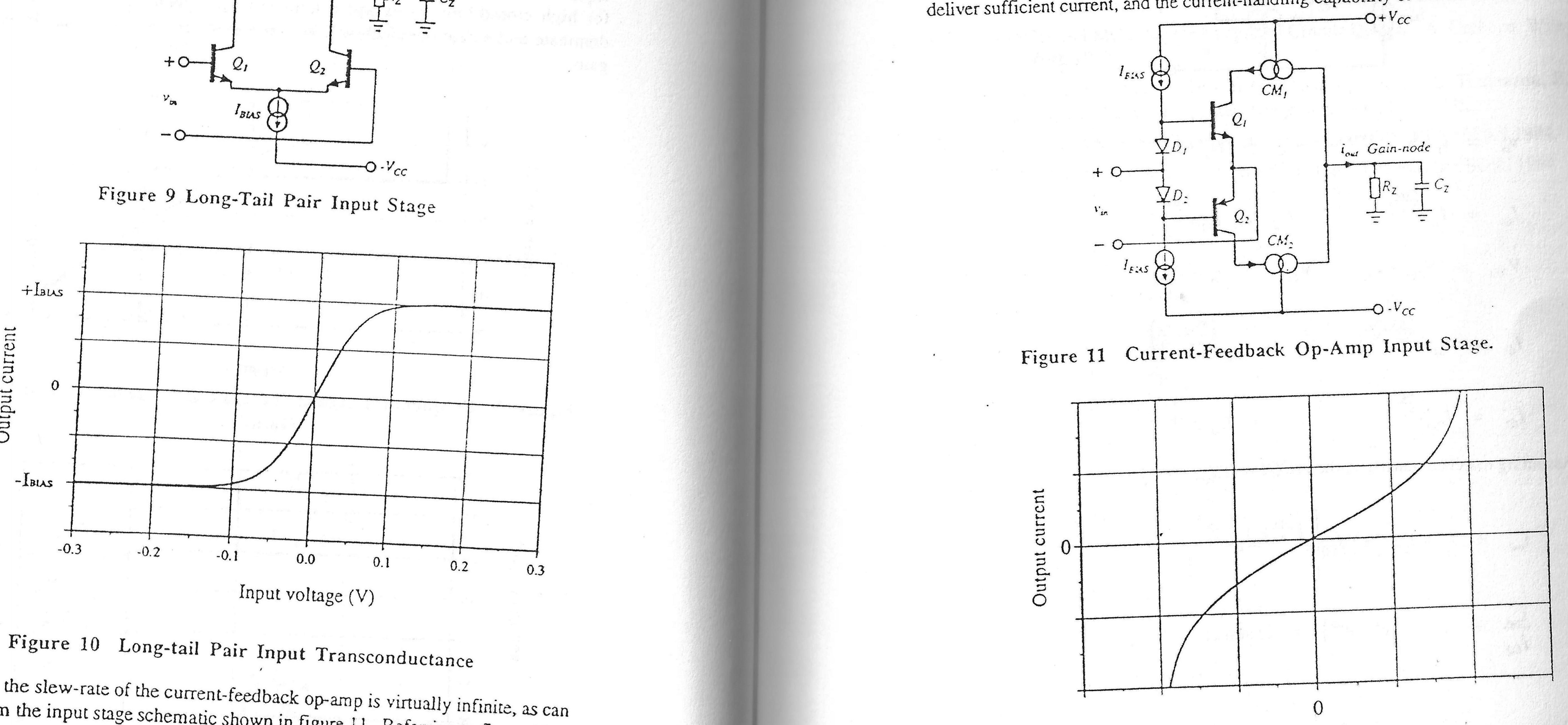

EVEN order harmonic cancellation, if you please, and, NO, Bonsai's nx amplifier's input stage is incapable of cancelling even order harmonics like a current-mirror loaded diff. pair.![]()
It doesnt need to cancel even order harmonics as these are at levels already lower than with the use of LTP as the stage is much more linear. I have already pointed it out, provided an analyses and Edmond has proved the point with simulation. 3RD harmonics are even more improved as well. Didnt you follow the thread ?? 🙁
Yes, that's why I just called a quad complimentary. I guess H bridge is probably more accurate, but quad balanced might help differentiate it from H bridge which is primarily associated with power output stages in motor drives and amplifiers.
I have not checked yet, but I don't think the PSRR is as good as a standard balanced or Lin VFA. Some more work needed in this area no doubt.
The naming by Analog Devices had me confused I have to agree. National which was probably the first to use it in their lm6171 didnt assign any particular name to it. PSRR is a little worse off, however slewrate can be increased by feedforward as is used with the lm49713 but its really not necessary for a audio amp and your design as is makes for a very good amp. Ive used a amp with this topology for the last three years and it is very difficult to discern it from CFA amps I have. PSRR is not such a big problem as some make it out to be although cascode as youve used helps. Why didnt you apply the cascode for the other CFA arm BTW ??.
I highly doubt the veracity of this; I fail to appreciate how a "CFA" input stage that operates in class-AB can be inherently more linear than a current-mirror loaded LTP which operates in class-A.It doesnt need to cancel even order harmonics as these are at levels already lower than with the use of LTP as the stage is much more linear.
I highly doubt the veracity of this; I fail to appreciate how a "CFA" input stage that operates in class-AB can be inherently more linear than a current-mirror loaded LTP which operates in class-A.![]()

The complementary common emitter input stage of a so-called "CFA" operates in class AB.
I would expect the cfa input stage to operate in class A for applications of which we speak. Just because it can operate in class ab doesnt mean it should (I do agree that quoting the high slew rate benefit is in fact meaningless and misleading because of the above).

This class AB thing wrt the CFA front end has been raised as an objection quite a few times. This may be the case with IC opamps, where a few hundred micro amps is a useful power saving. In a discrete design you do not have these limitations.
- Bob Cordell's Power amplifier book
