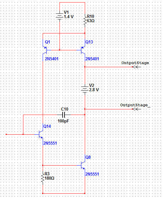

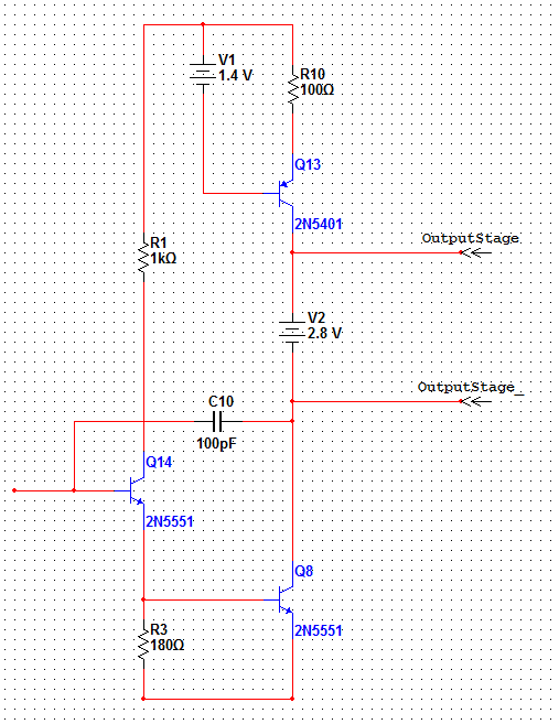

And I want to introduce another way, using saturated current source to do the current limiting of EF transistor. Please see the second picture.
I use this way in my last amplifier.

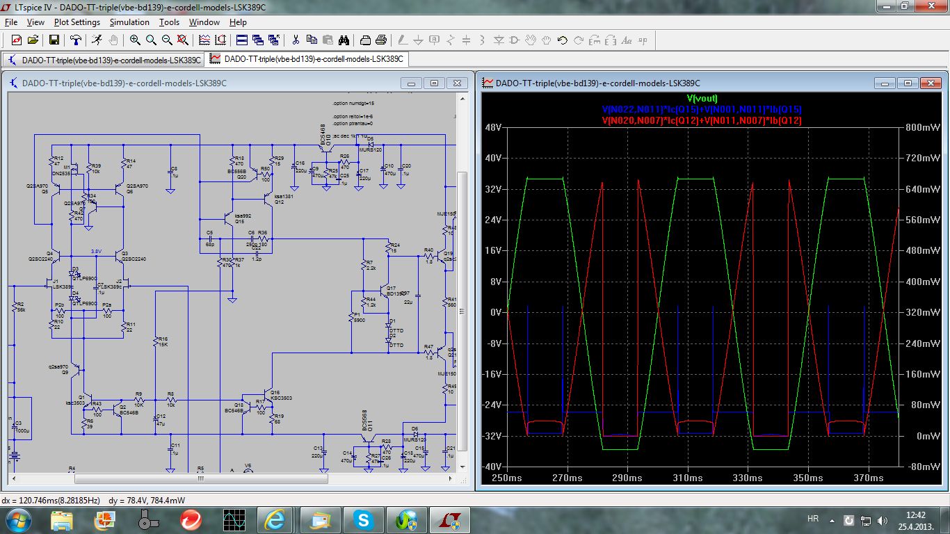

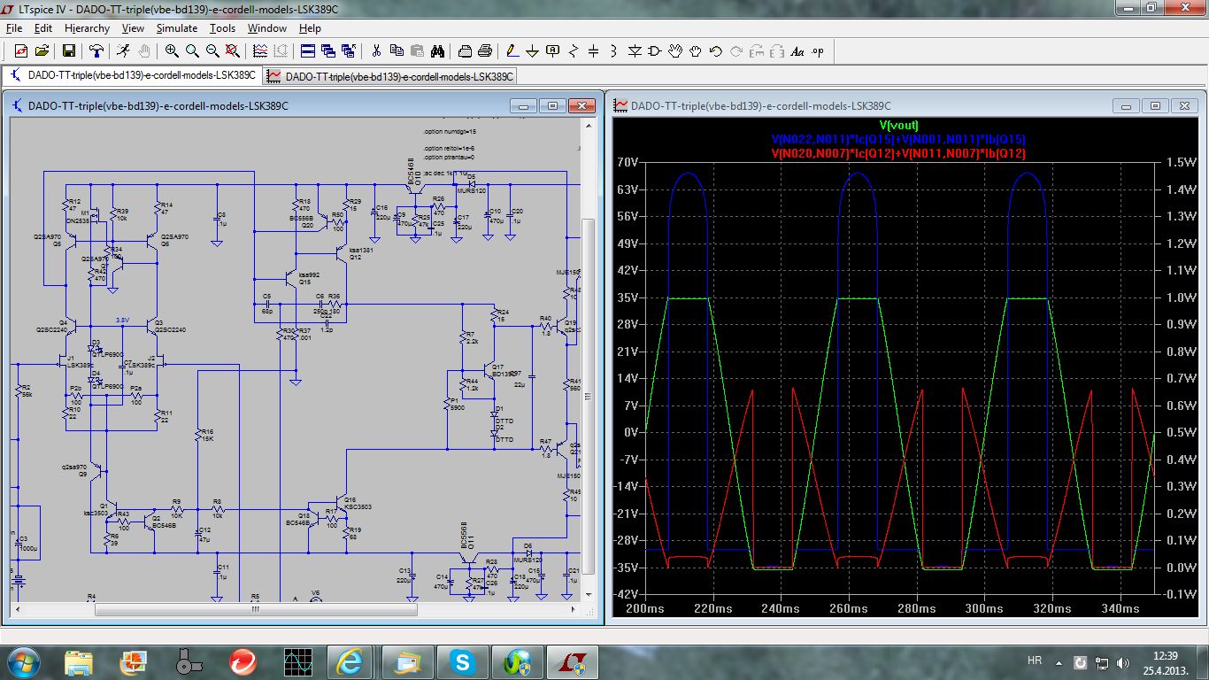

Hi Bob,
Here is overload VAS simulations with and without collector resistor in emitter follower enhaced VAS.
It looks that this resistor is still needed even with VAS protection transistor.
What do you think?
BR Damir

Actually, during the clipping, the output current of VAS won't be large. The output stage won't taken any more current than the normal situation. The current is limited by the current source of the VAS. We don't need to limit the current for whole VAS. The problem is too much current on base pin of the 2nd transistor. It is over driven by the EF transistor in Enhanced VAS.
You perhaps missed the context. If you could look at the schematic on page 60 of Cordell's book which is the circuit in question here, when it is driven into clip and the amp therefore goes open loop, Q12 can souce quite a big deal of current into emitter juction of Q4 and burn it up if Q13 wasn't there. The current souce load of Q4 would be irrelevant when this had ever happend, as it would only limit the collector current.
The problem is not the Ic of Q4. The problem is Q12 push too much current on the BE junction of Q4. The Ic of Q4 never goes up during clipping.
In that case, limiting Ic of Q12 is more important and more straightforward to this issue.

Hi dadod,
I'm having a little bit of trouble interpreting the plots. Looks like the right scale is in mW of power dissipation, rather than ma of current. Can you explain which color is a plot of what?
Also, just to be sure, can you state what the VAS current source load is set to and also what the VAS current limiter is set to?
Ah, I came to realize you were going against the idea of a resistor between the collector and the emitter in a cascoded VAS setup. Now I'm on the same page with you.
Yes, you were right. The resistor between the collector and the emitter in a cascoded VAS, it won't work.

Hi Bob,
First picture no protection resistor, second picture 1kohm protection resistor.
VAS standing current 9.3mA, protection set to four time more.
Yellow plot- output voltage
Blue plot - power disipation on Q15(EF) right scale
Red - power dissipation on Q12(VAS)
I hope this will help.
BR Damir
