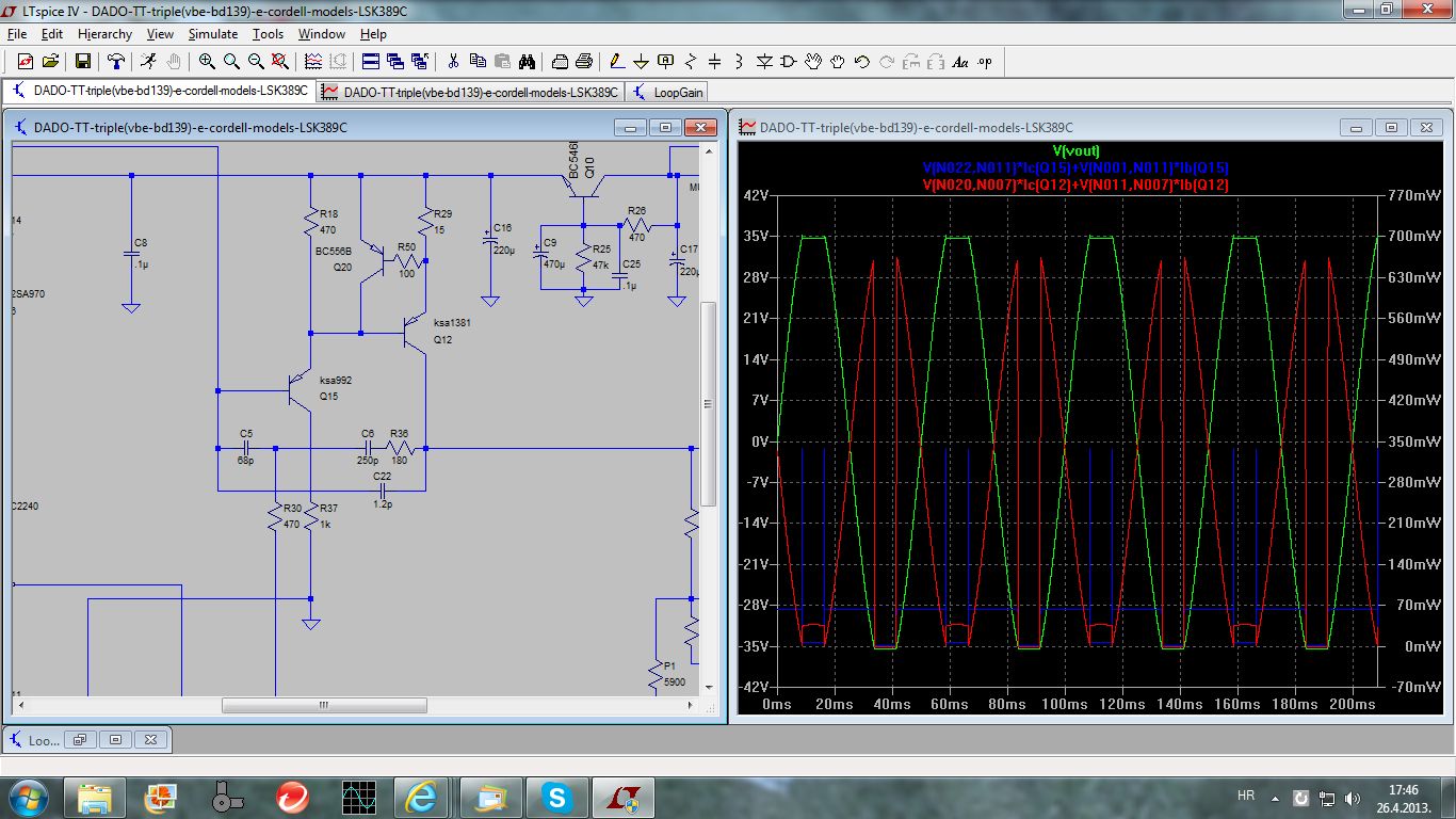

I am having difficulty reading the blue plots.
In the 1k protected version is the blue very short instantaneous power spikes?
Yes.
