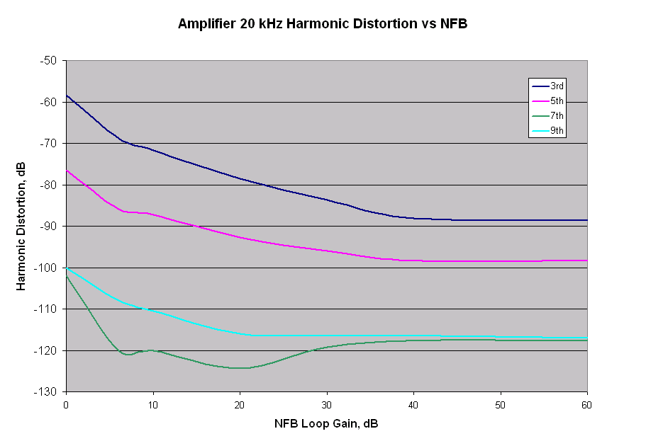

Power Amplifier Distortion vs NFB
There have been claims made that the introduction of negative feedback introduces or exacerbates high-order distortions. Previously in earlier posts it has been shown that for single-stage BJT and FET amplifiers this can be so under a limited set of conditions, usually starting with the introduction of low amounts of NFB on the order of 6-10 dB. These results tracked those of Baxandall. It was also shown that the introduction of NFB via emitter degeneration also had this same property illustrated by Baxandall. Moreover, at higher levels of total negative feedback around a stage, a further increase in NFB would cause a monotonic decrease in distortions of pretty much all orders. The introduction of global NFB around a typically degenerated BJT stage was shown to exhibit the monotonic decrease in all orders of distortion.
Here we make an attempt to show the results for such an experiment for a complete typical power amplifier, including its Class-AB output stage. The details of the amplifier are shown in a later post, but suffice it to say that it uses a dual complementary differential input stage with no current mirrors and employs Darlington VAS stages. The output stage is a Triple using two pairs of ThermalTrak RET transistors in a Class-AB arrangement with 150 mA per pair and looking into a 4 ohm load at a power level of 200W @ 4 ohms.
Using the same topology and transistors, seven versions of this amplifier were designed with amounts of NFB loop gain equal to none, 6dB, 10 dB, 20 dB, 30 dB, 40 dB and 60 dB. In all cases closed loop gain of the amplifier was 30. In all cases with NFB, the amplifier was compensated to have a closed loop bandwidth of 1 MHz.
The results of 20 kHz harmonic distortion simulations are shown in the graph below. Only odd-order distortions of 3rd, 5th, 7th and 9th are shown for clarity. All even order distortions were generally lower and similarly behaved.
Notice that the distortions generally decrease monotonically with the application of increasing negative feedback (an exception is a dip in 7th harmonic distortion between 6 dB and 30 dB NFB that may be due to some cancellation effects).
Also, notice that the decrease in distortion with increasing NFB tends to flatten out above about 40 dB NFB. This is because the closed-loop bandwidth is being held constant, so that, while LF NFB is increasing, the amount of NFB at 20 kHz and above is already at its maximum value (about 34 dB) and being held constant by the feedback compensation.
Bob

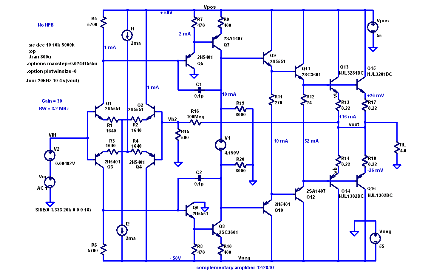

Power Amp Distortion vs NFB
The LTSpice schematic of the amplifier used for the above simulations is shown below. It is a decent amplifier, but nothing special. The version shown is the zero-feedback version. It uses complementary BJT input differential pairs with each tail biased at 2 mA and with simple resistive loads. Emitter degeneration is selected in accordance with the amount of NFB for the particular design version.
The complementary VAS stages are each in a Darlington configuration. VAS emitter resistors R9 and R10, and VAS load resistors R19 and R20, are selected in accordance with the amount of NFB for the particular design version. These resistors, in combination with the input stage degeneration resistors, are selected to achieve a reasonable gain distribution between the first and second stages for each NFB case.
In every case, input stage load resistors R5 and R6 were adjusted so as to achieve a VAS quiescent current of 10 mA.
Conventional Miller compensation capacitors C1 and C2 are selected for each case so as to set the closed loop gain to 1 MHz. They are set essentially to zero for the no-feedback case.
The output stage is a Triple with a healthy 52 mA idle bias in the driver transistors. Two pairs of RET ThermalTrak NJL3281D and NJL1302D power devices are employed. Each pair is biased with an idle current of 116 mA through 0.22 ohm emitter resistors so as to drop 26 mV across each emitter resistor. The amplifier was simulated while putting 40 V p-p at 20 kHz into a 4-ohm load (200W). In all cases the feedback resistor R16 was set to achieve a closed loop gain of 30. The applied dc input offset voltage was adjusted to achieve an output dc offset of less than 1 mV for each case.
Bob

Re: Re: Power Amp Distortion vs NFB
Good catch, Mike. You're right, those Darlington transistors are actually running at a little over 6 mA. That's not what I intended, must have been a brain lapse. I don't think it invalidates the results, though.
Thanks,
Bob
MikeBettinger said:Hi Bob,
The value for R7 is wrong for 2ma. Maybe something around 2.4K?
Regards, Mike.
Thanks,
Bob
Re: Re: Re: Power Amp Distortion vs NFB
I don't think so either. I was just looking at what you were doing and it didn't look right.
Mike.
Thanks,
Bob
Mike.
Re: Re: Re: Re: Power Amp Distortion vs NFB
Thanks again, Mike, for spotting that. Indeed, the current through that Darlinton transistor changes with each version of the amplifier for different values of NFB, since the drop across the emitter resistor of the VAS transistor changes with amount of degeneration (and considerable degeneration is needed for the low-NFB cases). If I had it to do over again, I should have not kept that 470 ohm resistor constant, but rather adjust it for each design.
Bob
Mike.
Bob
