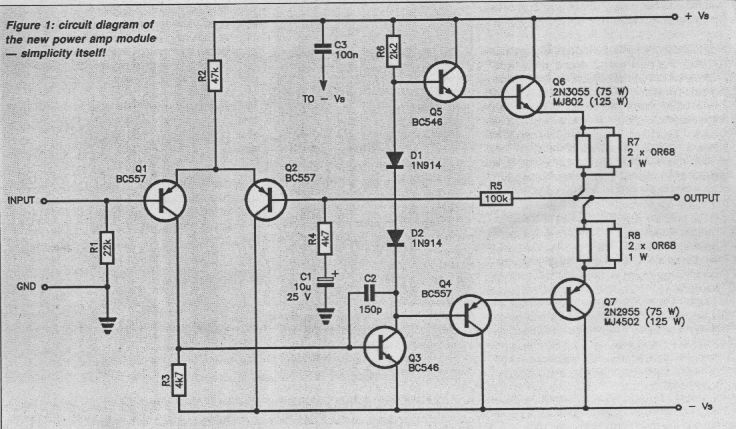

Re: EMI Ingress
Another reason expressed, at least by Leach, against using lead compensation across the feedback resistor is that it is used to correct for a lag in the output stage, which is load dependent, and is therefore unreliable if the load impedance changes.
Bob Cordell said:
4) I never use a lead compensation capacitor across the feedback resistor; such a capacitor greatly increases the coupling of garbage at the output terminals back to the input stage.
Bob

Re: EMI Ingress
Hmmmm....... a miller compensated VAS is essentially an integrator, which basically kills RF that finds itself mixed up with the input signal (consider a miller compensated VAS connected to that BJT LTP I simulated earlier).
I think that it is arguably easier to effectively filter the low current supply rails of a power amplifier for RF currents than it is to practically eliminate them from the input signal, so I’d put a question mark over that design strategy too.
Glen
Bob Cordell said:6) I design the amplifier-proper to have very high natural PSRR out to fairly high frequencies. This includes trying to use feedback compensation that does not degrade HF PSRR.
Glen

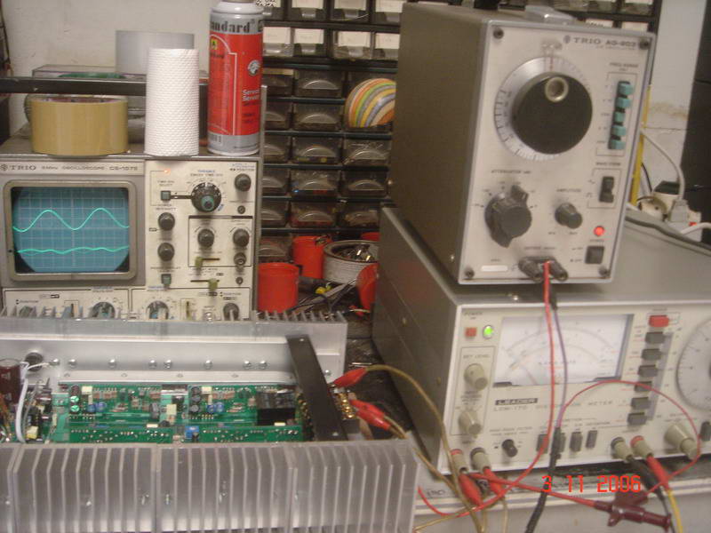

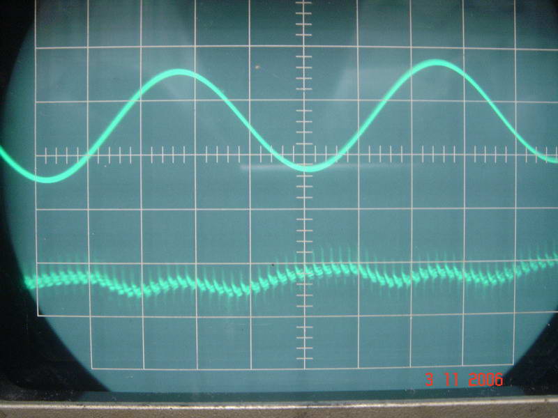

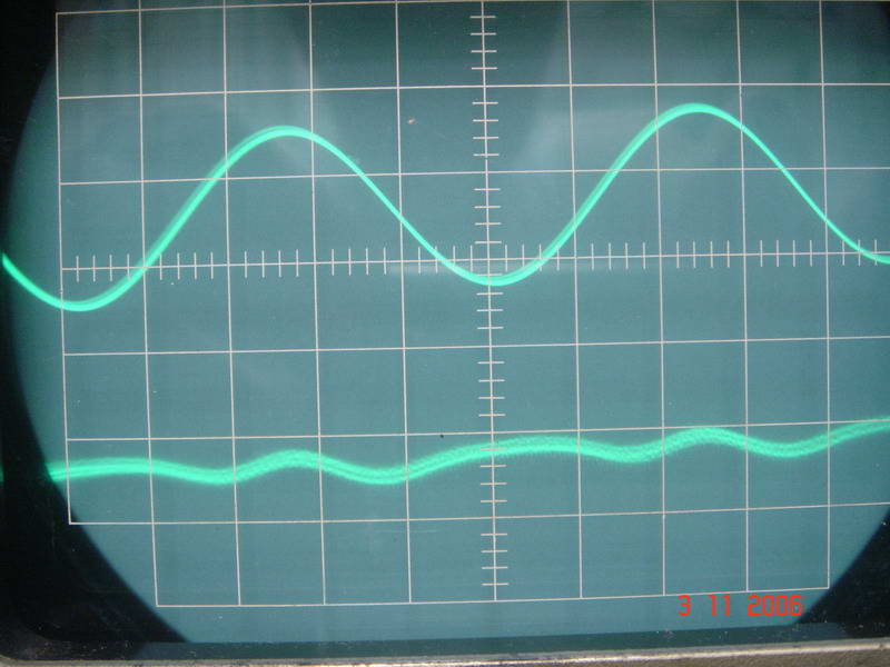

This is the waveform with an operating SMPS nearby. Note that the SMPS garbage seems don't appear signal itself, but appears clearly after the signal is nulled by distortion meter.
But I don't investigate how the mess enters the system at that time. So, I don't know whether it is entering via input, or via output, or via supply, or via something else?

Hi, Glen,
Miller cap around (ordinary connected) VAS worsen PSRR. In this cct, -vs junk will go to R3 , then to base of Q3, then to C2, then goes through output transistors Q5-Q6,Q4-Q7.
There are some "smart" modifications to advoid this. JCX several times mentioned Sackinger paper : http://www.diyaudio.com/forums/showthread.php?s=&threadid=13590&highlight=
http://citeseer.ist.psu.edu/432448.html
Bruno Putzey have a smart one to divert the input of the Cdom from rail referenced node to ground referenced node (slide #34) : http://www.hypex.nl/docs/Bruno Masterclass/slides.htm slide#28-35.

lumanauw said:This is the waveform with an operating SMPS nearby. Note that the SMPS garbage seems don't appear signal itself, but appears clearly after the signal is nulled by distortion meter.
Nice experiment.
What was the signal fundamental frequency and what was the THD reading absent the SMPS. If for example, we are looking at a 0.01% residual, then the level of the SMPS garbage signal is fairly small. Also, it is unclear whether this SMPS noise would be audible at the output of the amplifier. What do you think?
Best,
Bob
Hi, Bob,
The fundamental frequency is 1khz. You can see, the SMPS garbage is about 30khz or so. At that time I just want to see whether HF junk radiation existed or not, and I didn't wrote any note on that experiment. I don't remember how much the THD was. I think the absolute# won't differ much, but the spectra will be different.
With another experiment (not this one), I found out that supersonic frequencies (>20khz up to Mhz) do change the perceived sonics. It is not because we can hear supersonic, but because it is intermodulating/riding the 20hz-20khz signal, making new signals or corrupting signals that is not in the original music.
Janneman made a good point about voltages at input differential. Voltages here are so small, that a small noise here will be magnified alot at the output node.
Is it possible that the HF junk, beside comes via input, output, rail, also possible to enter directly to the bases of the input differential transistors? Like via PCB tracks connected to those bases acting as an antenna?

David,
Would it be possible to to the experiment again but this time with the amplifier off? I have had similar experiences where the EMI actually existed in the test equipment or even in the test leads. By nature, this type of interference is hard to pin down and it is not always where you see it

Hi, Janneman,
OK, if I set up the measurement set-up in the future, I'll try your suggestion.
I also have difficulties in determining whether a waveform in the scope is the real thing or probing mistakes. In class AB amp it is relatively easier than classD setup to determine which is which. When we make classD amps, many waveforms are from probing mistakes. Frankly, I haven't implemented AN-47 (high speed technique) throughly.
PMA said:Jan,
this is only partly good idea. With properly matched cables and well RF designed electronics, wiring and shieldind, one gets BETTER results after switch electronics ON. The reason is, that only after switch on you get proper impedances, especially output impedances. Switched off it is in undefined status, regarding RF.
PMA: Yes you are right. I *should* have said something like: can you repeat it with the amplifier off and the test lead shorted....
David: I see you are aware of these traps.
