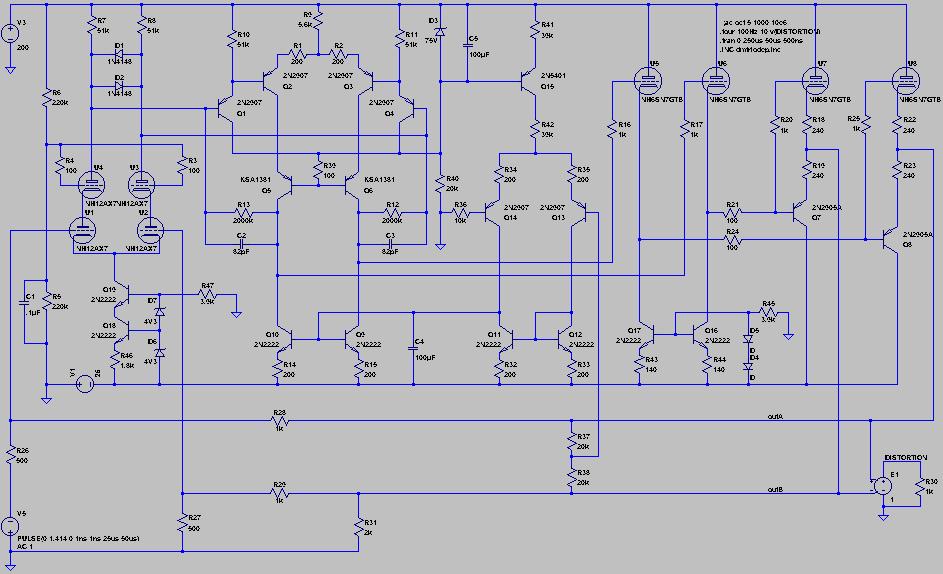

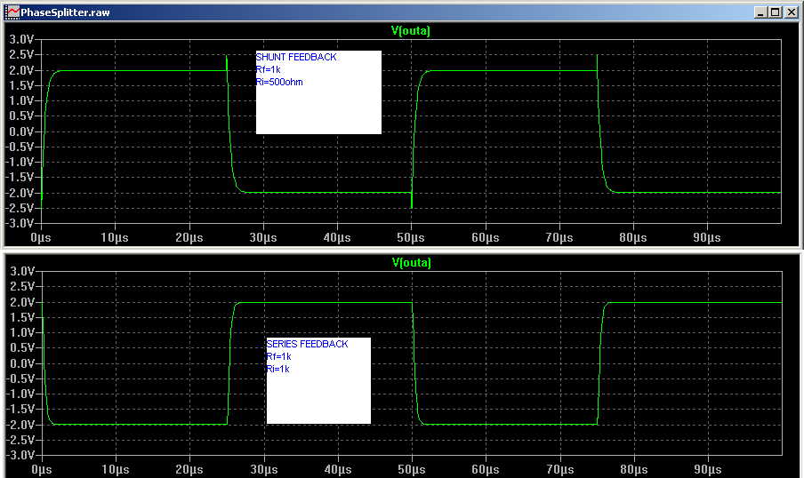

Does anyone know how to eliminate the square wave overshoot that seems to be inherent when using shunt feedback around and opamp, as opposed to series feedback - or know of a good reference explaining the mechanism behind the problem??????
Below is the simmed results for a miller compensated discrete opamp with a 1MHz fT and a phase margin of 80 deg.
I've got the THD-20 of my single ended to differential hybrid (2 * 12AX7 + 2 * 6SN7GTB) linedriver down to 0.3ppm, but the overshoot on the shunt feedback path/side is giving me grief.
Glen

OK, I’ve worked the mechanism out. I guess that it should have been obvious. It is due to current being delivered to the load via the actual shunt feedback network from the actual source for the brief period of time that the opamp goes open loop on the square wave transition.
This is obviously something that cannot be eliminated with shunt feedback, only minimised.

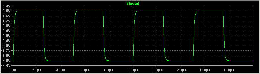

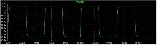

The simplest way to do so is to bandwidth limit the input signal. Limiting the input signal to about 1/3 the unity feedback gain transition seems to reduce the overshoot to totally neglible levels.
Below is the result for shunt feedback with the input square wave bandwidth limited to 330kHz (1MHz miller compensated fT) which would seem more than ample for audio reproduction.

Hmmm…..OK. Where exactly should I put a small capacitor? I’ve tried on just about everywhere to no avail - both on the circuit below and simulations using common opamps, which all exhibit the exact same problem (to varying degrees) when using shunt feedback.
PMA said:
Across the feedback resistor, to compensate for -IN stray capacitance.
Tried that, it doesn't work - it actually makes it slightly worse (transient input current is now bypassed directly to the output without being attenuated by Rf) You can try to compensate for the stray input capacitance but you can't eliminate the amplifiers propagation delay 🙁 The overshoot I’m getting is about 70nS in duration.
