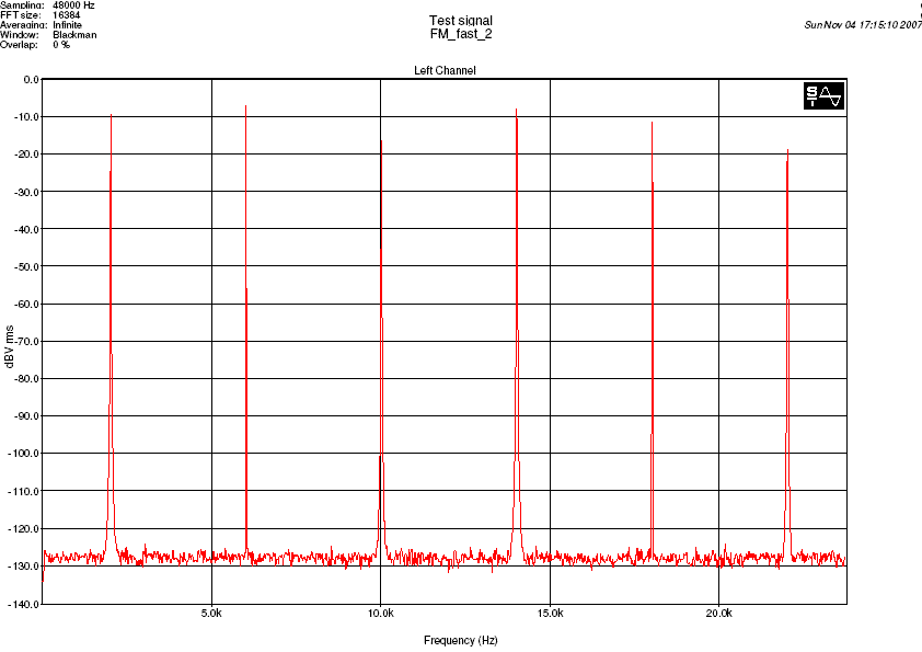

PMA said:I was thinking a bit about test signals again. How about this?
Hi Pavel,
Looks interesting, but a little more explanation would help 🙂.
Bob

Hi Bob,
I have started to play with frequency modulation again. The files created in Cool Edit.
Another one, for carrier = 1OkHz, modulation frequency = 4kHz, modulation index = 2
Pavel
