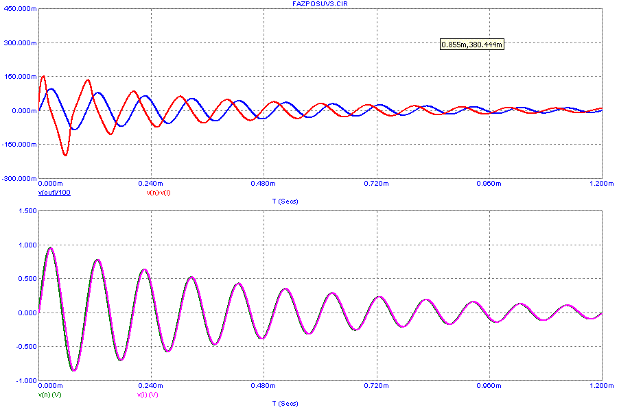

Today we had interesting discussion on our local forum and I have realized that some designers do not understand the fact that input differential voltage / v👎 - v(i) / of amplifier with 1 dominant pole OLG response is 90 degrees phase shifted from output voltage / v(out) /, almost everywhere where openloop gain plot A(w) decreases with -20dB/decade slope. This may cover frequency range like 100Hz - 100kHz, e.g.. I hope it is obvious and I add the illustrating image.
Yes, this is a very good point that some may miss.
Bob

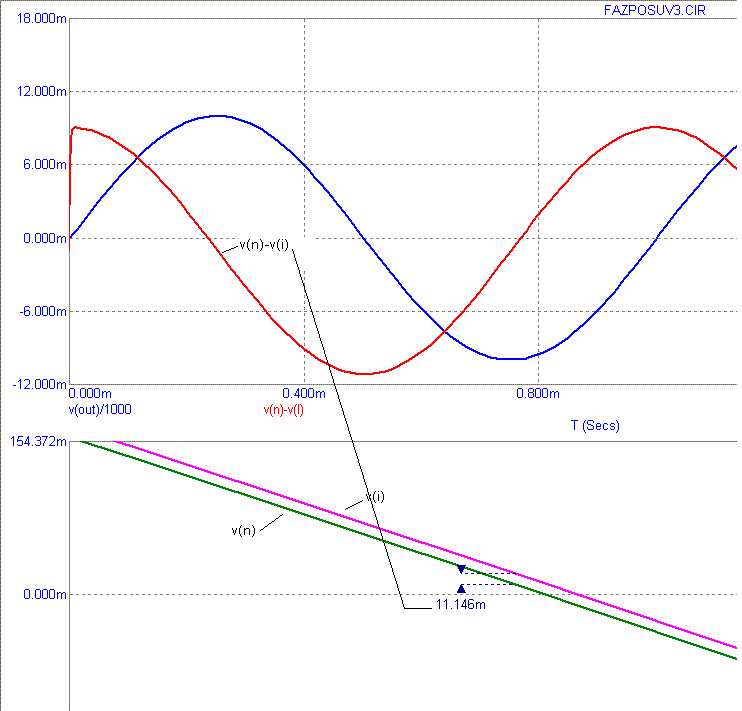

Frankly speaking, I am thinking about the same. But firstly we must consider that it is not the phase shift between output and input signal, but between output voltage and input differential voltage.
For Cdom compensated open loop gain plot, this results in:
- Vdif increases with frequency
- higher the signal slope, higher the Vdif
- crossover distortion residuals, fast and steep, are emhasized in Vdif
Last - as amplitude of Vdif changes with frequency and speed, there is a question of possible phase modulations.
Pavel
P.S.: such amplifier has high vector error. We usually assume only non-linear distortion. Is it correct? Music is a transient, time variant signal with instant amplitude values. We try to substitute it by summation of steady state sine waves.

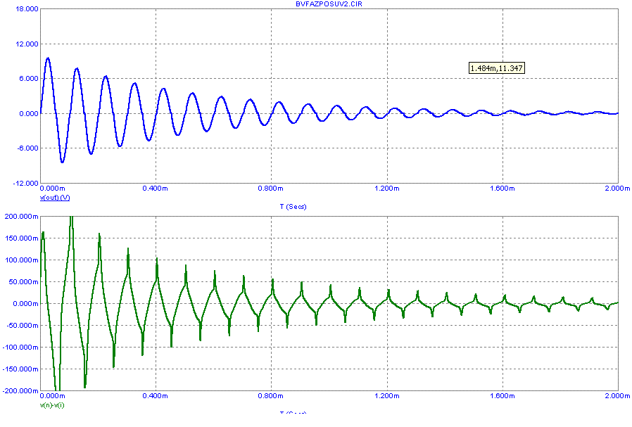

Now, the error voltage at the output is:
Verror = A(closed loop gain) x Vdif
for image in
http://www.diyaudio.com/forums/showthread.php?postid=1310234#post1310234
it is more than 2V! The vector error. This is 10kHz damped sine burst, 10Vp output amplitude, CL gain = 10. Yes, uA741 + nasty classB output stage. Yes one can imagine better device and better output stage, the error will be reduced, but still exist, and not negligible at all.

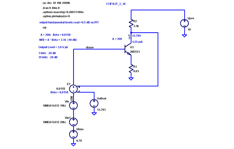

I finally got around to doing some 19+20 kHz CCIF simulations to see if I could duplicate your observation that the NFB increased the f1+f2 distortion component.
Although I plan to do the experiment around a Class-AB output stage, I first did the experiment around a single BJT CE stage, as pictured below. I ran the stage at 3V peak output under four conditions: no NFB, 10 dB loop gain, 20 dB loop gain, and 30 dB loop gain.
The results were as follows:
In all cases the test tones were at +0.5 dB on the FFT spectrum.
no NFB: -17.4 dB for both 1 khz and 39 kHz
10 dB: -28 dB for both 1 kHz and 39 khz
20 dB: -37 dB for both 1 kHz and 39 kHz
30 dB: -46 dB for both 1 khz and 39 kHz
This is almost textbook behavior, so at least for this basic case I was not able to duplicate your results.
Bob
