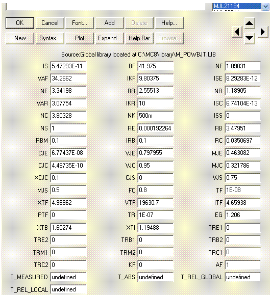

.MODEL mj21194 npn
+IS=4.02325e-14 BF=10000 NF=1.1488 VAF=10000
+IKF=0.377331 ISE=2.16244e-09 NE=2.49213 BR=0.1
+NR=1.5 VAR=1.70851 IKR=3.77331 ISC=1.00031e-16
+NC=3.99945 RB=0.1 IRB=0.1 RBM=0.1
+RE=0.00775691 RC=0.0387846 XTB=0.1 XTI=1
+EG=1.05 CJE=1.07724e-08 VJE=0.975489 MJE=0.524369
+TF=1e-08 XTF=2.16157e+06 VTF=0.184568 ITF=5.56361
+CJC=2.68609e-10 VJC=1.64862 MJC=0.242322 XCJC=0.1
+FC=0.910137 CJS=0 VJS=0.75 MJS=0.5
+TR=1e-07 PTF=0 KF=0 AF=1
BF=10000???? Does this figure pass a sanity check?

PMA said:Cool down, mine has BF=69.3372 for 21193 and BF=41.975 for 21194.
The data I showed was fresh from OnSemi at the time that I posted. I'm a bit annoyed that there seems to be no quality control on models from OnSemi. Seems they should be required to fix this being an ISO9000 company.
The MJ and MJL versions of the parts have different models from what I've seen. Tried to find a good pair for the 21195/96 and most of them looked suspicious in one way or another. The first pair I tried in simulation did not pass a sanity check, which is what sent me off checking models.
Onsemi needs to but some quality checks into their models.
Where did you get your models, PMA?

They are from MC8 library.
AFAIK we should solve this in the SPICE thread.
