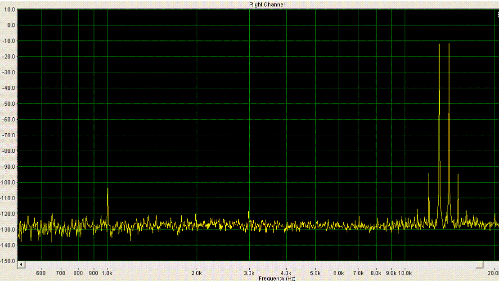

Bob Cordell said:
Sounds like a nice design, and sounds like the local feedback is doing a very good job. Of course, how local is local? For example, if you think of error correction as a negative feedback loop with an embedded positive feedback loop with a closed loop gain of infinity, is the EC really a local feedback loop? Of course, I don't know if you are using error correction or something similar.
Do you by chance have a spectral plot of 19 kHz + 20 kHz CCIF IM at near full power? That would be interesting to take a peek at.
Best,
Bob
Hi Bob,
I have just arranged a measurement on the new sample:
(Note: it was -1.9dB under full power, output stage alone, without global NFB).
