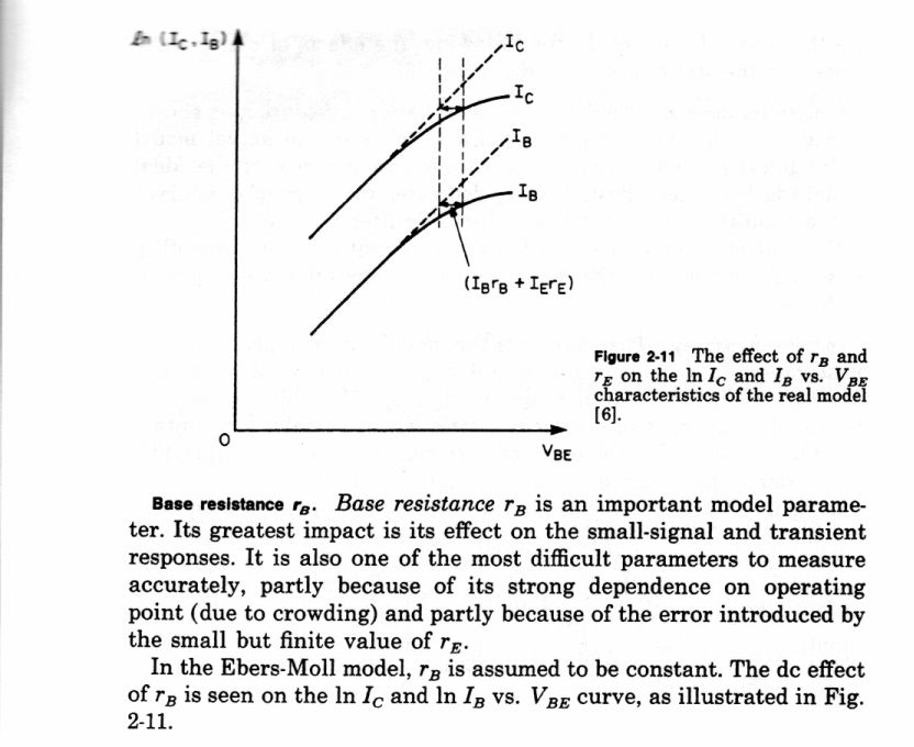

Re: Re: Re: Re: Distortion vs bias current
The base resistance is a hard one to get right. The plot below shows how a small RE value can mess up the determination of RB. Unfortunately, the data sheet info is not enough to distinguish the part of the errors due to RE and RB. So I've made the simplifying assumption that RE=0. This is described better here, about a third of the way down the page.
For example, if I had put RB=0 and RE=0.04, I would get similar results for the Ic vs. Vbe curves (with both fitting the datasheet well). I suspect the correct values are somewhere between the extremes of what I chose and the RB=0, RE=0.04 case.
The RC value matches the slope of the output curves in hard saturation to the datasheet. But if RE were greater than zero, RC would decrease by whatever RE ended up being.
I did get contact info from Charles for the project guys at OnSemi, but I have not contacted them yet. Maybe they have some insight as to what the real RE or RB is. Given one of these, I can compute the other from the deviation of ln(IC) vs. Vbe from a straight line. In that case, I could do a better parameter fit.
