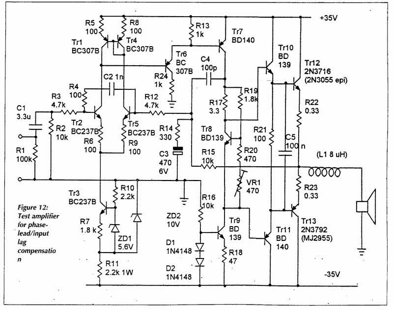

Some designer also don't use miller cap
In a paper (by John Ellis P.hd), he proposed PLIL (Phase Lead Input Lag) method as an alternative method to stabilize an amp without Miller cap.
Phase lead = C4
Input lag = R4+C2
These 2 must both be used together.
Notice also he put R3 and R12.
In Bob's amp, the RC network in differential is put between collectors of input differential, in John Ellis' it is put on bases of input differential.

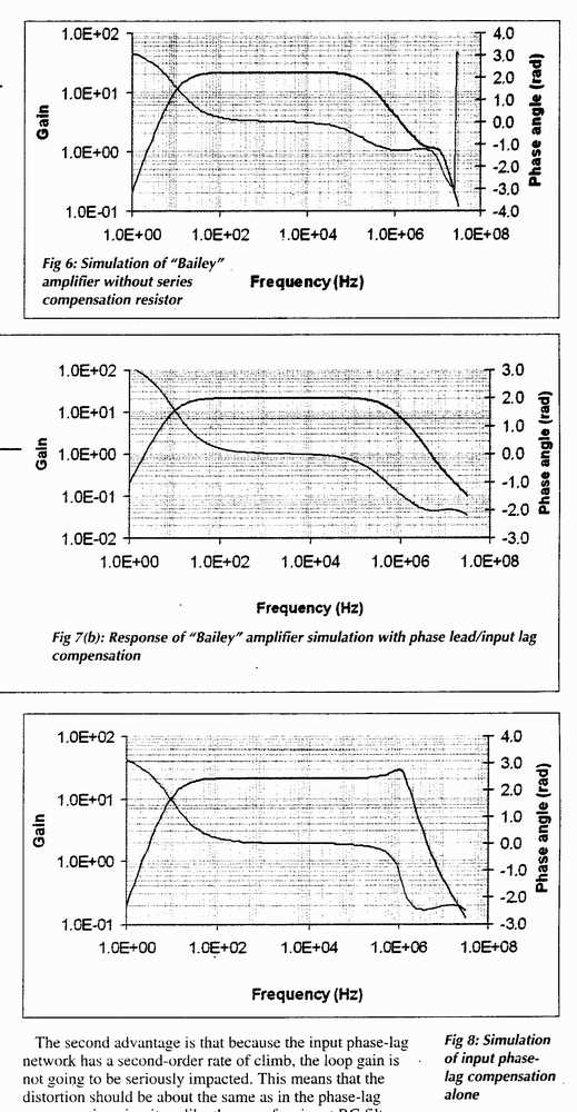

Hi, Mikeks,
PLIL has 2 components that must be used together "PL"and "IL".
If you only use C4, you don't make "PLIL", just "phase lead" compensation. John Ellis found out that only using "PL" is not enough to make an amp stable.
"PL" can be accompanied by (smaller) miller cap to make an amp stabile, but here it is the miller cap that is tried to be eliminated.
So "PL" needs another accompany to make the amp stable, but what? J. Ellis suggest to use "IL" to accompany "PL". The overall bode plot result of PLIL looks nice, but each component value of PLIL needs to be calculated.
