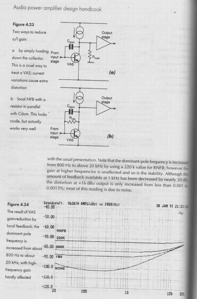

Mr. Cordell,
In Doug Self book, he mentioned a method to make linear OL response. The method is to put resistor about 220k in the place of miller cap (B-C of VAS). In the graph, 220k gives flat OL response.
What is your opinion about this method?

Yes, this method is essentially what I would use if I wanted wide open-loop bandwidth; I would establish it by feedback around the VAS, rather than loading the VAS. This avoids the difficulty of imposing a heavier load on the VAS. But, of course, the resistor must be a.c. coupled in the example he shows, to allow proper biasing. Also, this approach to achieving wide open loop bandwidth still imposes larger signal excursions across the full frequency band on the input stage, as compared with a design where the VAS is allowed to have higher gain at low frequencies.
Bob
