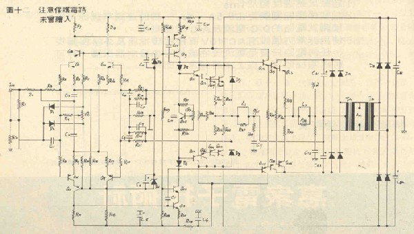

Technics did it in a single-ended design in the 80's. They called it class A+. I have found a write-up about it in an "Electronics Australia" magazine. Unfortunately I can't remember which magazine it was, and my EA's have been mixed up with several hundred ETI's I have recently acquired. I will try to find it and scan it ASAP.

"High Efficiency Class A Audio Power Amplifier"
(CLASS A+ AMPLIFIER)
AES Preprint no. 1382 (N-5)
Presented at the 61st Convention
November 3-6, 1978
I don't know if it made it beyond a preprint:
http://www.aes.org/e-lib/browse.cfm?elib=2972

You might want to look at the patent #4,115,739, Sano, Hirosha,
and Hirota, April 1977.
And you might want to see my patent #5,343,166 which is
related to the subject.

PB2's reference made it easy to find, I just sorted through my 1978 issues of EA.
I guess I can't post it up here due to copyright issues, but anyone with a collection of old EA's can find:
"The Strange Case Of the Technics A+ Amplifier"
Page 33
Electronics Australia Magazine
Vol. 39 No. 11 February, 1978
