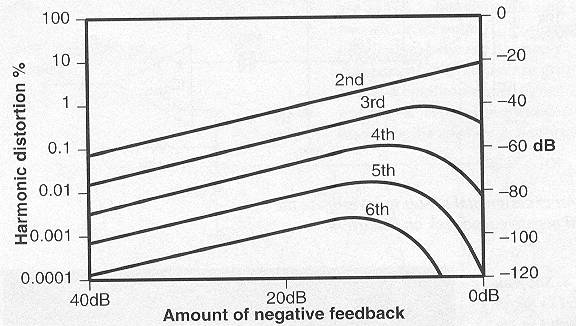

At first sight, I also couldn't believe this. Indeed, the (total!) THD decreases, BUT the spectral content has changed. Suppose we have an amp (without FB) which produces only 3rd harmonic distortion. By applying FB we put the 1st harmonic AND the 3rd harmonic from the output back to the (inverting) input. Now, this FB signal is also distorted by the amplifier, resulting in 1st, 3rd and 3*3=9th harmonic components. Admittedly, the latter is generally very small.

janneman said:This illustrates the point. Originally from Linsley-Hood.
Hi Jan,
This also looks like the curve from the Baxandall paper I was referring to above. Do you have the Linsley-Hood article that the graph came from?
Andy,
I think we talk about the same graph. I may have mixed up Peter Baxandall with John LH on this one.
One thing to put it in perspective: the original graph assumes an amp stage with a quadratic transfer function. If the tf is different the results are likely to be different as well, but I would expect a similar effect, as explained by Edmond as well.

The Baxandall article is cool because he does measurements to verify the theoretical graph, using as the open-loop amp a FET circuit whose distortion is dominated by second-order, but has a small amount of higher-order distortion components. His measurements are pretty close to the theoretical graph.
Yes that's the article. I should have it somewhere....
His graph is often quoted, this particular version (which is unusually good, most don't come out well from the scanner) is from a Vanderkooy-Lipshitz paper.

This set of curves is also discussed by Cheever, who also went to
the trouble of matching the mathematical basis to a real world
test circuit.

It looks like from the graph that the situation applies only to a small amount of NFB.
I mean, if both the lower and higher harmonics are first reduced, then the new combination is also lower, right?

Baxandall was right... it is well worth (re-) reading his articles.
His calculations were for a FET. The distortion gets even worse for a bjt.
This is why it is important to have high nfb - because too little makes things worse (unless you have managed to linearise the amp first).
Many 1970's amps boasting 0.1% distortion (!?) actually demonstrated this non-linearity when you measured their IMD. TUrns out many were around 0.4%. No wonder people didn't like 1970's amps much. The IMD is a better indication of non-linearity...

Reiterating a point I made a long time ago, these curves imply
that you either want no negative feedback, or a lot of it.
