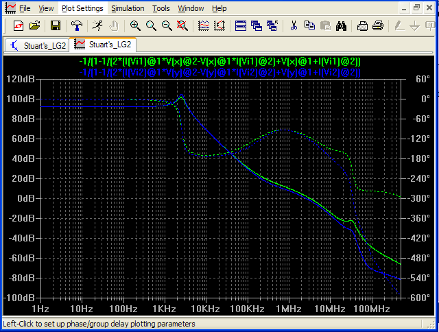

Your first paragraph here seems like a reasonable description of the scheme. I agree about the input stage not enjoying the same loop gain boost as with DPC, but I would not then say that the scheme is a complete waste of time and effort. In an amplifier where the biggest distortion problem is in the output stage, and where the designer does not want a DPC global NFB charactersistic, is this scheme not useful?
Bob
No, because the scheme does not increase the amount of feedback applied to the output stage compared with the equivalent DPC at the frequencies of interest.
Moreover, the scheme actually applies a DPC characteristic about the last two stages of the amp.
Therefore, it cannot be usefully claimed that the designer has avoided the use of DPC.
So what's the point? :scratch2:
Green Trace: Minor-loop gain about output stage with Edmond's scheme.
Blue Trace: Major-loop gain with equivalent DPC.
You may download the relevant sim circuit here.
Mike, at this point you are perfectly right. The point is that my scheme isn't plagued by the phase dip at around 20kHz of the global feedback loop (wrt to the input stage), hence a nicer step response.
Actually this phase dip is not manifest in the closed-loop response and therefore has no significant effect on your step response.
Additionally, the step response of an amp compensated by whatever means can be trivially tweaked.
Mike, of course the closed-loop response (in terms of frequency and phase) looks fine (except for a tiny bubble), but that's half the story. The trouble sits inside. To make this visible, you should have to expose your circuit to a square wave and look at the response in this way.
