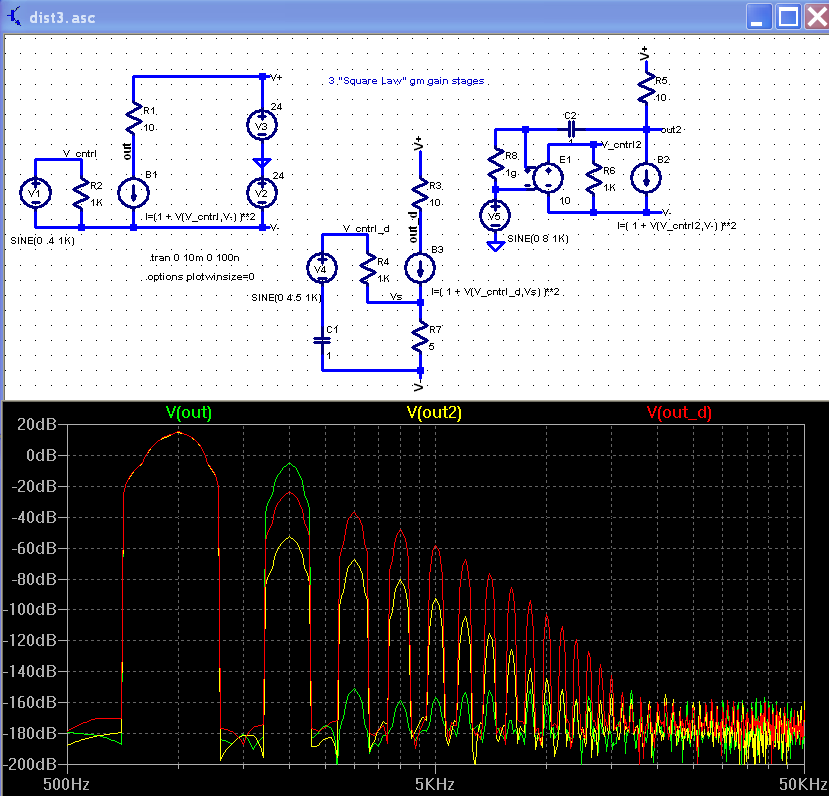

Given the dramatically lower higher harmonic figures for the unity gain
simulation vs my real world part with an open loop gain of maybe 30 dB,
I wonder what you would see if the simulated component had more gain?

It's not really an apples-to-apples comparison. The intent of what I did was to duplicate/verify Baxandall's work in order to explore some theoretical properties of feedback, starting with the simplest configuration he considered. That configuration has all open-loop distortion components except the second-order identically zero. Yours starts out with open-loop distortion components other than second-order that aren't zero. I would certainly expect the results to be different. In order to model such a case, the B-source would have to be modified to include higher-order distortion. But that wasn't the intent to begin with.

Andy, can you please think about OL circuits? When you will put two or three your 1 * x + a2 * x^2 blocks one after another you will get similar high-order products due to intermodulation fundamental and harmonics. I'm thinking how to introduce the metric to compare OL and CL networks.

andy_c said:In order to model such a case, the B-source would have to be modified to include higher-order distortion. But that wasn't the intent to begin with.
I understand that I am asking for something that you are perhaps not
interested in, but to be clear, I was referring to a block with 2nd
order distortion and gain of greater than one. My interest is
simply to compare the simulation to a real circuit with that character.

Nelson Pass said:
I have looked for similar creation of high order harmonics in FETs as a
function of degeneration, and provided that the variations in Vds
have been kept constant, I have not seen it...
as Bob, Andy, (some of) the rest of us have said degeneration appears to act exactly as any other feedback in the sense of Baxendal's harmonic series multiplication
I simmed 3 "Square Law" gm blocks with
no feedback, green
local degeneration, red
+20dB gain block in unity feedback, yellow
output levels close enough to the same: (green fundamental is same level, "under" the red, yellow traces at 1KHz)
green shows only 2nd harmonic
red "local degeneration" shows full harmonic series
yellow shows greater reduction of all harmonics by the added loop gain
