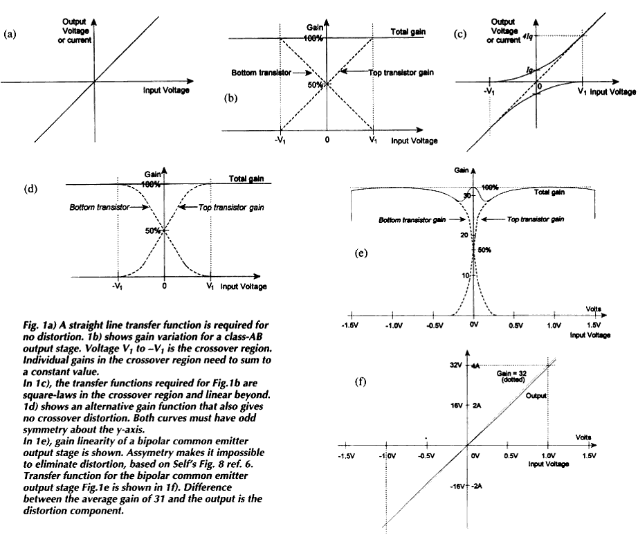

Hi Nelson,
Maybe you recall Ian Hegglun's D2S article which was discussed here and which cites an article by M.Williams, "Making a Linear Difference to Square-Law FETs", EW+WW, Jan. 94, p. 84
See also attached figure from the Hegglun article. Key point is fig 1c, note the bias current is 1/4 of the total class A current as the main design criterion. When the devices go to linear gain instead of quadratic at just that point, class-B operation is possible. Of course all that is the simplified view, real FETs won't behave this ideal etc etc. IIRC, PMA wrote he tried the original Hegglun concept(s) and ran into issues.
- Klaus
- Klaus
There is no doubt that we can get very good linearity. If you would
care to drop the "perfect", we would be in agreement.
