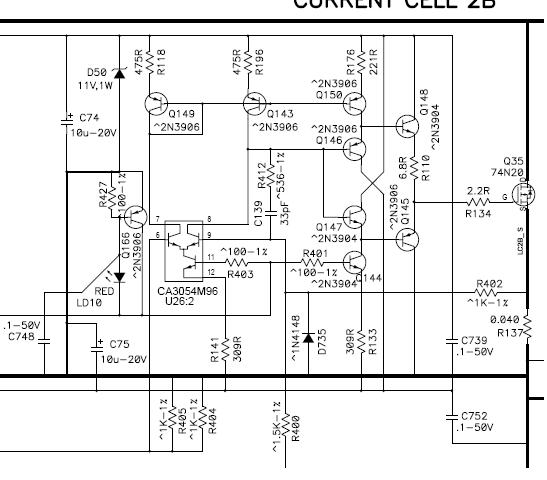

lumanauw said:
This one is from here
http://www.diyaudio.com/forums/showthread.php?postid=1141588#post1141588
Q1+Q2+D1+D2 seems to form correction loop
The output stage works in fact as a regular negative feedback loop, being the noninverting input at Q1-Q2 emitter junction and D1-D2 junction (output) the inverting input.
An interesting feature is the potentially large bandwidth (non inverting) resulting from Q1/Q2 working common base. Probably this circuit could benefit from an additional overall negative feedback loop, setting the inner OpAmp feedback so as to have a moderately high gain (10 - 100 times amplifier set gain).
Drawbacks are low output stage input impedance toghether with unity gain, which places severe drive requirements for the OpAmp.
As Bob noted, matching of D1-D2 V/I curve with Q1-Q2 Vbe/Ie curve may be tricky.
---Correction--- There is no possible match since Q1-Q2 Ie is basically constant while D1-D2 see the load current.
Rodolfo
This looks like a mini-CFA follower inside the overall op-amp loop. Those 1.5mA currents end up driving the MOSFET capacitances in one direction or other, could be a problem as a general purpose technique (ie. if the FETs have 1000pF of Cgs).
EDIT - Sorry just noticed the loop isn't closed around the whole thing - still have to slew those MOSFET gates.
