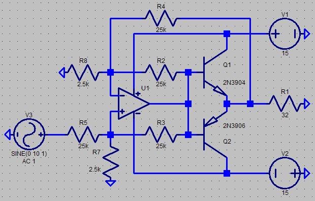

If you can find a differential amplifier that gives some degree of access to the inputs of the internal opamp, like LT1991 (but hopefully faster), then the common mode is no problem. See attached, values are fairly arbitrary, just a topological example. R8 and R7 reduce common mode to very managable values, with the tradeoff of increased noise gain, thus lower bandwidth.
Now the common mode is dealt with, this circuit is still limited by the ouput voltage of the IC, this can be solved with a simple discrete gain stage (gain of ~2-10) between the output of the IC and the junction of R2 and R3.
P.S. The matching of R7 to R5 and R3 and the matching of R8 to R2 and R4 is as important as the rest of the matching, so something like the LT1991 with multiple trimmed resistors is needed. Something advertised as selectable gain.
