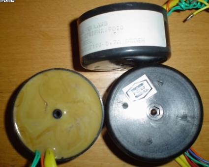

I used to buy fancy new block type transformers to serve time as voltage boosters for the front end of both BJT and MOSFET amps.
Nowadays i buy stuff like NOS resin filled telephone transformers for $0.50-$1 the piece to do the job.

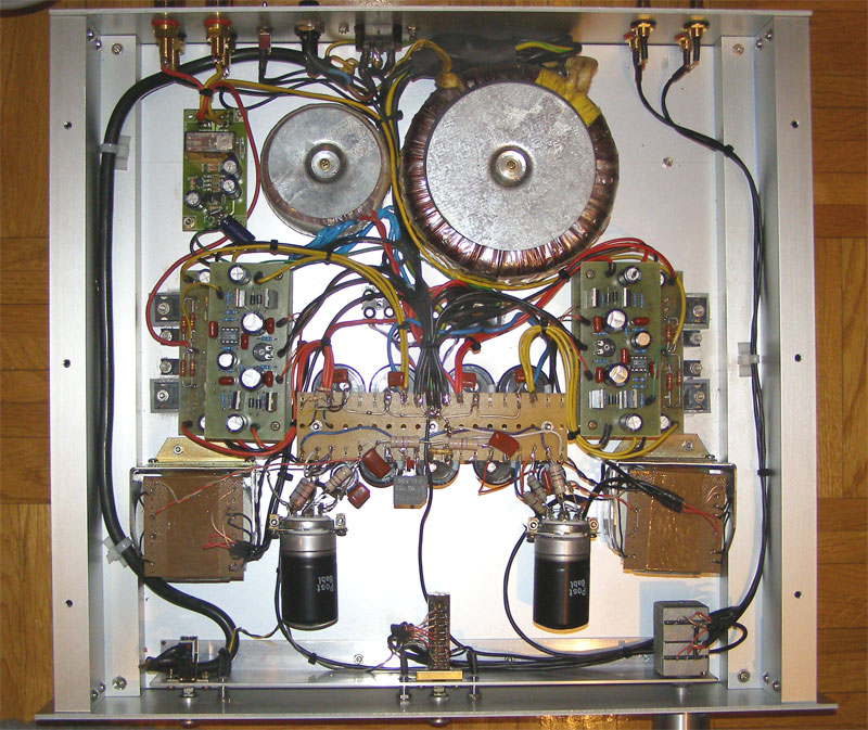

In the meantime, I have managed to bring my Academia project to completion and am now happily enjoying the fruits of my labor. As I said in an earlier post, Academia is a hybrid amplifier that consists of a tube driver input stage and your error correction output stage. The pictures below show the finalized version. I am planning to publish more details and measurements presently, on my personal website. So far, my listening impressions have been very positive. The amplifier is dead silent, with no thumps, hum, background noise or audible oscillation. It is very natural-sounding, with a soundstage which is airy, open, well-defined and strikingly detailed. In short, I am enjoying it very much. Thank you.

What a beutiful piece of work! I wish I could build amplifiers that are as pleasing to look at! Tell us more about the design. Thanks fo the pics!
Bob
Thanks guys for such positive feedback. I have to share the credit for my more recent chassis designs with my wife, who is my sternest critic and my greatest supporter.
As for more details about the topology, I still have to do all the measurements and experiment a bit more with different parts brands and tube connections to see what the maximum I can get out of the amplifier really is. There is no "prior art" for it so I am pretty much left to my own devices to figure things out and conclusively determine what may work best. These things take time so please bear with me. Once I am ready, I will publish the findings on my personal website.
Anyway, I hope my project would encourage other DIYers to show off their implementations of the error correction circuit and share their experience.
