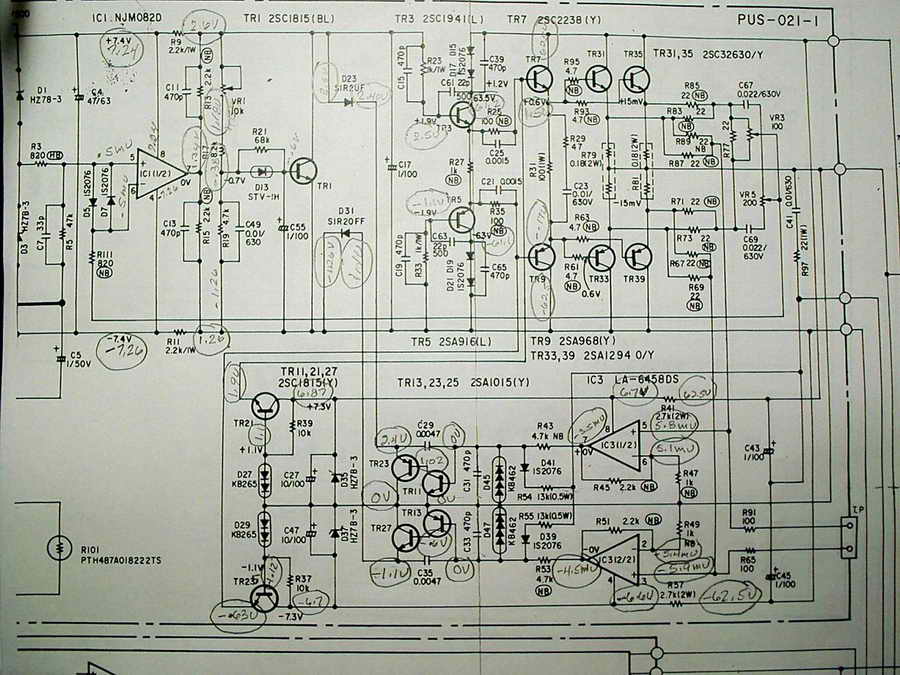

The overall gain is determined by differential input TR500-TR501, voltage divider R510-513/R507=45x.
IC501 is only buffer follower.
Interesting is input to IC502. To pin 3 (non inverting input), there are 3 sources, from R545(20k), from C526+R545, and from C528+R550. The gain is R547/R551, but the output is only AC connected to the main CCT, because there are C528 and C529 (0.1).
Is IC502 forming somekind of EC for high frequencies (because after IC501 everything is only follower)?
This is getting more confusing 😀
This is from Denon POA1500. The opamps are comparing drop at RE (0.18ohm)? Is it a limiter here?
