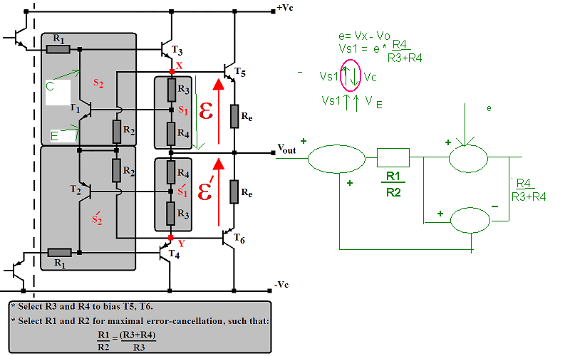

Hi Mikeks! Below picture says my thought. What do you think of it ?
Can we calculate distortion of T1 ?
I tried to simulate Error Correction schematic. Sim show that distortion still quite hight. Is THD of EC still high ? Are You, tradebarm, AndyC, powerbecker, gootee trying optimize more EC ?
thanks!
