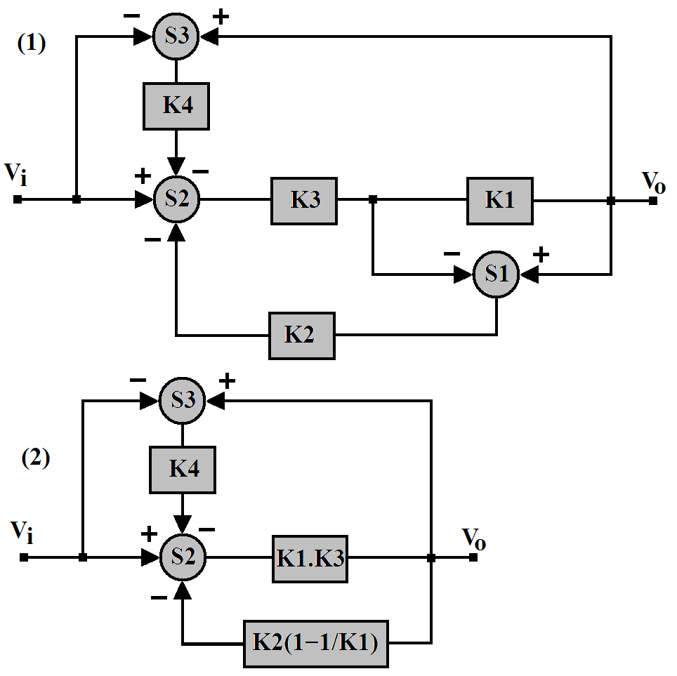

Hawksford suggests, on page 3 here, that the sensitivity of the error cancellation loop might be sensitive to ''alignment errors'', and proposes the introduction of yet another loop to ameliorate this sensitivity.
For continuity, this introduced below as summer S3 in a modification of the block diagrams previously discussed.

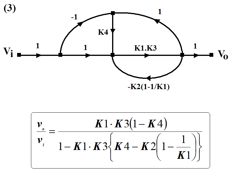

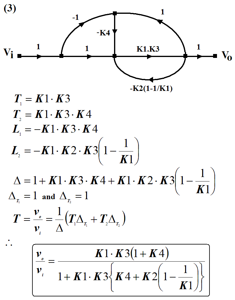

Continuing from here, the posted figure in that post is in error.
The corrected version is given below.
Noting that at balance |K2| and |K3| here (from this post) must be unity for error cancellation, it becomes evident from the transfer function below that the value of K4 is irrelevant, as this transfer function being equal to unity only depends on |K2|=|K3|=1
Continuing from here.
Hawksford then appears to demonstrate (pg. 4 & 5 here) that sensitivity to ''alignment errors'' is reduced by the factor 1/(1+K4).
Note that Hawksford over-simplifies his analysis by assuming an ideal input summer. This, however, may not necessarily invalidate his conclusions.
It is also noteworthy that in the process (equation 2.2) Hawksford invokes Cordell by ''decomposing'' K1 into an ideal block of unity gain plus an added error component ''Ae'', contrary to Traderbam's bizarre objections here.
Since it is clear from this analysis that the value of K4 has no bearing on the transfer function at balance, then the gain of summer S3 here can be assigned an arbitrary value.

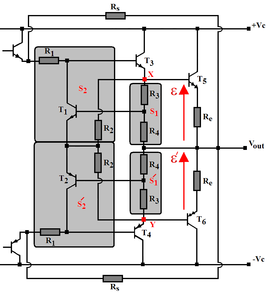

This is done in Hawksford (fig. 5-1) by merely connecting a resistor Rs from the output of the power stage to the input of the error-cancellation loop, as shown below.

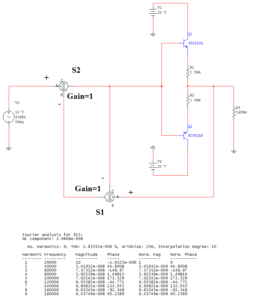

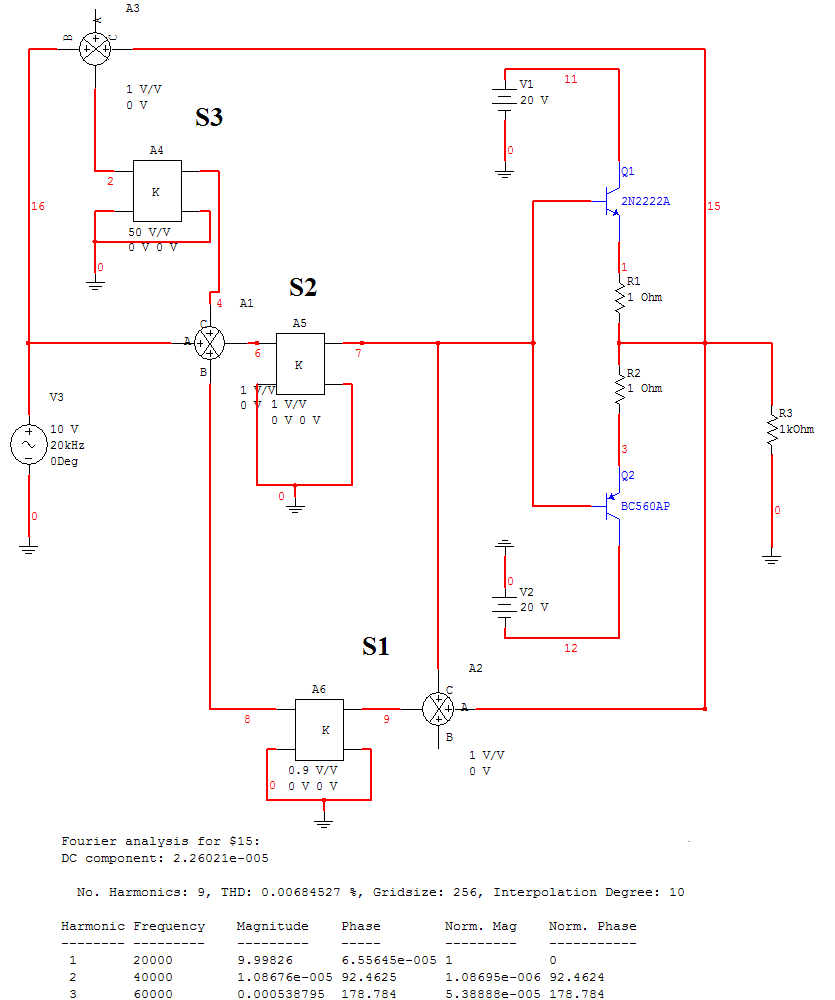

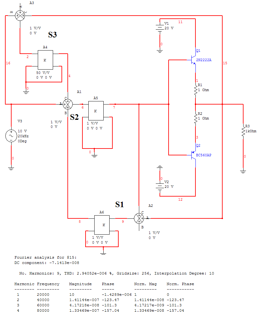

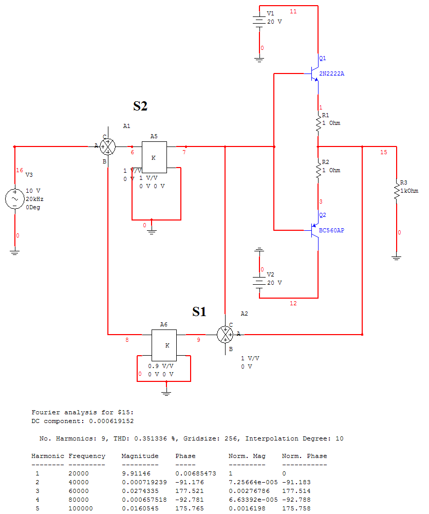

Reducing K4 from 50 to unity (with the same misalignment of 10% in the gain of summer S1) causes THD to increase by a significant amount, to 0.17%.
Thus, although the magnitude of K4 has no effect at balance, when such an imbalance exists, then it desirable that K4 be made as large as possible to desensitize the loop to the error.
Indeed, increasing the gain of K4 to 1K reduced THD (with a misalignment of 10% in the gain of summer S1) to just 0.00035%.
These results seem to confirm Hawksford's findings, and, on this basis, the circuit modification above is recommended.
Nevertheless, whether these results are replicated in practice remains to be seen.
Discuss.
