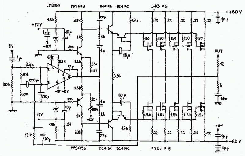

lumanauw said:Hi, Janneman,
May I add another one? How about a non-global feedback power amp, but have Hawksford EC in output stage (Like Steven's).
How does this compare to global feedback power amp+Hawksford EC (like Bob Cordell's)?
This is Steven's design :
http://www.diyaudio.com/forums/showthread.php?postid=330446#post330446
For those who prefer no global negative feedback, but who are OK with agressive local feedback, an amplifier using Hawksford EC without global feedback would make sense, at least in some sort of way. As I speculated in an earlier post, a cynical manufacturer could build such an amplifier with very good performance and advertize it as a no-feedback design, glossing over the local feedback that the EC actually represents. He could even advertize it as no-feedback with error correction, privately assering that EC is not negative feedback.

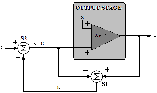

mikeks said:Folks, i think Hawksford (and Cordell) were preceded by Mr Henri Pichal as far back (at least!) as 1972!
Mike, I think not, but I could be wrong. Look at the circuit closely. Where is the positive feedback? There is none, as far as I can see. I'm not even sure this scheme works as advertized.

Bob Cordell said:Mike, I think not, but I could be wrong. Look at the circuit closely. Where is the positive feedback? There is none, as far as I can see. I'm not even sure this scheme works as advertized.
Maybe brian has an opinion on this circuit.
As far as I can see there is positive feedback in the same way as for Hawksford. Since the amp to be corrected is inverting in this case the resistive summing node actually performs a subtraction to get the error, which is then inverted and fed to the postivie input, which once again means a subtraction, since the source is fed to the inverting input. Maybe I overlook something, but it seems to me to be identical, on the block level, to the model of Hawksfords ec used earlier in the thread.
mikeks said:Hi folks.
I am trying and failing to see any positive feedback here:
I think it was Traderbam who posted an equivalent diagram, where the feedback loop was replaced by two separate loops, one positive and one negative, by not subtracting the signals at S1 before feeding them back. That is equivalent, of course, on the block level of abstraction.
I think it may be deceptive to talk about the positive feedback loop in isolation, though, since it only exists simultaneously with another negative feedback loop, and they work together to define the system. Of course, block-level equivalences are not necessarily preserved when taking into account all further details in a real implementation, and I am not so sure it is wise to wiev the system as two separate loops in this way, instead of one loop as in mikeks diagram.
janneman said:Mike,
S1 bootstraps its own (left-hand side) input; that's pos feedback, no?
Jan
S1 is a differential amplifier. It could be a single transistor, making it an unbalanced diff. amp., as in Hawksford, or it could be a full blown emitter-coupled pair, as in Yokoyama.
No positive-feedback-by-design involved.
mikeks said:
Hi Bob,
I am not sure, but are you suggesting the presence of a positive feedback loop in your design?
Actually, i was referring to the claims made in his abstract.
Yes, if look at it correctly, you can always find a positive feedback loop in the Hawksford EC scheme. Brian has been correctly pointing this out.
