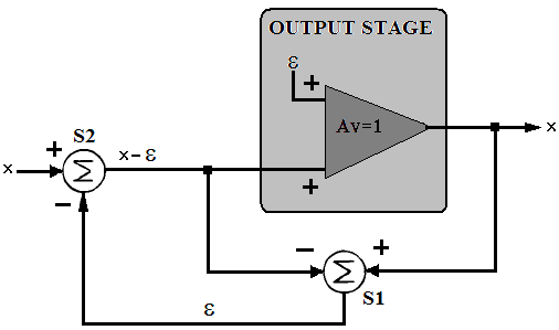

Interestingly, global error correction schemes seem less vulnerable with respect to loss of transconductance at crossover, since they are not dependent on open loop gain (including output stage), but on the summing node performance.
Janemann's insight comes to mind here, when he (re) christened EC as "feedback on demand".
Of course I endorse your tennet that "devil is in the details" anyway, when confronted with an actual implementation.

From the figure below it becomes clear that exact error cancellation is accomplished in principal by merely introducing error at the power stage's input (summed, of course, with the desired stimulus X) of the same magnitude but of opposite phase to that generated by the output stage.
